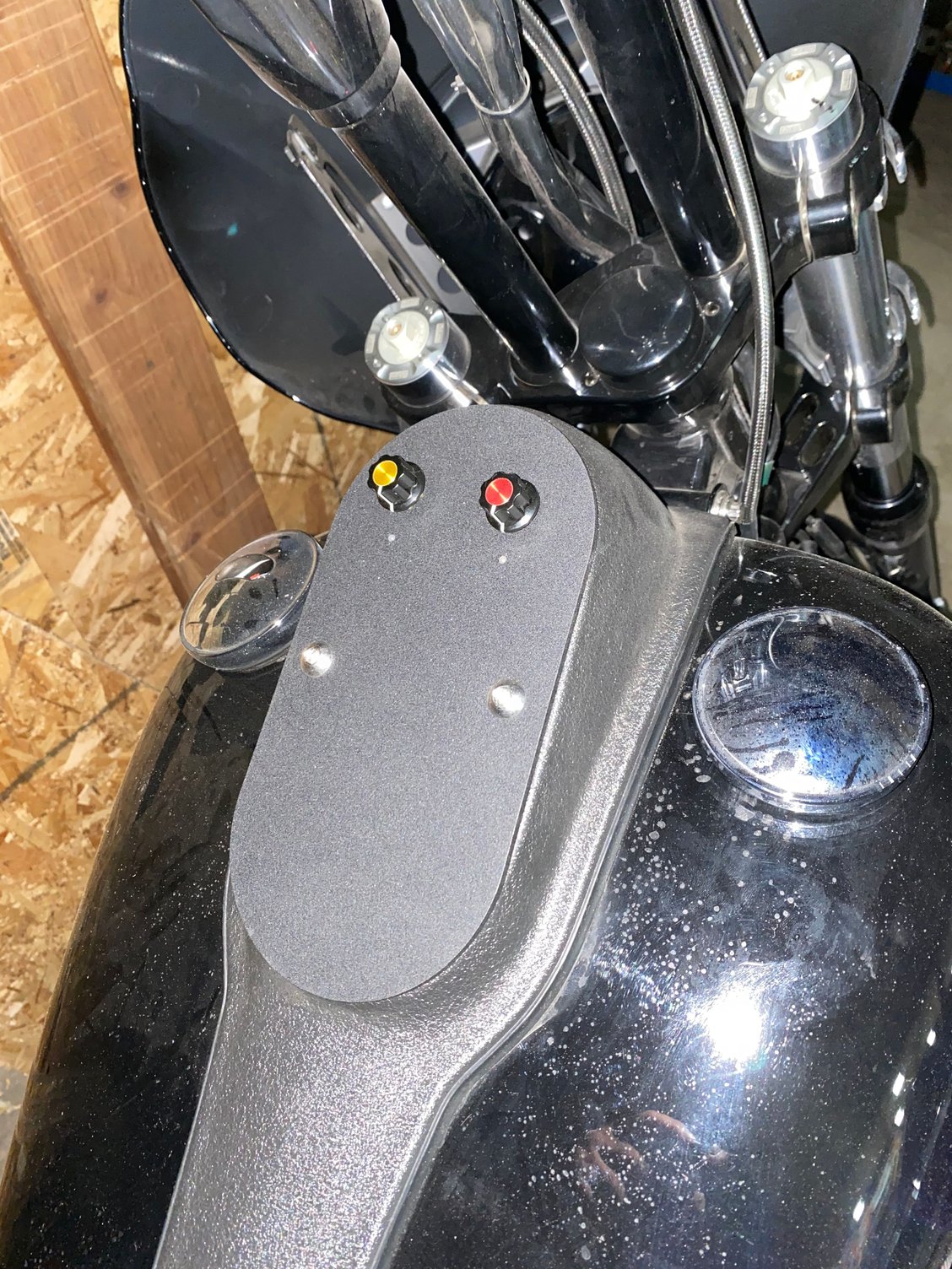

Haven't updated the thread lately so....
I put in Warm and Safe heated gear controls in March:
