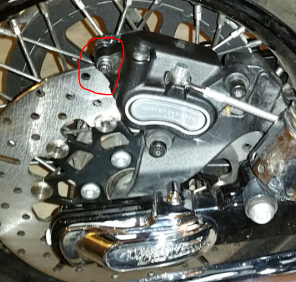

After removing old exhaust prepping for install of new I noticed rear brakes should be replaced. I get a set of new pads and when I start to remove caliper and pad pin I realized I do not have the "socket" required to remove the pad pin. What style and size of socket is this? It is not a normal 12pt bolt.
Sitting on my thumbs now. Thanks in advance.

not sure what bike you have but 1/4 12pt on a wrench works fine on my 2012

Yep, 12 point 1/4" for my 2012 switchback. This size was recommended by a dealer tech. Be sure to check your old pin, mine was quite worn. Some pad kits include a new pin, I ordered mine separate.
