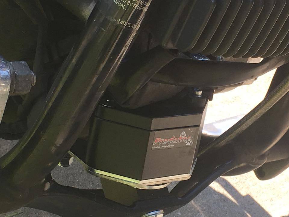

Originally Posted by cycler
If Im not mistaken the Predator front motor mount pushes the engine forward a bit. Which is why you had a issue with the CCE rear motor mount.
The Predator doesn't move the motor at all...I jacked the motor up a little bit, unbolted the OEM mount, Bolted the Predator in, set the motor back down and finished bolting it down.
Check the alignment and go for a ride, The whole install took about 30 minutes.

John CC's Avatar
John CC
Joined: Aug 2018
Posts: 3,065
Likes: 1,224
From: New Hampsha
When you install the Predator it sort of assumes the engine is in the right place and adjusts itself to that position. When I did mine, I replaced the rear first. My front mount was completely collapsed and the engine was about 1/4" back from where it belonged.* Had I done the front first, I would have locked the Predator down in the wrong position and then the rear mount wouldn't have lined up correctly.
Don't know if I would have been smart enough to go back and correct it...
*This is why shimming the front mount is so tempting, and why it is just lipstick on a bulldog.
