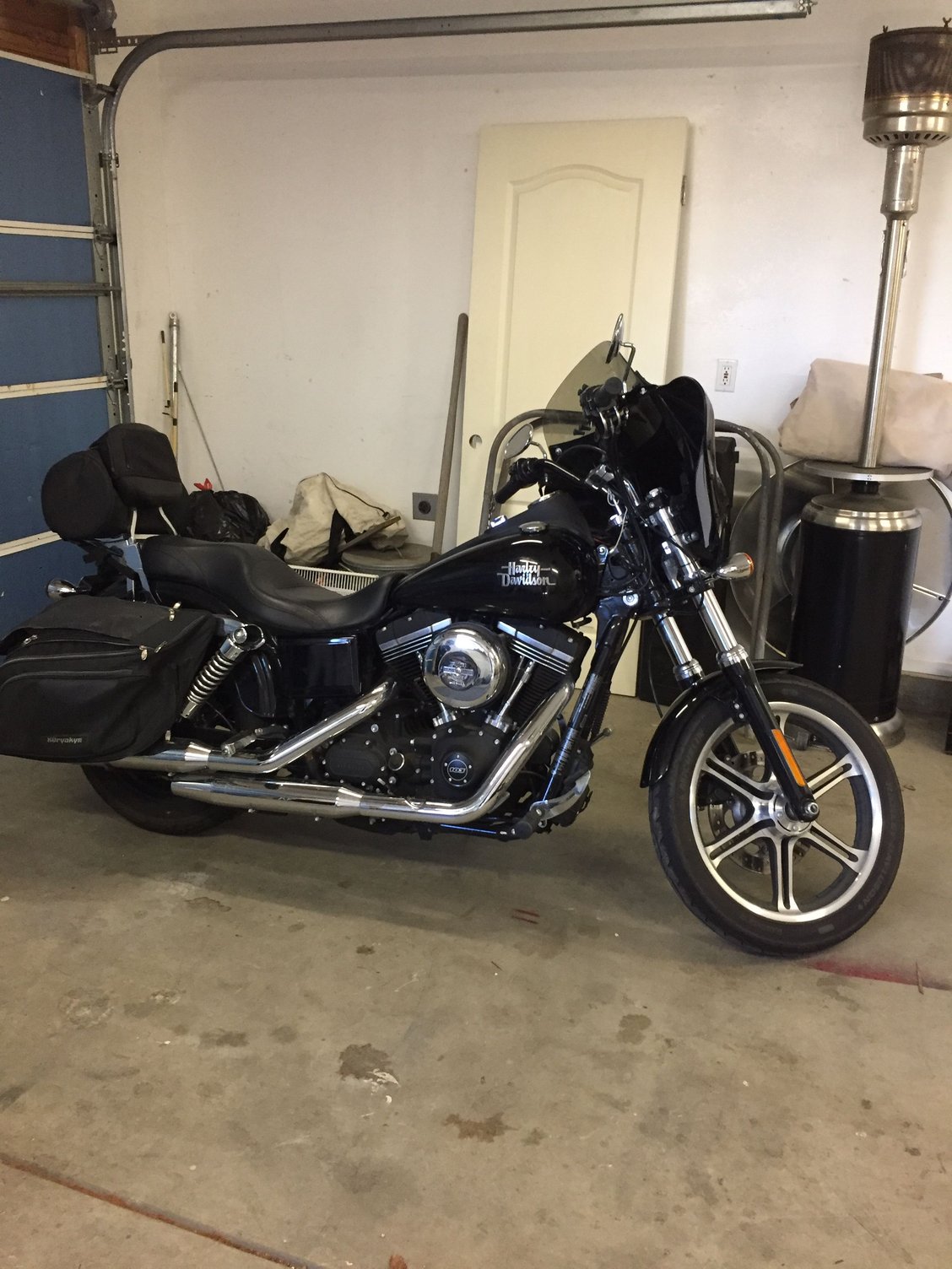

I have a 2015 FXDB with the stock exhaust and I’m ready to make the exhaust switch now for more power. I almost bought a Basini 2 into 1 system but I saw an article about fitting and O2 sensor issues that left me thinking Slip Ons might be a better choice for me. My question is will I get comparable performance out of Slip Ons?
I know I’ll need to remap my EFI as I’m looking to get more hp out of this dog, love the torque!
