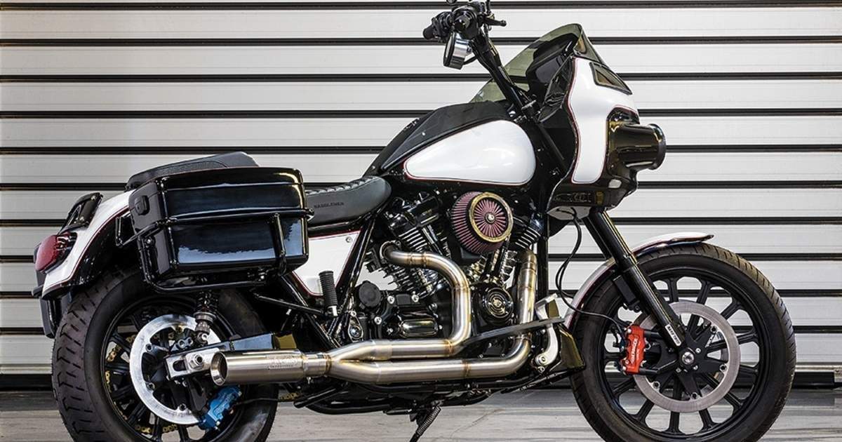

Jeff Holts M8 FXR with Leading Edge 151” kit

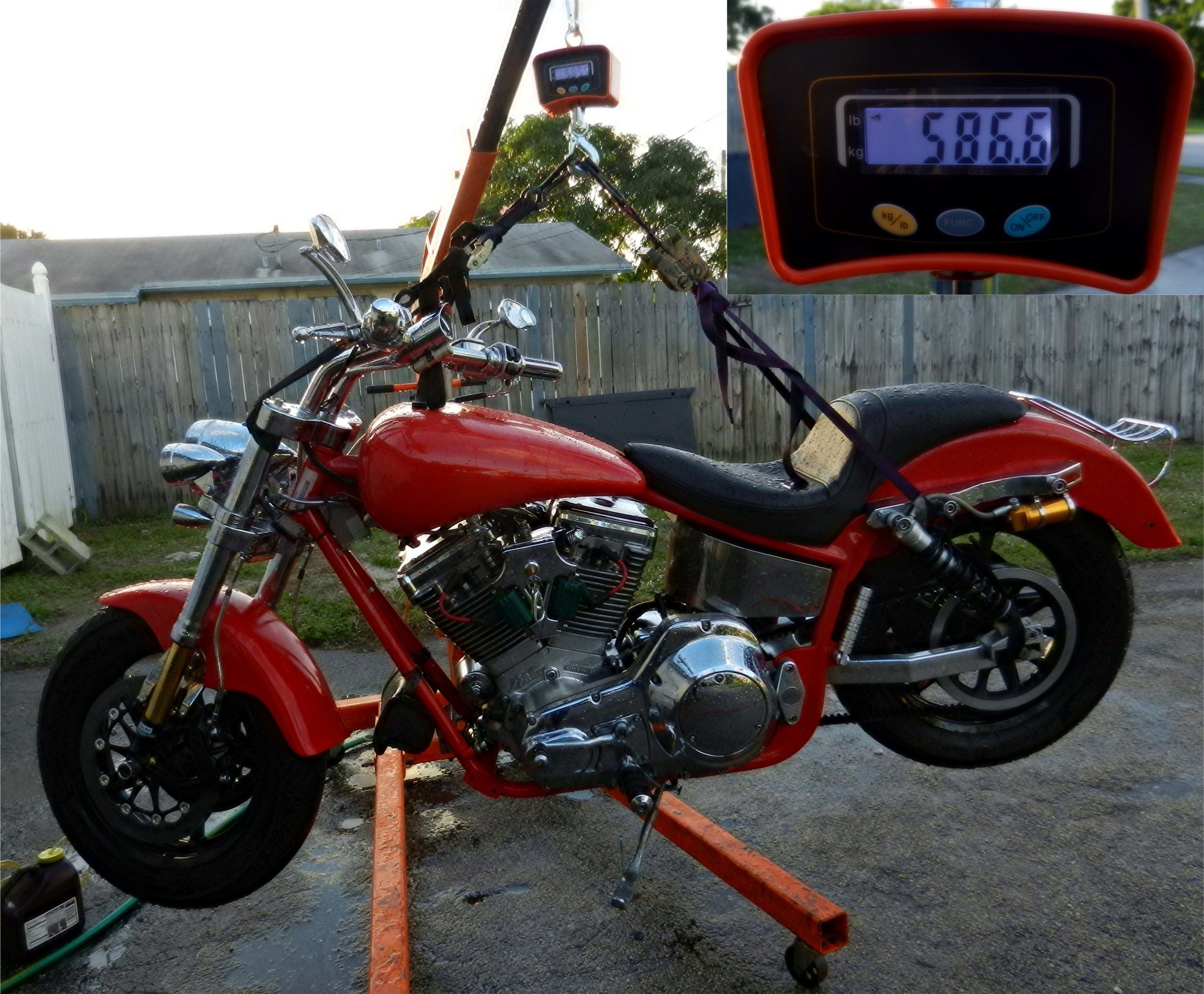

I really liked the ride of a FXR but I chose when purchasing a new HD in 1984 near the end. I decided on a softail which changed from a Shovel to a Evo. I picked up a Softail Super Custom and only 2 colors were made of that model, red & blue. That was another story. Always liked the ride of the FXR and in 2005 I decided to build one. I started with Chrome Molly tubing and made a frame jig. I picked up a Rev-Tech 100ci and the first of many bikes came out of the same bike. I wanted lighter and I also purchased a new 113ci Total Performance (TP) and slipped in a 6 speed with 8.6 final. In 2005 I went to BST and had several sets of C/F wheels made, this is their first 17" wheels for A HD. A custom built inverted forks w/30mm Ohlins cartridges and my wide glide triple trees went on & this is what I ended up with. It is full of 4.6 gals for fuel & oil. I use this bike for high speed highway use and has heavy (20#) each tires. This is my daily driver (when I actually have the time to ride). Extremely comfortable & solid at all speeds I ever took it to.

That's really cool, Howard. Thanks for sharing!
I'm still light-weighting my Dyna but it's down to 568 pounds with full fuel and oil. I have plans in place to get another 10-15 pounds out of her *** end.
It's not as well dressed as your FXR, tho.
