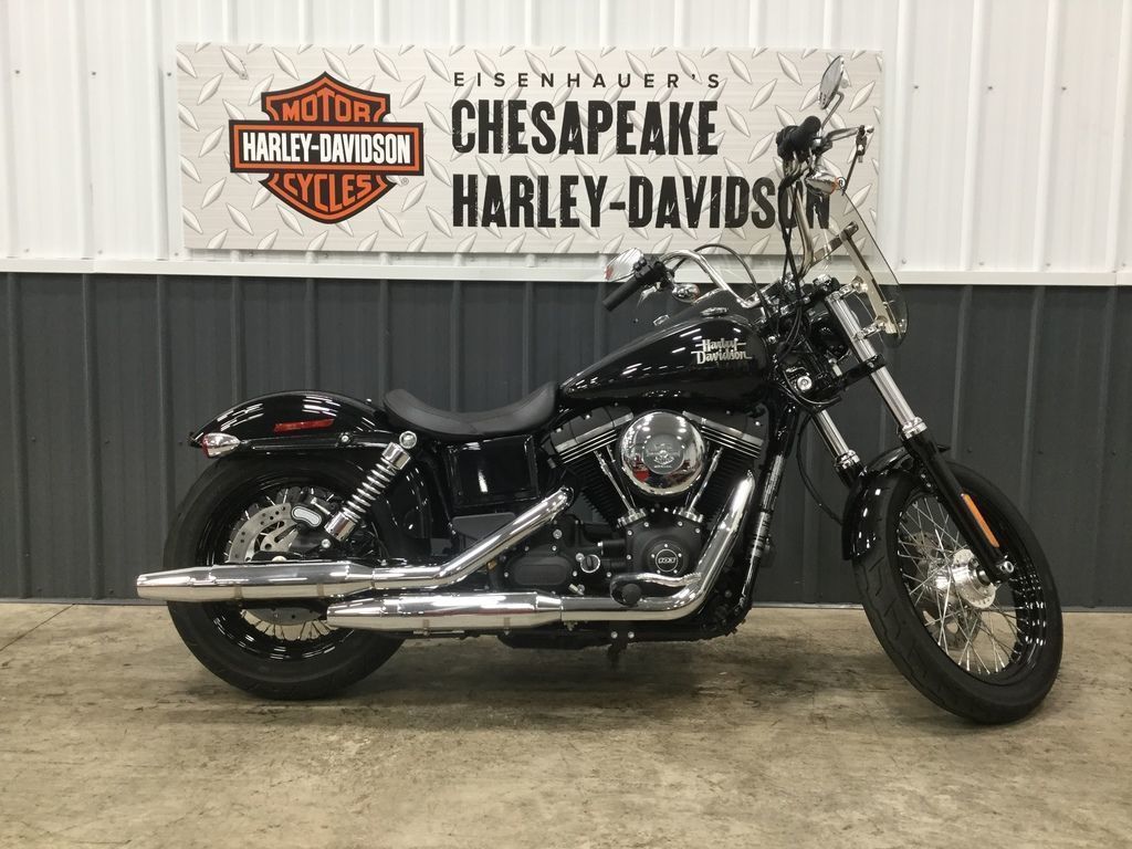

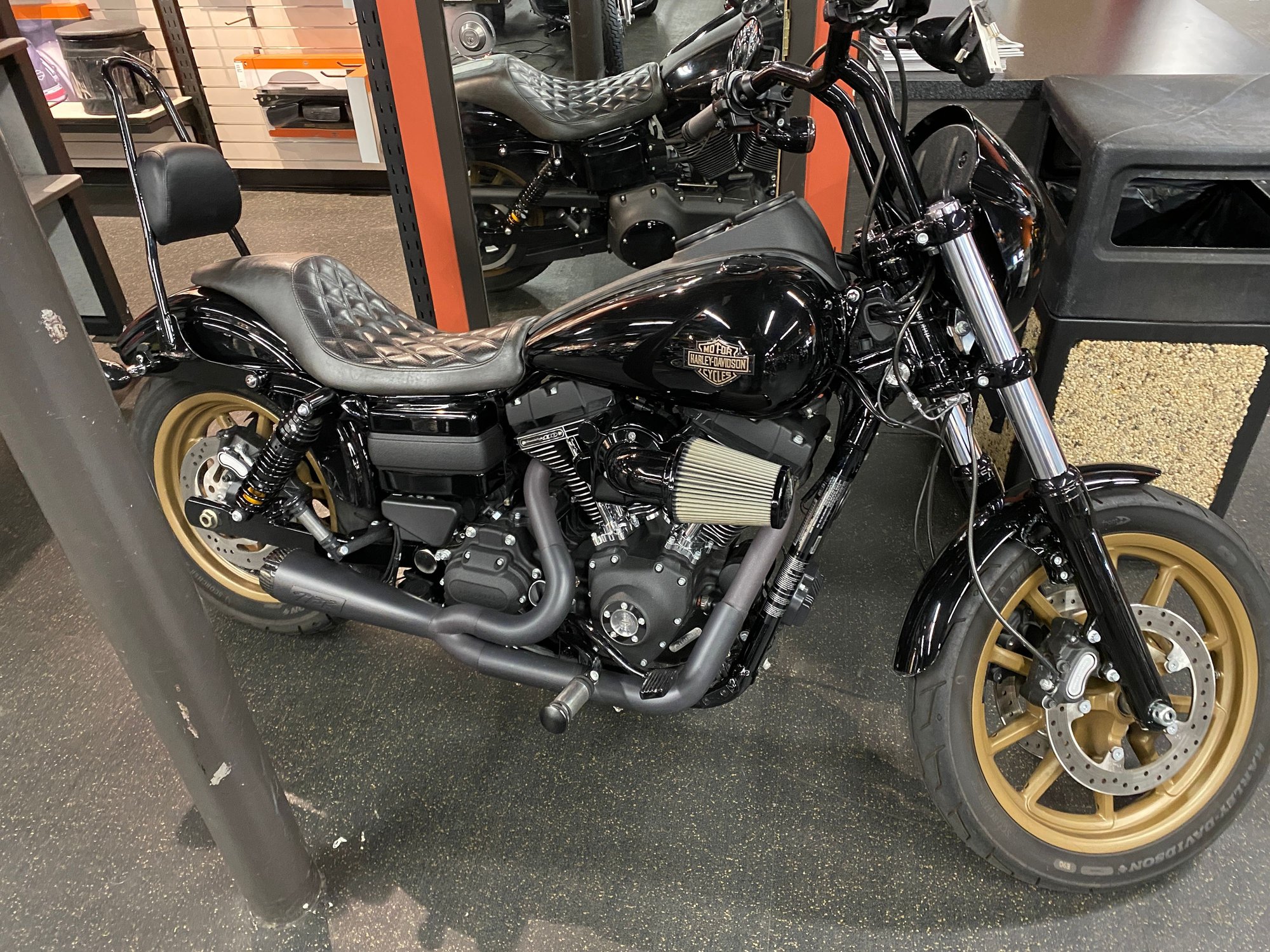

This is the LRS:
And this is the street bob
The LRS has a lot going for it, and were I planning to get rid of my Softail LRS that would be the way to go for sure. However that's not my plan, and the SB may be the better blank canvas to play with.

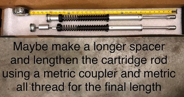

Default Make a spacer ??
The photo above is a pair Rushmore FKC-102 cartridges

Mr. Howard’s cartridge rework service coupled with his ability to provide custom trees for a better handling build may be an avenue to explore especially if you’re considering using a blank canvas.
