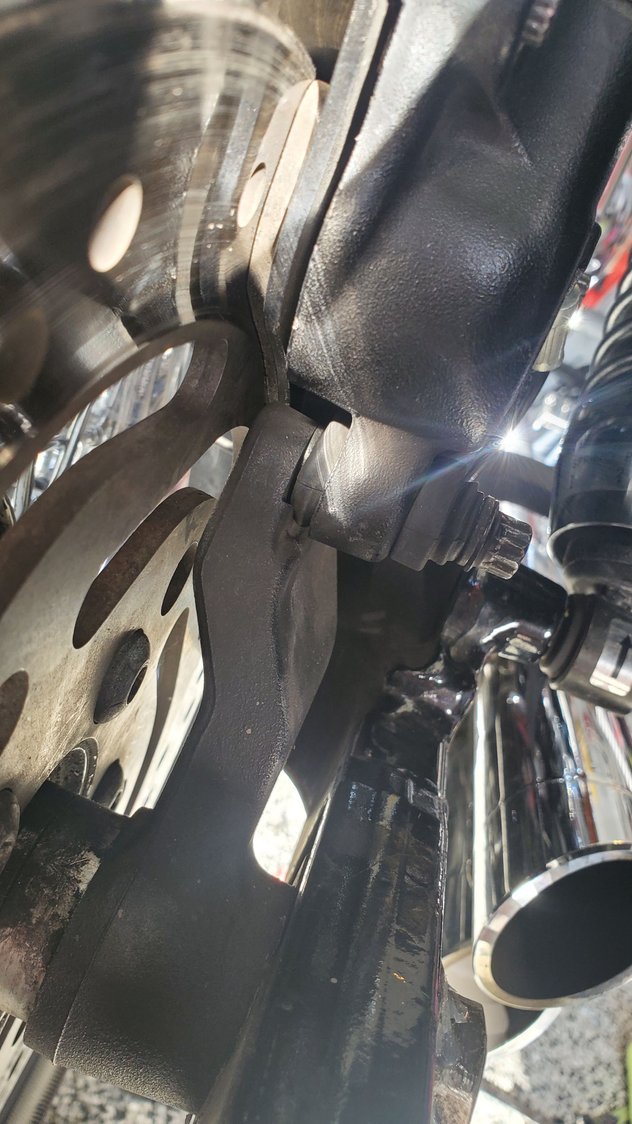

My rear caliper is moving up and down about a quarter inch. Is this normal? I can hear it rattle when I hit bumps. I have tried to tighten everything but still moves. Just had rear tire replace as well.

Year and model of the motorcycle would be useful so you can look up the parts on the caliper. There is a rubber piece on some models that fit into a slot, you may want to check that. Verify with a parts diagram from Roni's HD or similar.
Did you put everything back together IAW the HD Service Manual?

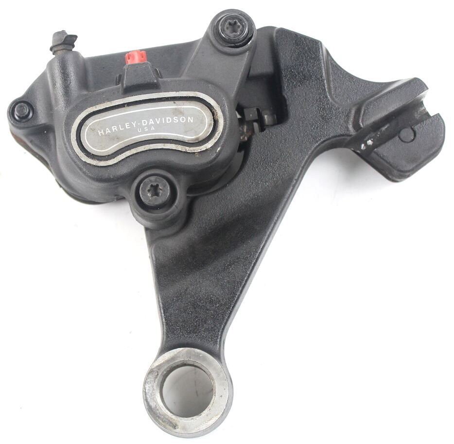

Originally Posted by WS6 Formula
Are you missing the rubber bushing?

​​​​​​It's a 2008 wide glide. Where that lower bolt is is tight but will still move up and down and rattles over bumps.
mine looks different.

Might just be a worn bushing.

Pull the bolt and see where the slop is! Wouldn't be the 1st time I've heard of a tech not putting the sleeve back in!

Here is a link to your parts catalog and a couple of screen shots. Make sure all the parts are there like #10 & #13 as stated above by WS6.
