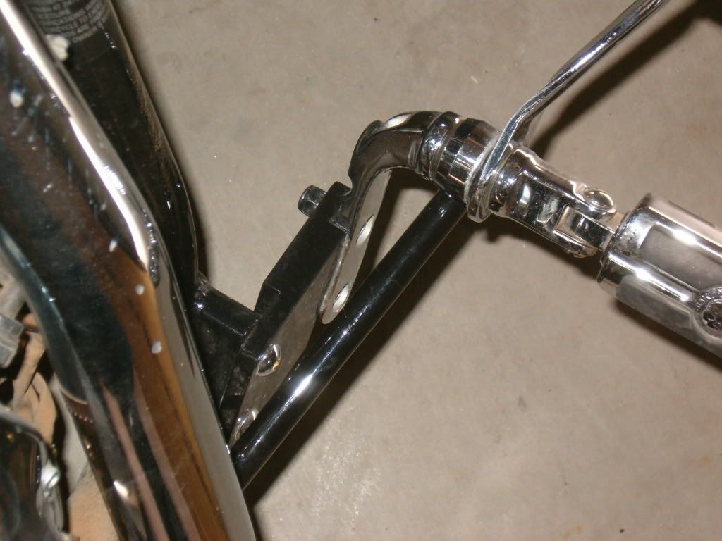

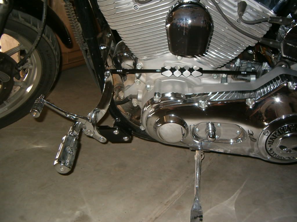

Here is another way to move them forward for your consideration. This was much cheaper. Moves the pegs two inches further away. The brake and shifter stay where they would normally sit.
