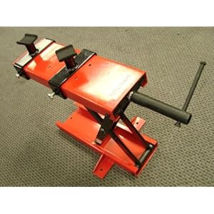

After looking at this post I went out to the garage and looked over my HF lift, then moved my lift bars out 1 1/2 to the outside giving myself 3 more inches of stability making the RK teeter less when It's up....thanks dude for the pointer....Ingenious to say the least.
thanks I got it now.

Ok, I just read every post in this thread and my head is a little fuzzy. I have a stock 03 Dyna LR. I just bought the yellow HF lift. Can anyone confirm that moving the lifting pads to the outside will work for my bike.
This is a great thread. Thanks,
chuck
chuck
It is a Dyna, yes it will work.

as much as i dig the lift mod, for those of us that dont have the money for that lift, some of you might like this lift. for a low rider, i cant use the frame blocks, but i prefer it that way.
http://amzn.com/B003BVYXFI
I can use this for any maintenance imaginable on the scoot, and it was less than 75 bucks shipped.

In case anyone is interested, Sears has these red jacks on sale for $89.99 this weekend.
