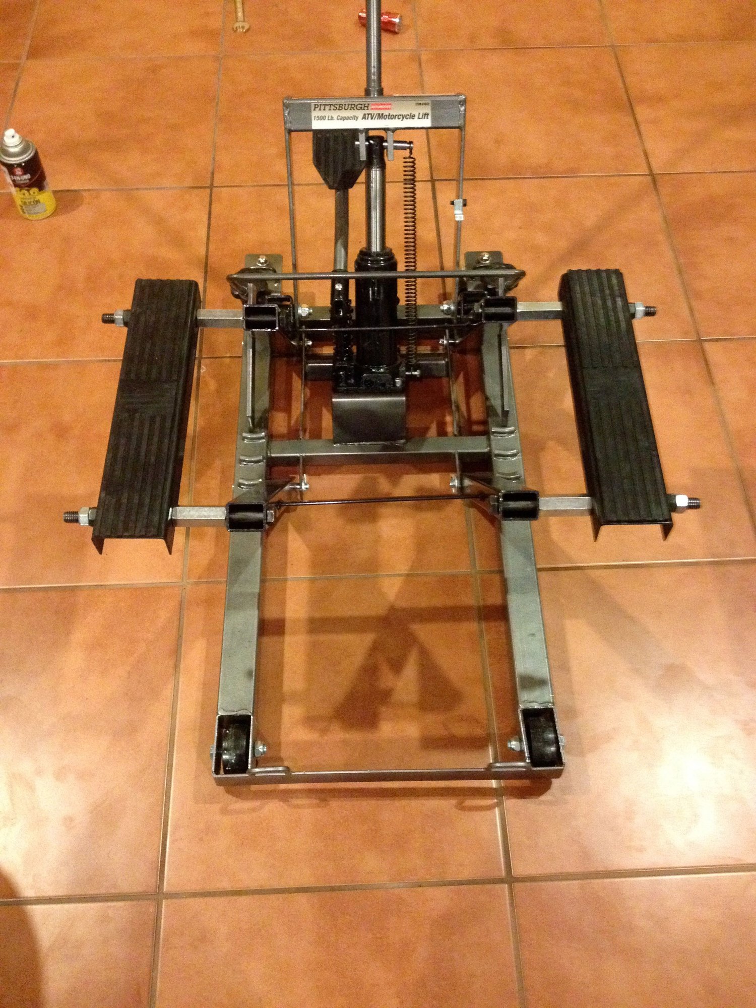

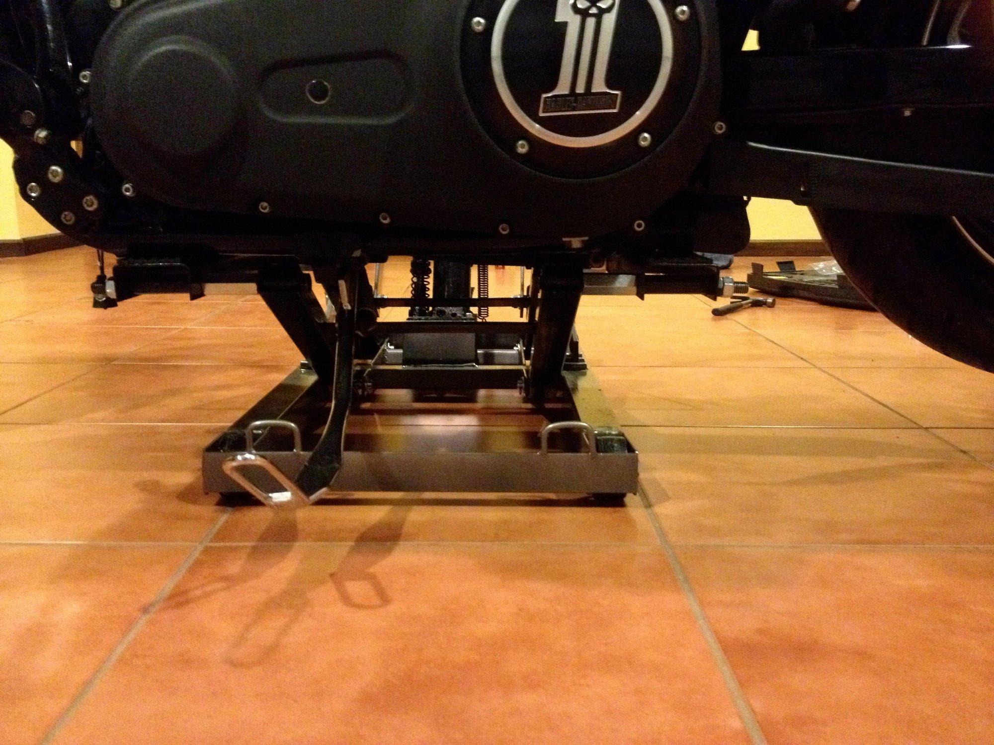

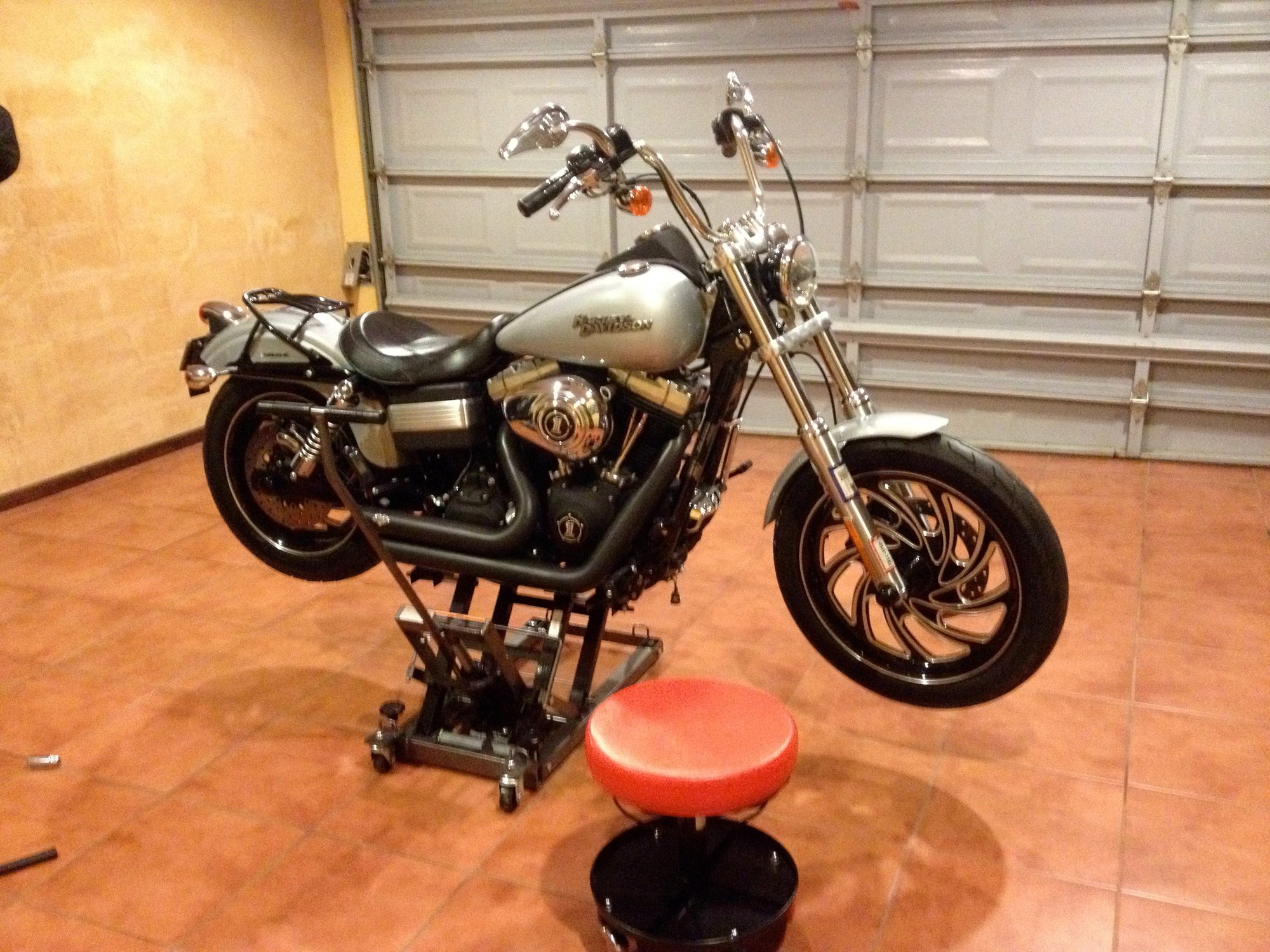

I put 8 inch bolts (grade 8) and 2 inch spacers on my Pittsburgh Jack, because I need more width on the Dyna Street Bob 2011. Don´t need any piece of wood or anything else to lift it, just put the jack under the bike and then lift it, very stable.
Thanks for the idea, just make some adjustment and this works perfect for my Bob.
Edwin, Costa Rica.

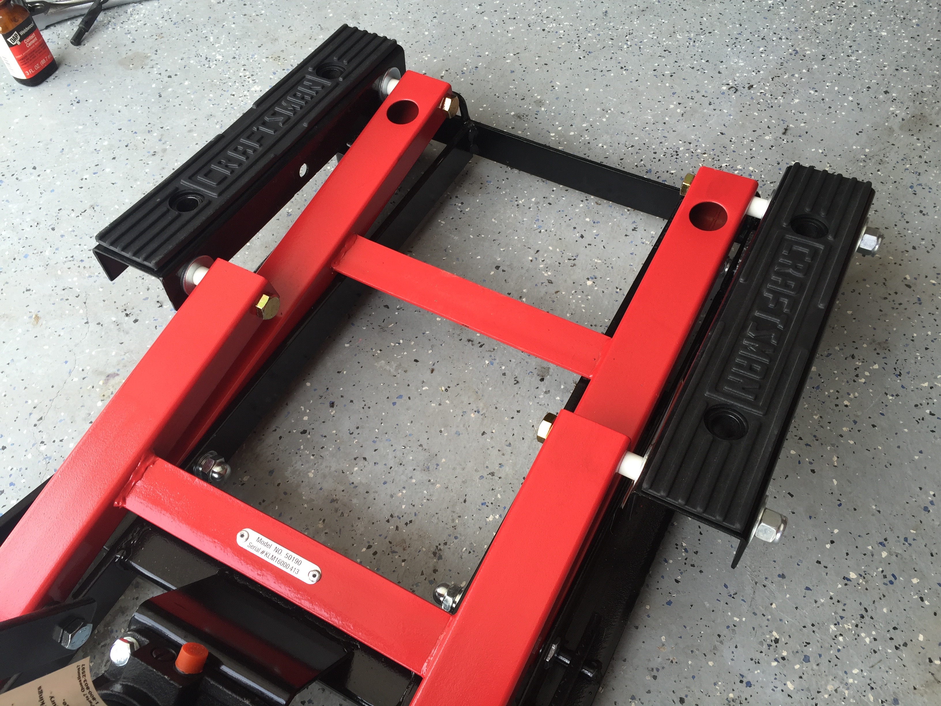

I did this mod today - and the jack fits my '08 Fat Bob snugly but works.
FuzzyHead619's welded cross members are a sweet improvement. Alas, I don't have a welder.
I used Grade 8 6" bolts and 1/2" nylon spacers. Without the 1/2 spacers this would not clear the oil pan or the jiffy stand.
Thanks Vic for the great mod!
I got the jack on sale for $107 at Sears today, plus they were running a 5% coupon which took it down to around 101. With the Grade 8 hardware, my cost was $125 total with tax.
Ground down the "nubs" and shot it with some primer and rustoleum black.
