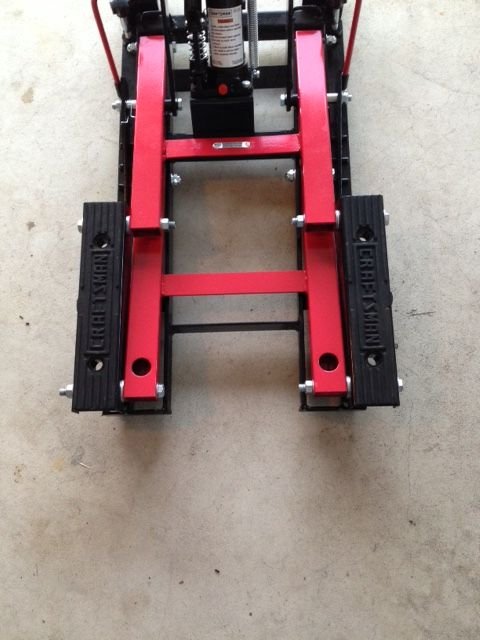

Default Smaller front wheels, anyone?
Thanks Vic for the greatest thing (thread) since sliced bread.
I've done the mod with 1/2" spacers, and it lifts my Fatty perfectly.
Now the question:
Has anyone found / used slightly smaller wheels on the front of the jack?
I'm a crummy 1/2" away from being able to use this jack, as is, on my old lady's lowered Sporty. The left pad is hitting the bottom rear of the frame just in front of the rear tire.
I've lowered the pads as much as humanly possible. I've put a little "bunk" on the forward side of the jack for the lock release bar with my grinder. That got me a whole inch. Now the bottom of the left pad is actually touching the front left wheel.
Now I know I can just run the bike up on a 1-by and problem solved, but I'm so close that my warped personality just won't let it go.......
Thanks in advance for the help. Several thousand minds are better than one.....
