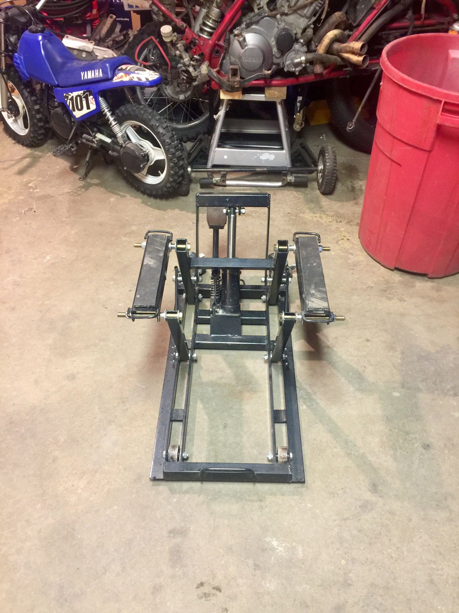

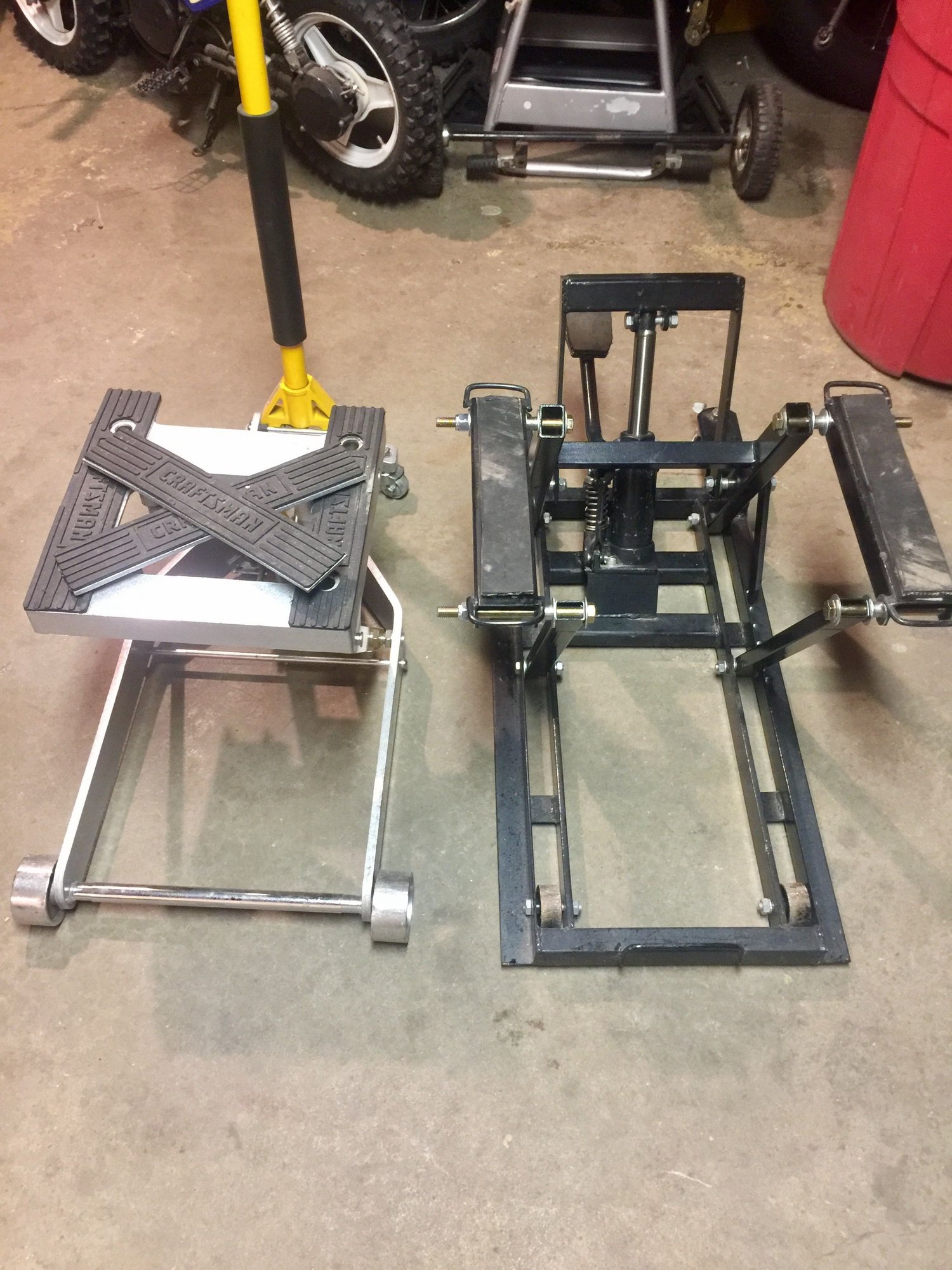

Old Feb 3, 2017 | 02:04 AM
  #690
Proline1969's Avatar
Proline1969
Joined: Aug 2016
Posts: 236
Likes: 184
From: Northern IL.
Finished modding up my " Black Jack " for now . Picked it up off CL for $25 , and about $10 for the hardware from Ace . I still have to add a brace and move the front bar back 3"-4" . But my nephew is borrowing it tomorrow to remove the wheels off his brand new Low Rider S and sending them to get powder coated . In the morning we'll find out how well it works on his bike . I'll be fabricating my other jack later
