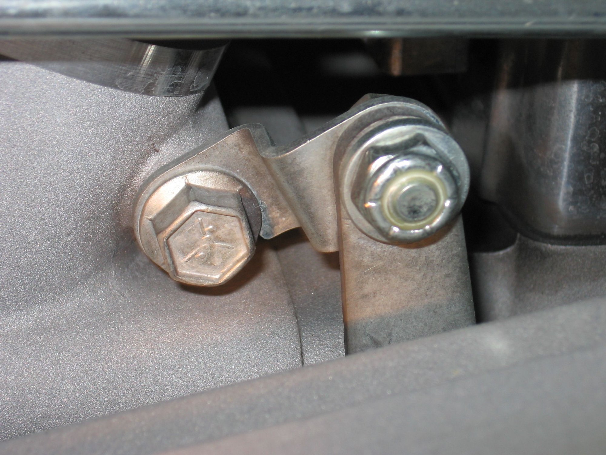

https://www.hdforums.com/forum/dyna-...ater-dyna.html
Look at picture 066 This is the clip I fabbed when I installed the floorboards on my Street Bob. Very simple: a small bracket with a v notch attached to one of the primary bolts. Back end is a bolt, spacer through the shifter spline hole attached to the new bracket. Black textured paint to match.

Here's the clip Keeg refers to in his post:
Here's the clip from the VTwin set:
And an image of the short (older) version from HD on my bike:
IMO it's not that hard to make one yourself...
