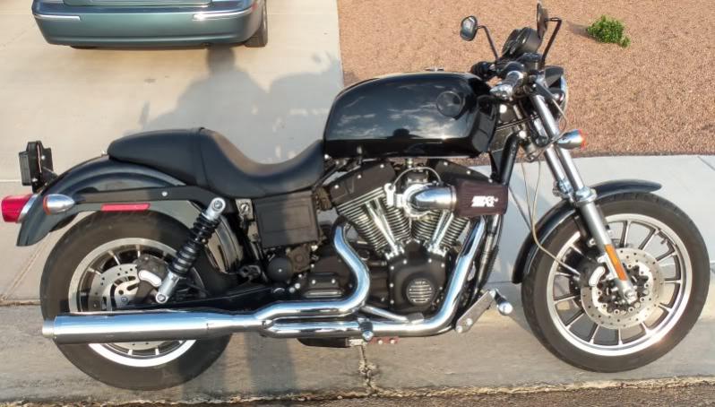

Thanks for the thread. I will use your experience to help me progress in my project: a 2004 FXDX Cafe.
Is that a BMW tank?
Old Mar 11, 2013 | 11:33 AM
  #840
DanDman's Avatar
DanDman
Posts: 1,465
Likes: 16
From: Nor Cal
Originally Posted by Danofxdx
Is that a BMW tank?
Maybe a old cb 350 tank?
