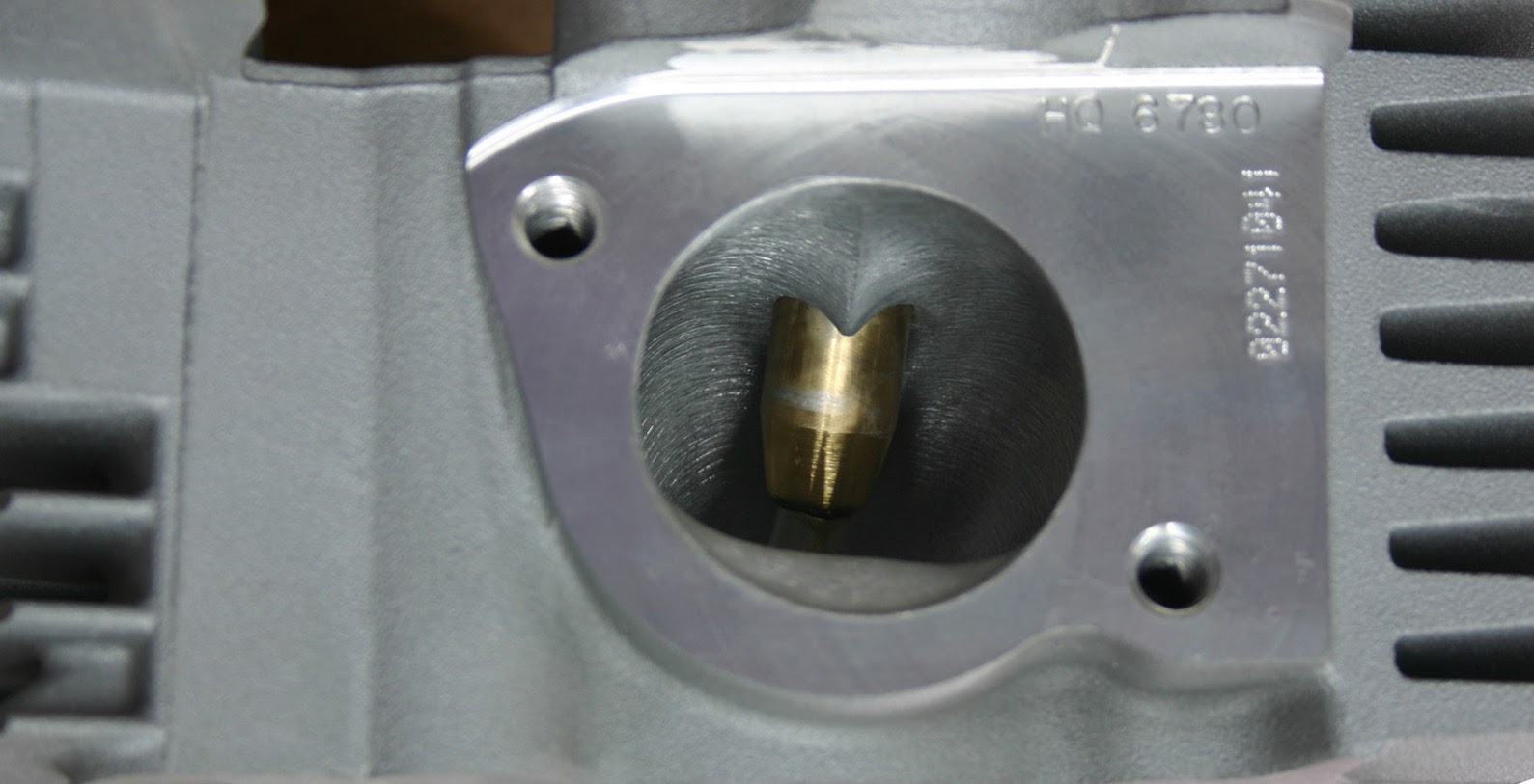

Originally Posted by mud
10.5 should give you a good kick in the pants.
picture above......
rough looking job, but should do the trick.
Really looking forward to twisting on it
I read a lot of threads on porting and a lot of the porters think that being a little rough there is actually a good thing - I have an aerospace degree but never really used it too much but I know on airplanes they will put strips and other little protrubences that disturb the air to keep it flowing tight to the wing and not separate and create a ton more drag. To the finger, it does not feel very rough, but I have only seen just a couple of heads that have been worked on.

alan did not notice a hole in chamber area for compression release?

Originally Posted by HD Bobber
What's your valves set at?
Are you referring to the seat pressure? Good question if so, I meant to say something: AV&V springs, max recommended cam lift .600", 165 lb seat pressure. Normally AMS and I suspect a lot of other shops like to use bigger/stronger springs that cover more cams but after talking to TR at Tman, he told me to try to get something with around 155-160 lbs of seat pressure. Eric at AMS was great about ordering just what I wanted otherwise I would have been using springs with 178 lbs of seat pressure - creates ineffiency.
I believe 2012 was first year for Auto Compression Releases? Had to buy a special tool to deal with those.

Originally Posted by alansummrs
A pic of the intake area:
"roughness" is definitely a good thing in the ports. there is no not about that.
I guess I should have typed a few more words into my previous post.
said - rough looking job, but should do the trick.
should have said - to my eye the workmanship is a rough looking job, but should do the trick..
velocity is important as well.
easy to over do the throttle body - losing velocity.
are you using compression release?? 10.5 is borderline to must have.

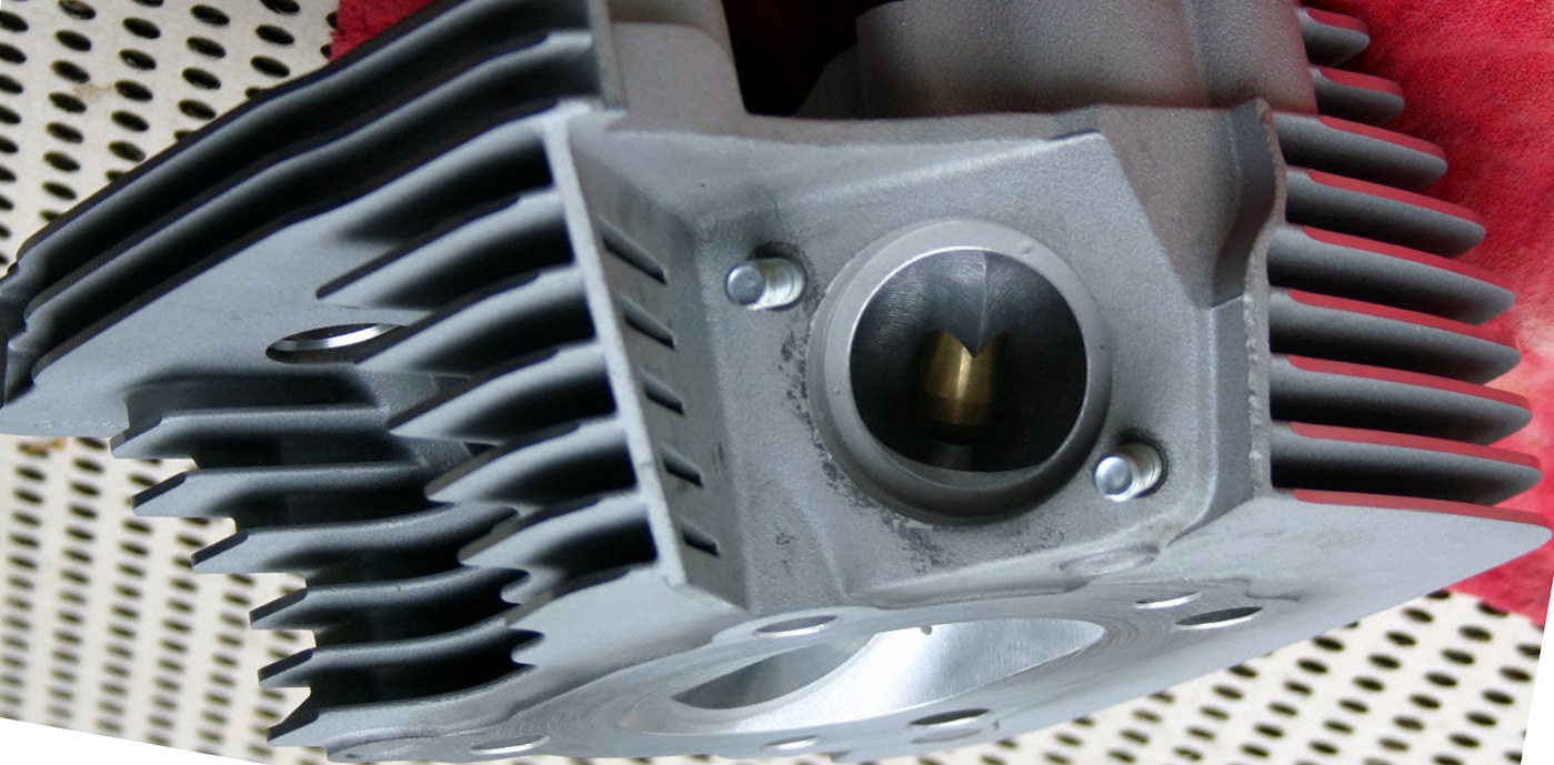

intake port from my 95 inch motor
intake port from my 121 inch motor
exhaust port from my 121 inch motor

Hey Mudd, did Lozano bro's do those?
Ports looks so nice you'd think they were worked on by a German Dentist!
A real one, not Laurence Olivier in Marathon Man.

Well I guess I will find out soon enough about my headwork. I am a big believer in CNC machining and do not see an advantage to a sharp ridge in the intake/exhaust ports over a more rounded ridge; you do not see sharp ridges like that used on subsonic airplanes on airfoils, elevators, etc. but as said before I am very new to the world of headwork.
