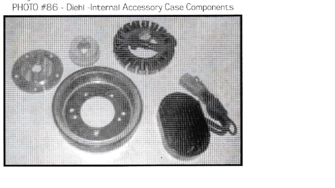

I'm working with an air-cooled VW that has been converted for aircraft use. Here is a pic of the charging system.
The VR appears to have come from a Harley Davidson Softail Fat Boy. Ref: Drag Specialties Solid State Regulator For Harley Softail 2001-2006 | JPCycles.com.
I thought maybe you guys would know if there was a MOSFET equivalent for this regulator.
I'm developing an ECU for the engine. I would like to use the output of the "alternator" as a backup for the crank trigger. But ..., I have to know how all regulators effect the alternator output so I would like to test all varieties.
