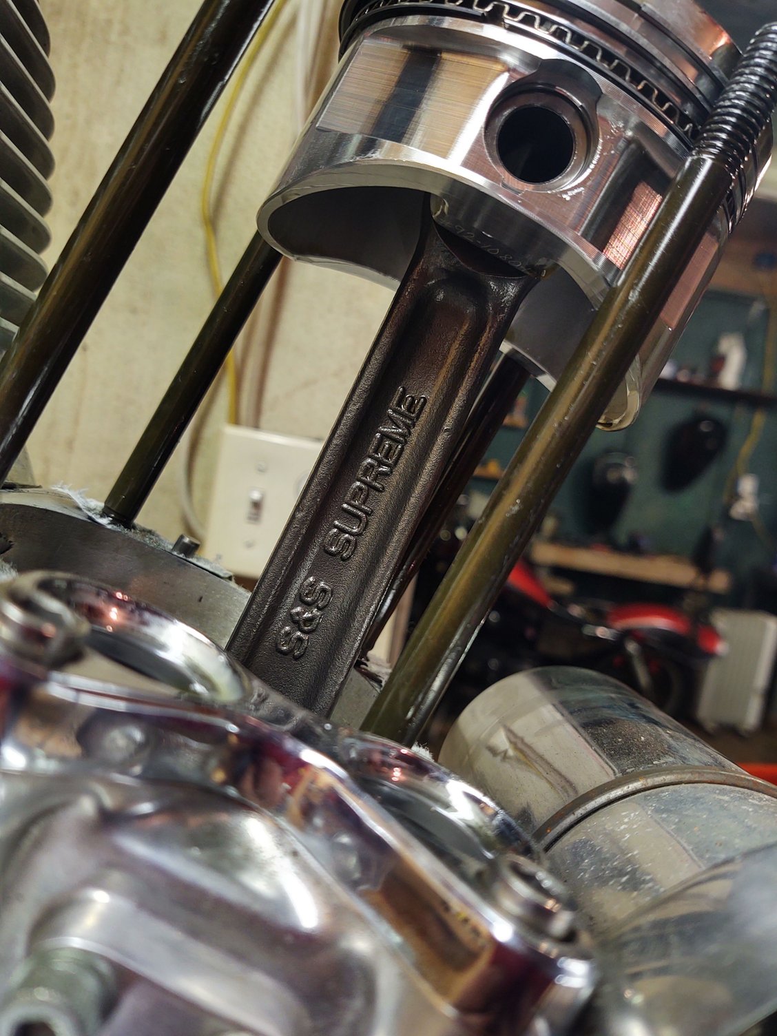

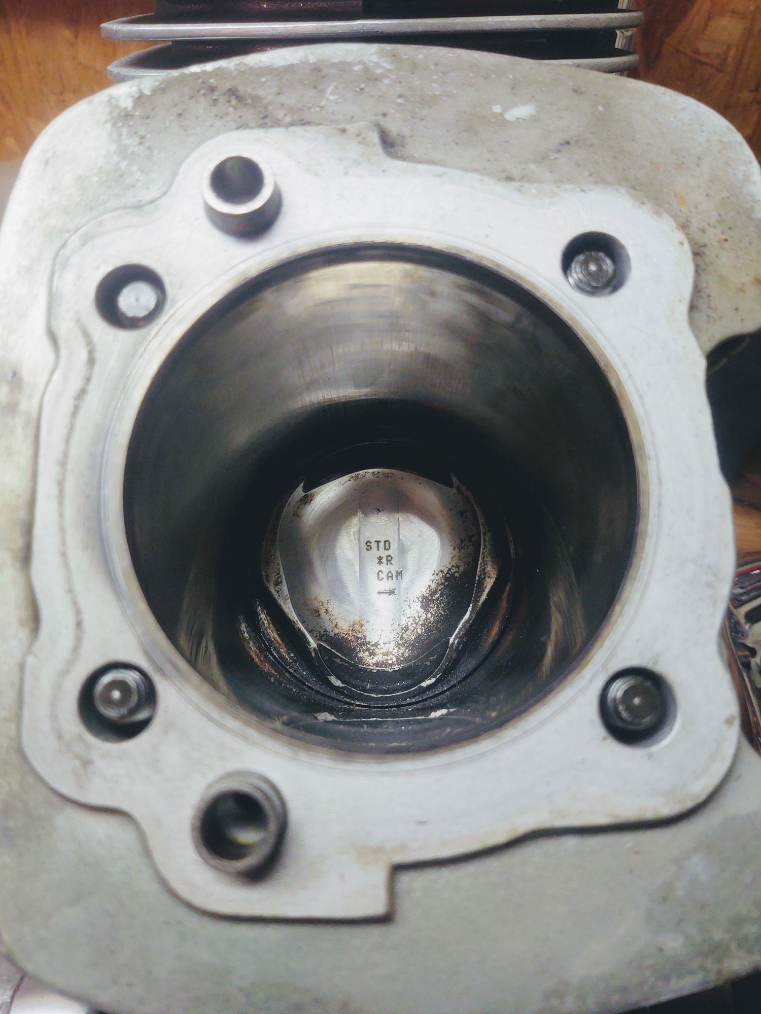

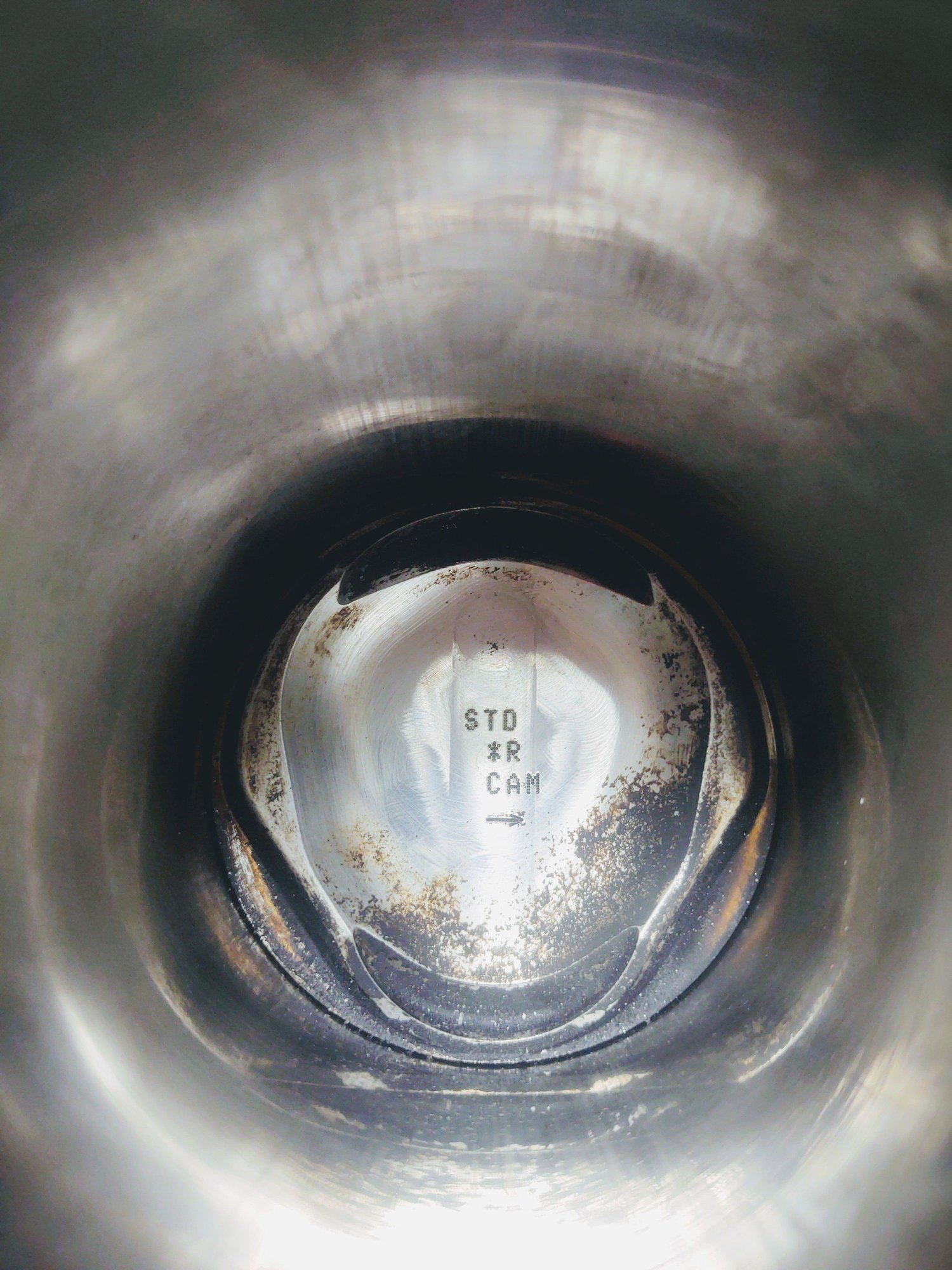

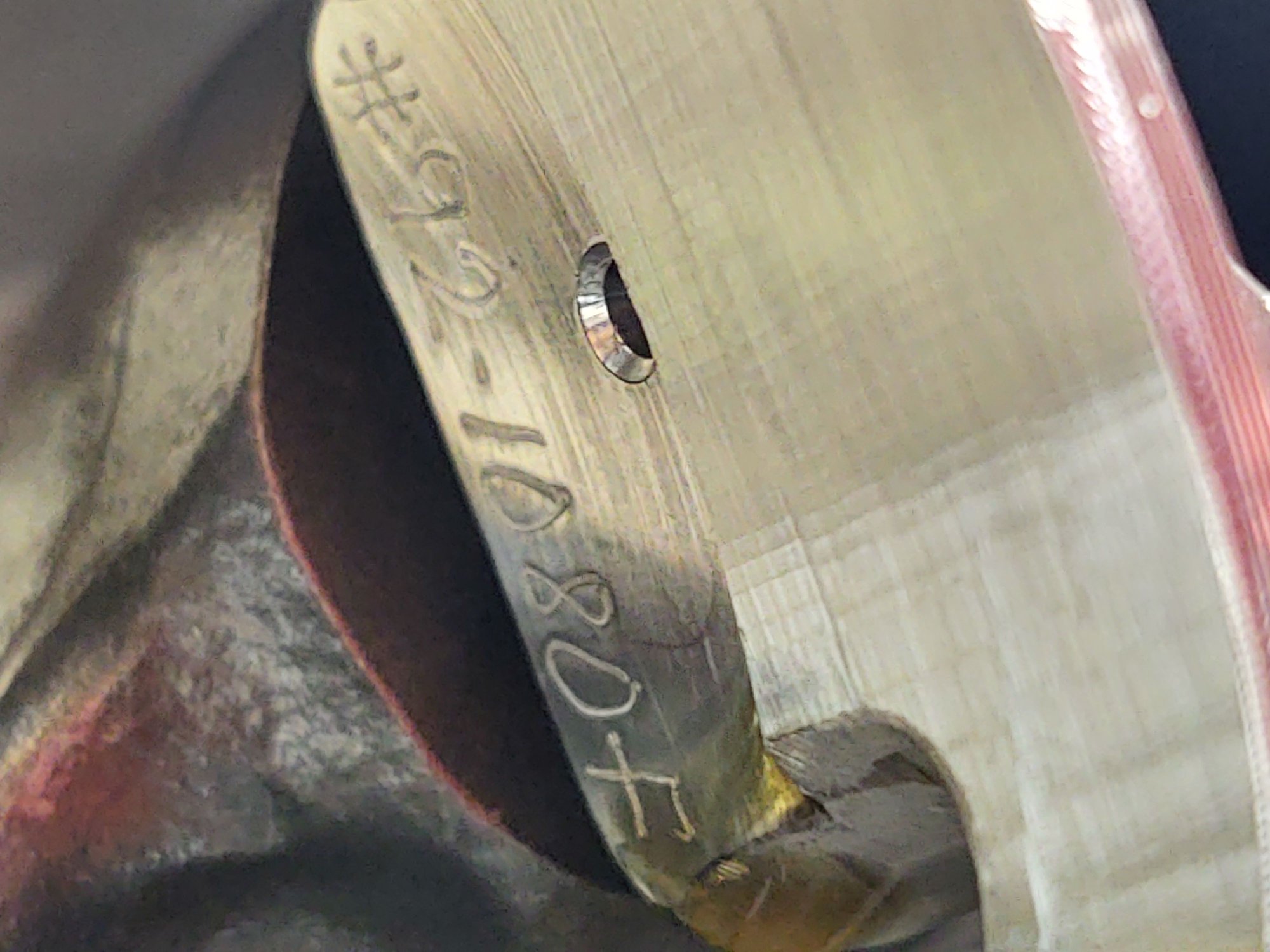

I have these pics as well

Post is 2014. The op only has 2 post ever. The pics are of a sportster case. Hmmm

I think the op and the guy who posted pics are the same guy. He got a really good explanation in the Xl section of what he might have.
