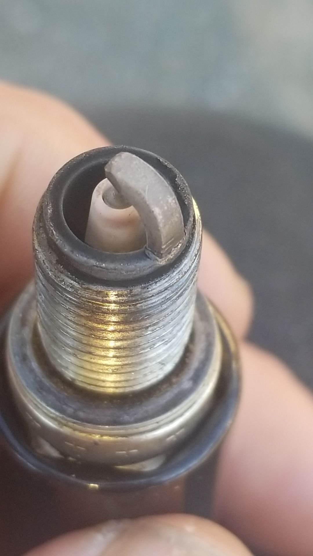

That's exactly what I fear. Rode 20 miles yesterday (freeway) to get it home, then 60 miles last night when it was cool (freeway). Through the 80 miles I took a total of six measurements. The rear cylinder was 350 ish each time, the front 250 ish. Pulled the plugs this morning. The shiny electrode was from the front, the other from the rear.

I know its normal for the rear to run hotter than the front, but yeah, 100 degrees? And frankly, I think it's more that he's hoping / praying, and just didn't want to tear into again until the issue behind the problem finally presents itself. He said "ride it for a couple hundred miles and lets see where we are". I fear that where we'll be is with another toasted piston.
