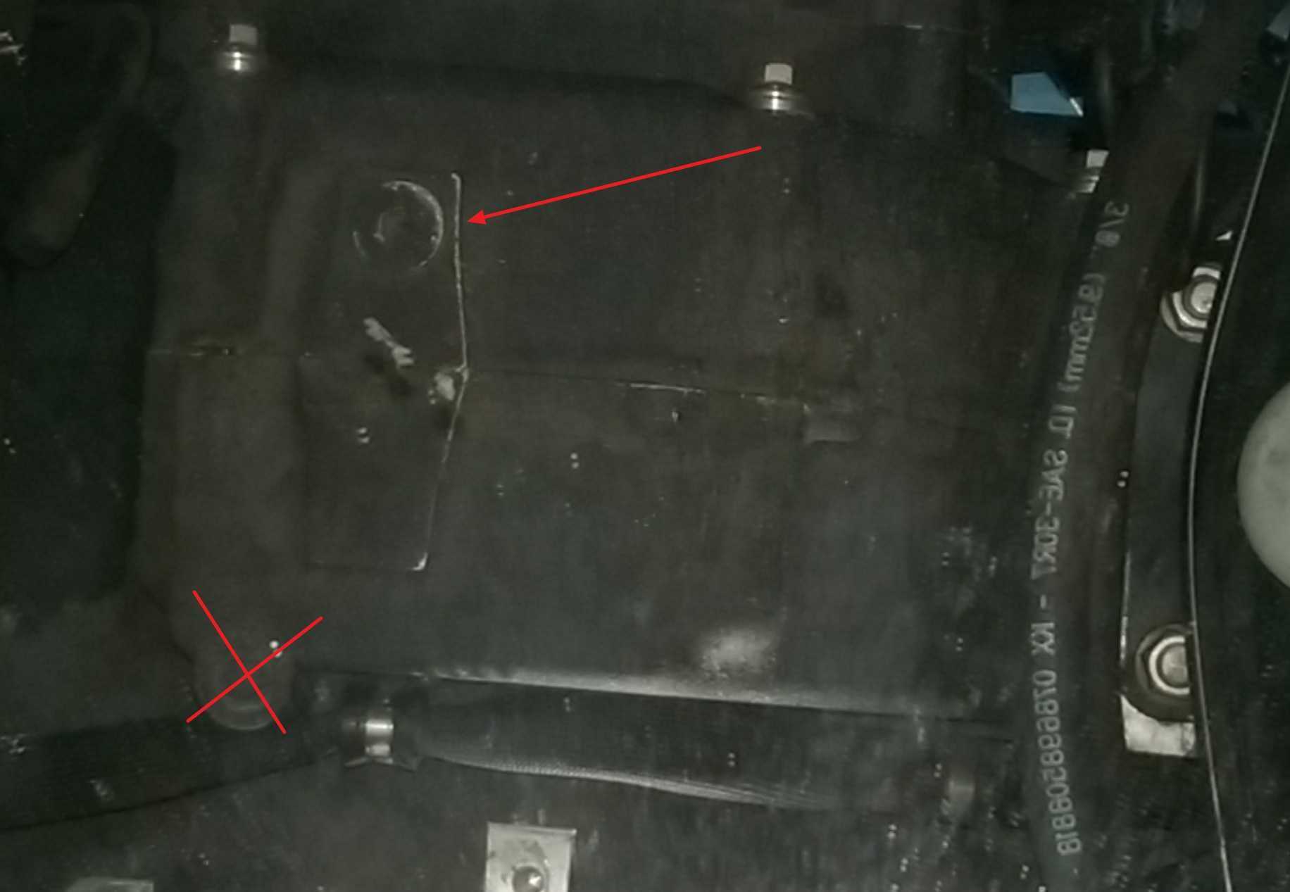

Not sure I understand what you are saying here? Don't use the Right plug? or the right plug would be what a stock engine drains? and the left plug would probably drain more?
The drain plug that should be removed to measure is this one on the left side of the motor sitting on the bike.. The other is the sump scavenge passage. It is what guys use on stock HD TC cases to check sumping because they don't have a center case drain like SnS. On Stock TC Cases you will get a different amount than SnS cases. This was taken with a mirror so it's flipped vertically in the picture.. Use case bolt side case as a reference. It's the left side of the motor. The left side plug will have an O ring and magnet in it. The right side one is a pipe plug.
