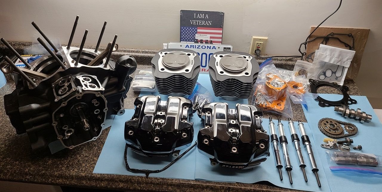

I feel your pain, brother. My current bobber build is a month delayed because the tappet cuff screw broke on disassembly and then the EZ out broke off in the screw. I ended up just getting new cases. I'm finally ready to get the engine built.
Lesson learned. Heat the tappet cuff screws.
