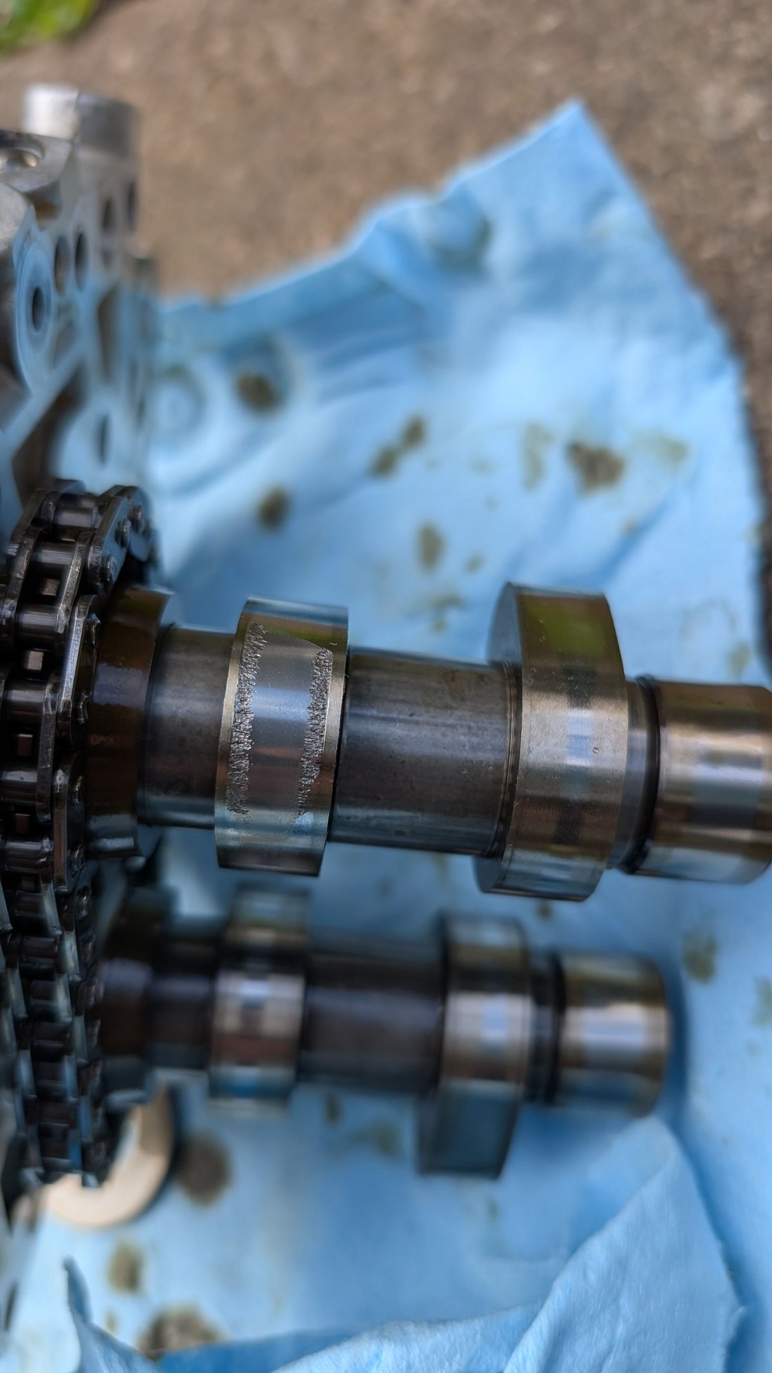

Had an odd noise from the motor which I eventually figured out was a sticking lifter, I stripped the cam chest to do a full service and inspect everything at the same time and found damage to a cam lobe, no doubt the one with the sticking lifter.
So unfortunately I will have to get some cams, my cam plate and oil pump are fine for now so I suspect this has been a slow grind over time as the lifter started to fail, hence any debris will be what was on the drain plug the last few oil changes.
I probably cannot afford a cam plate and oil pump right now so I will just go with some mild cams, recommendations for a standard 96ci greatly appreciated.

Boy, that cam is really torn up. How long did the noise go on before digging in to find that?
Can't help you with what cams other than maybe a thought. Since you sounded like you were trying to do this on a limited budget. Here is an idea - I bet there are a lot of mint, new OEM cams to be had for next to nothing.

Post up a Pic of the lifter wheel..
That wear is on the base circle of the lobe??

year of machine and mileage. are this aftermarket or stock?
cams are not harden through out so the case hardening probably wasn't that great.
before you pull the lifter, see if it has any radial movement.

This is why I wanted to see the lifter roller.. It appears as if the cam was not hardened properly.. It does happen..

this repair will require a thorough study of the entire valve train. lifter failure is high on the list especially the roller axle. but do not over look valve spring pressure as too little causes loss of control and too much accelerated cam wear.
since the grooving is pretty much the same on both sides my guess is the roller. when the engine applies forward rotation force it causes the cam to slightly walk and if the roller axle is toast it could cause the groove on one side and when the engine is in coast down the reverse forces can cause the the groove on the other side. the reason i asked if there was any radial movement in the lifter bore. if there is radial movement then the roller will try and skate. it does not look like an alignment issue since radius ride is usually one sided.
