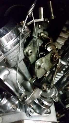

Here what the frayed cable looks like

unless I am seeing this wrong I believe that both cables are out of their sets. I think the pull cable (the one still hooked up) goes in the notch above it and the loose one goes into a notched area further back on that same bracket.
Yeah, they're not even close to correct,
