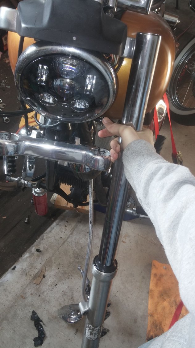

Ok. I just messed up a bushing so I had to order a new one, but the one side is almost done. Added +4 tubes for my winter project. The brakes have been flushed front and rear, just need to top off the rear and install the front when its back together. I will keep this updated with pictures as I go.

Finally got them on. Brake line is too short as is the kickstand. Carb should be fine it's pretty level. For anyone wondering the stock length of a 1996 superglide 39mm tubes are 24-1/8 inches. These are 28-1/8.

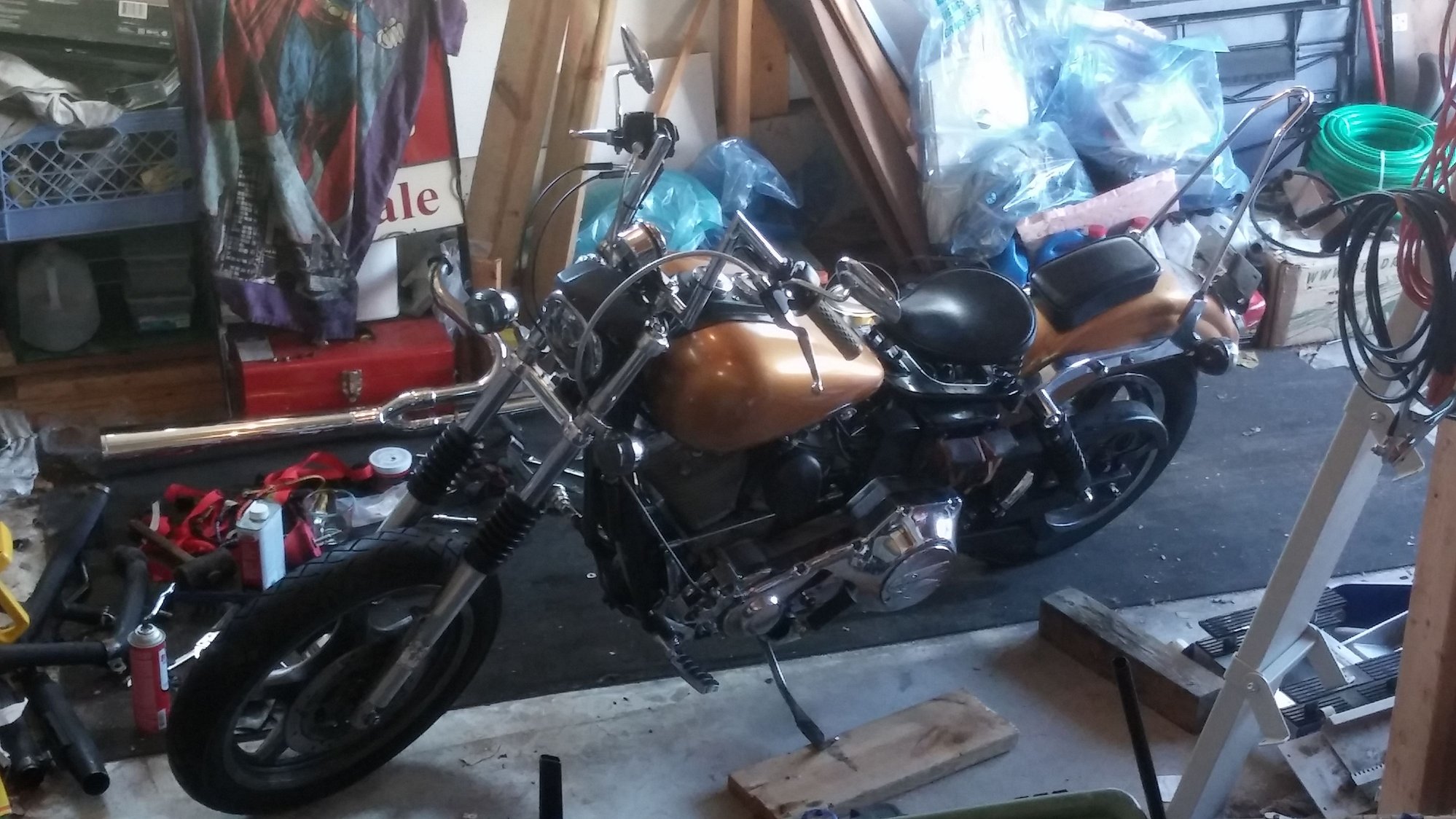

They ended up being tapered bearings. Going to put the new bearings in tomorrow. Installed the new brake line as well, had to go with a 46" line. After the exhaust is back together it's finally ready to ride.

Finished the front end. Pads were hanging up on the caliper so I pulled it apart and cleaned it.
And good thing the kickstand was down huh?
