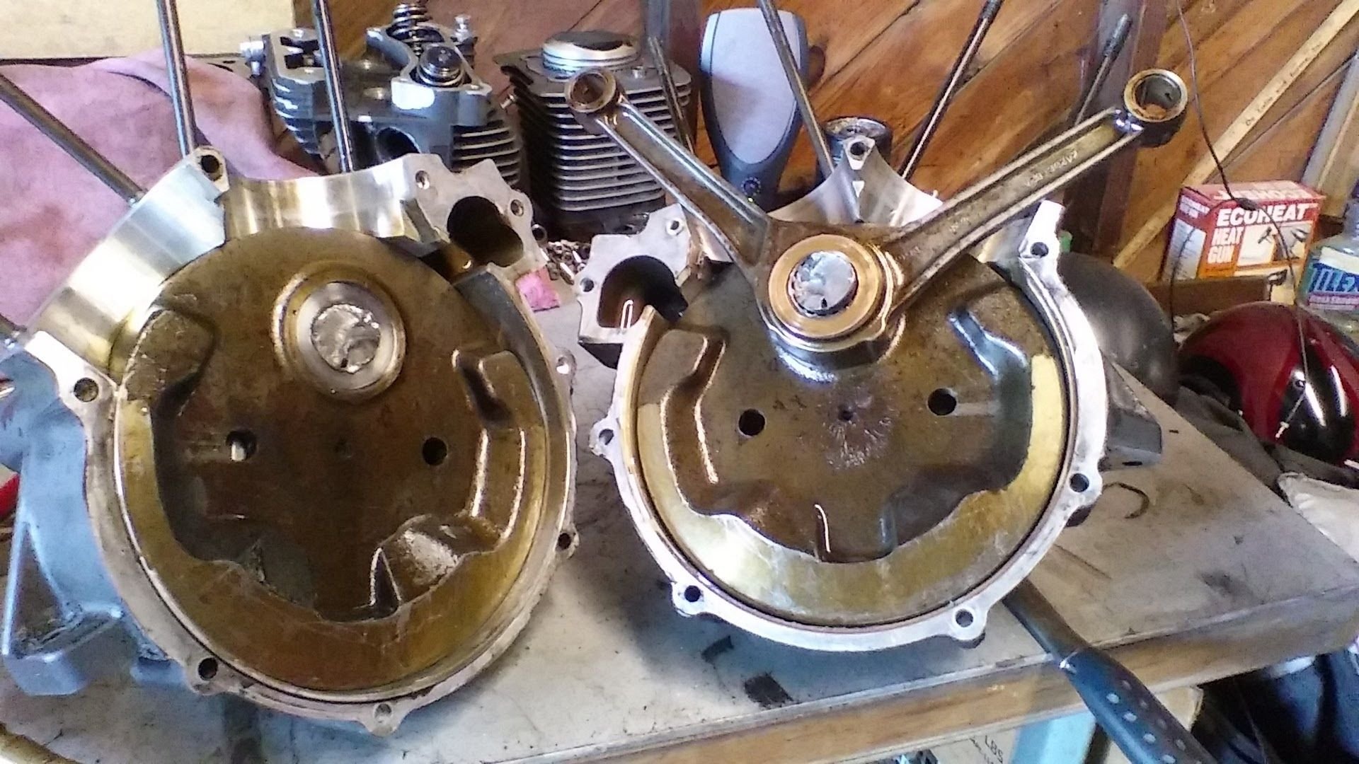

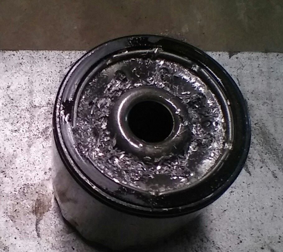

Lots of good info here but I don't believe that aluminum did the damage here. I also don't think anything in the heads could have cause it... I had a crank pin shear and still drove the bike a little to get home. Upon a tear down of the motor I found that the because the crank pin sheared, the right half of the crank (cam side) rode against the inner motor case housing shaving the aluminum away. My point here is that upon completion of the tear down inspection, I did not have any damage to the oil pump that had picked up all the soft aluminum but did need to bore the breather gear and install an over sized breather. My oil filter was packed with Aluminum but the pump gear and housing had no damage at all. So I would definitely be looking for cam bearing or even lifter roller bearings.. Did you cut open the oil filter. One more thing, as stated earlier. You don't need to pull oil pump shaft unless it bent.... Please don't confuse this with what happened to your motor. My point is about the metal type and what it can and cannot do... Time for a full year down.. and yes you can split the cases yourself.... I'm sure there is still something down in the cases...
