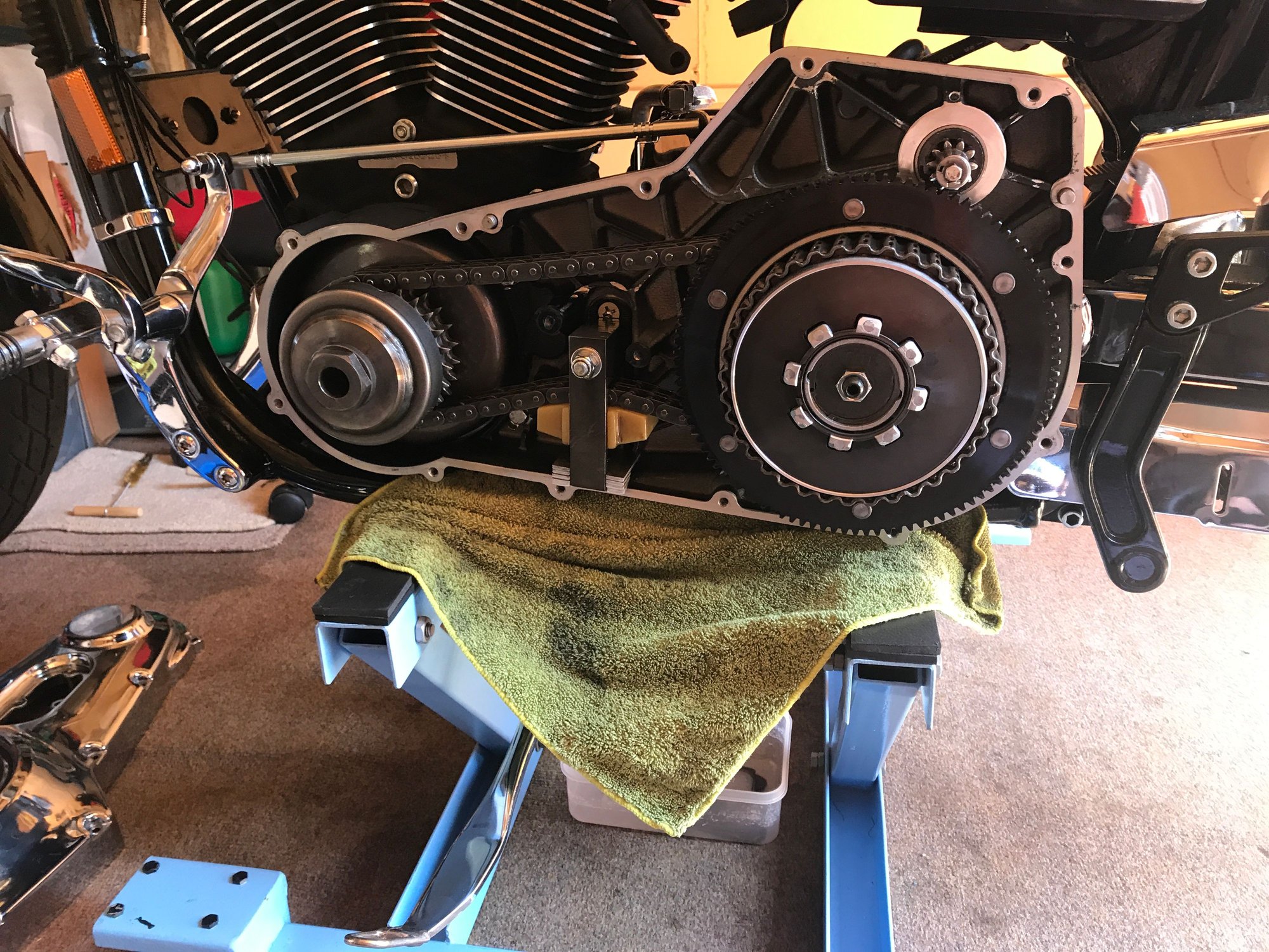

Hey guys, whats up,
So the disassembly has begin, made a good start, im in no rush,
i would like to ask if someone could run through a quick step by step on clutch and compensator removal? Im not sure if i need a spring compressor tool for the clutch , Obviously i want to make sure i do this correctly, so better to ask than to just get at it lol
I have the factory service manual , however i am finding it a little cryptic.. Heres what it says....
Also would like someone to look at my chain adjuster, it looks like somebody has cut up some square plate washers, im not sure this is correct, or did somebody bodge this?
Daz

the comp nut you need a rattle gun and 1 1/2 socket the clutch back off on the adjustment screw and remove the clip then remove the nut and it is ( left thread )
