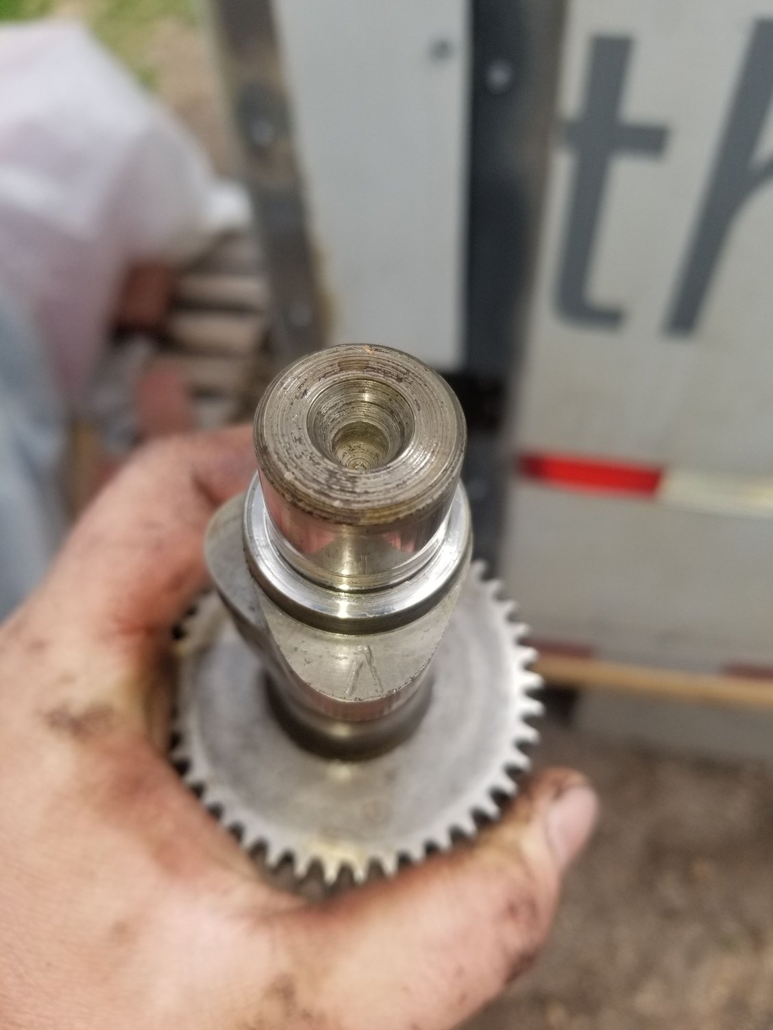

Today I pulled the rear head and jug off. Luckily no surprises in this one. So now its get them boxed up and shipped out to hillside. Cant wait to get them back and installed. I also pulled out the cam. The only marking I find on it is either a "v" or a "n" stamped on the last cam lob. Would it be safe to assume that this is a stock cam?

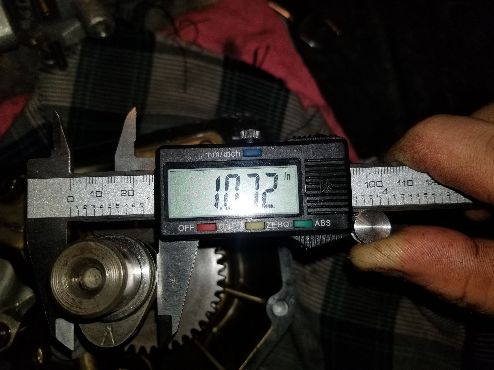

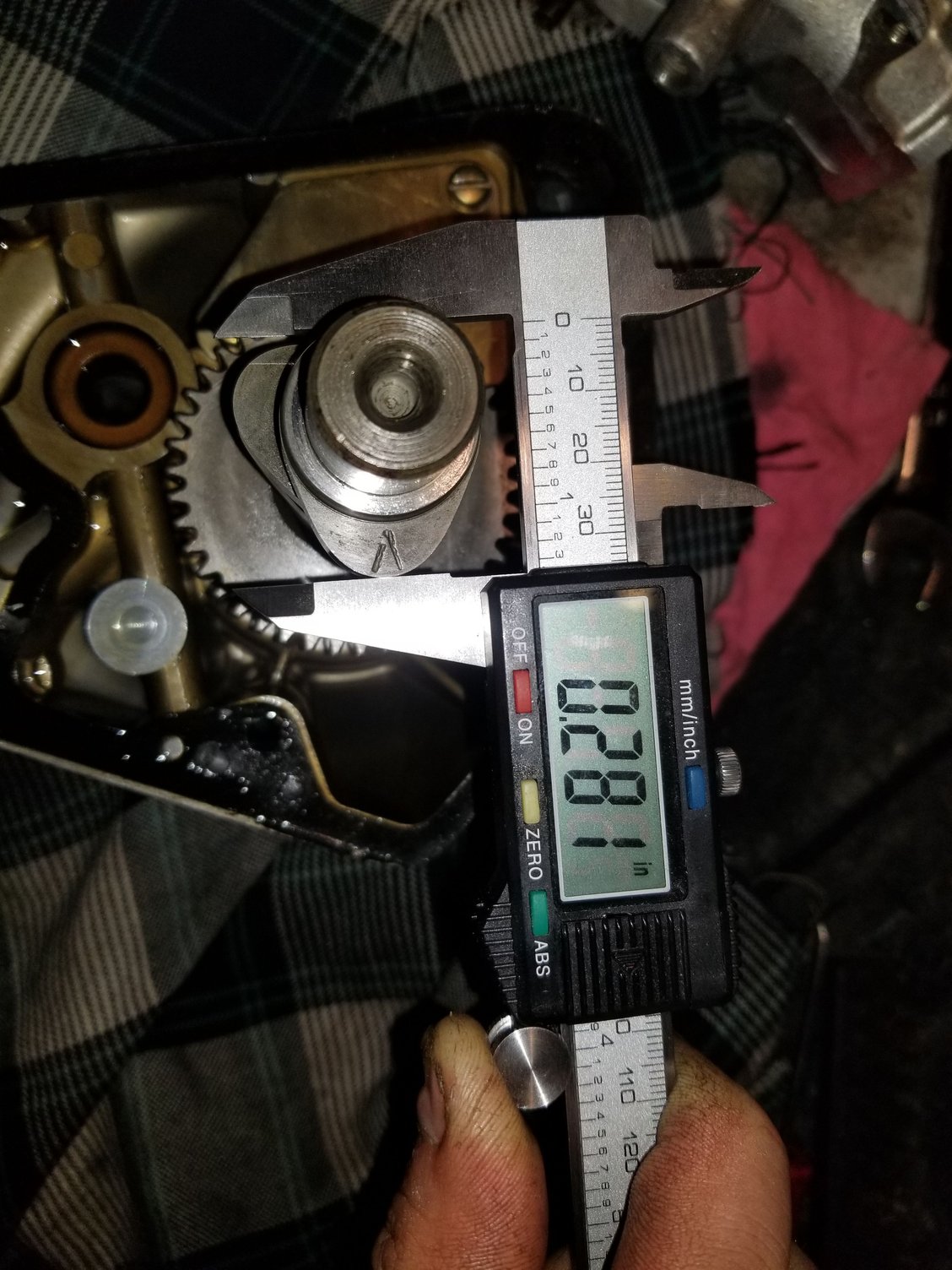

Ok I need some guidance. I measured lift on my cam to see where it was at and if I could figure out what it was. With some research I found out the rocker arm ratio is 1.625. So I measured the base and got 1.072" as shown in pic below. From there I zeroed out and measured the lobe. I got .281 also shown in picture below. So now we take .281x1.625=.456625 for lift. The closest I found was a sifton 145 ez at. 460 for lift. Any idea on what it is? Only mark on it that I can find is the "v" stamp on the last lobe, furthest away from the cam gear.
