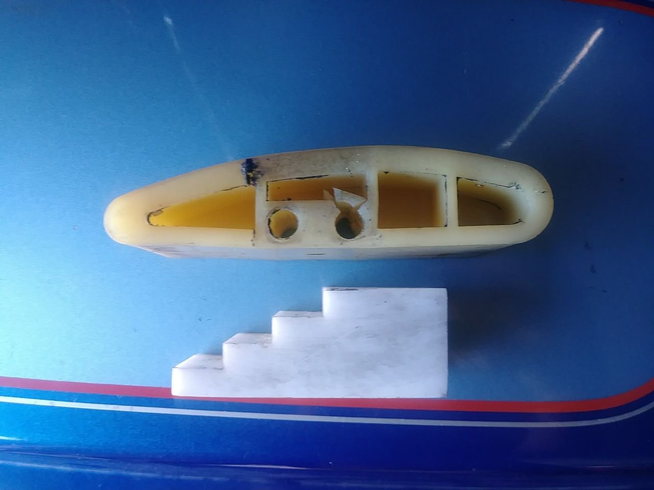

Hey, just reassembling my late 84 (evo) FXRS.
2 questions about my primary chain adjustment shoe:
How do you know when it needs replacing?
- (Although if I need to ask, I should just replace it right?) There's three grooves worn into it.
The deepest being the center, which is maybe 1/16" deep.
Does it matter if the tallest/thickest end is facing right or left?
My service manual (not haynes or clymer) didn't mention anything.
Thanks in advance.

A 1/16th is nothing, wide side right.

I replaced my OEM pad at around 80K miles with 1/8" deepest groove, and also a crack at one of the mounting bolt holes, so I got some real good use out of it. I think the one I bought was very similar to it off the internet. Could have picked one up from H-D for cheap also,but didn't think about it.
Anyway, so inspect the pad for any cracks before you put it back in. If you decide to replace it, keep the old one as a cheapo primary locking tool for the road.

The original primary chain adjuster shoe in my `89 FLSTC came out at 115,000 miles. I changed it just because I had a new one on hand. The old one looked like it would go a lot longer.
