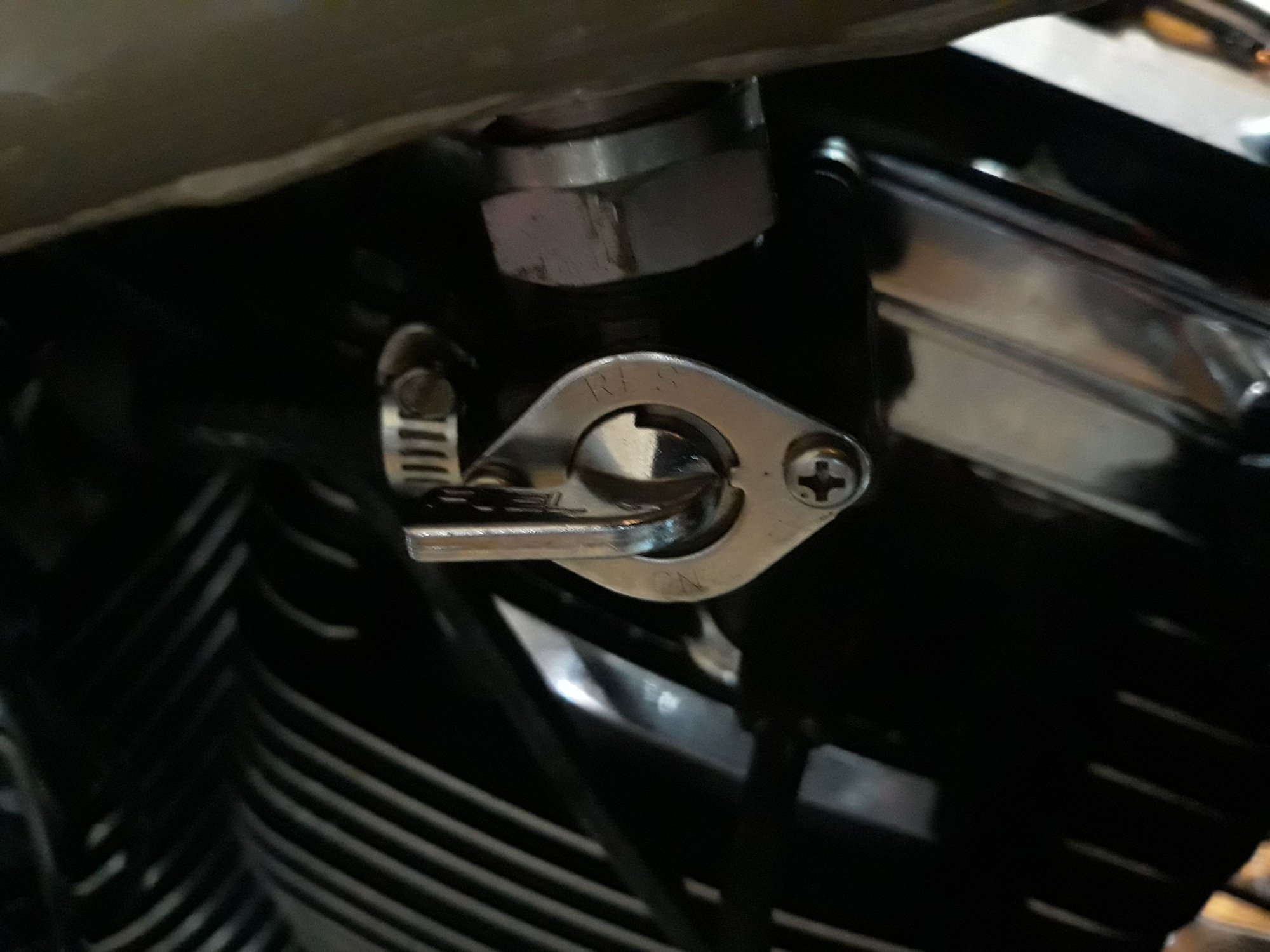

I would say, New Petcock and Screen... But, No Pics, so can't know there even Is a Petcock...

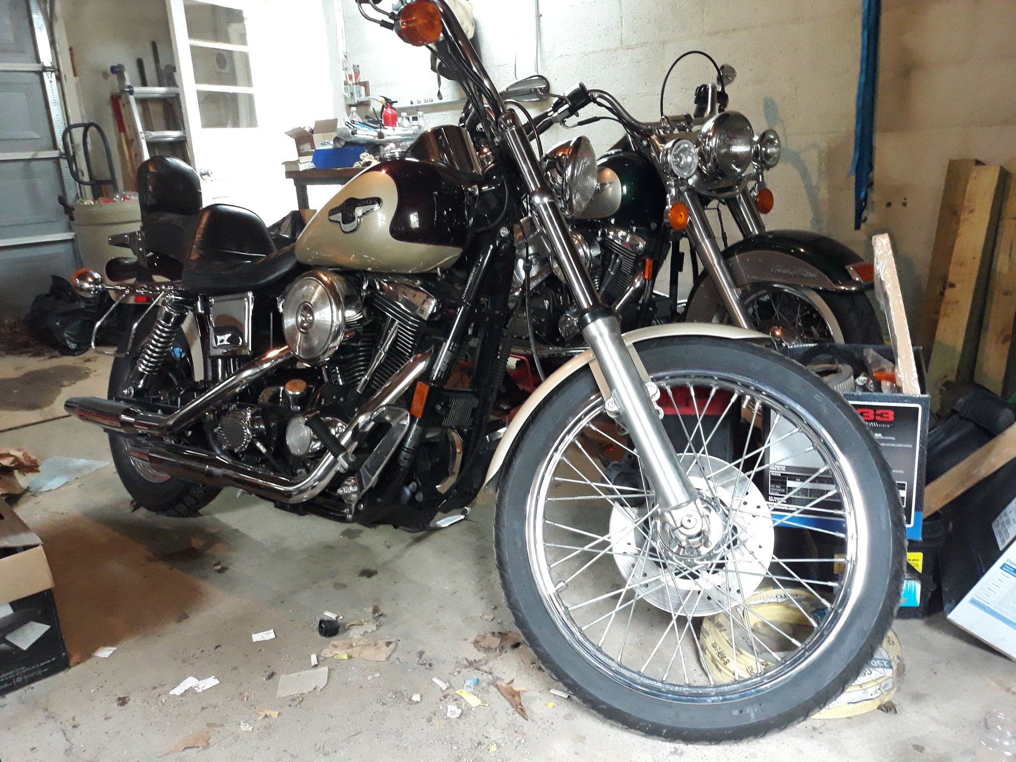

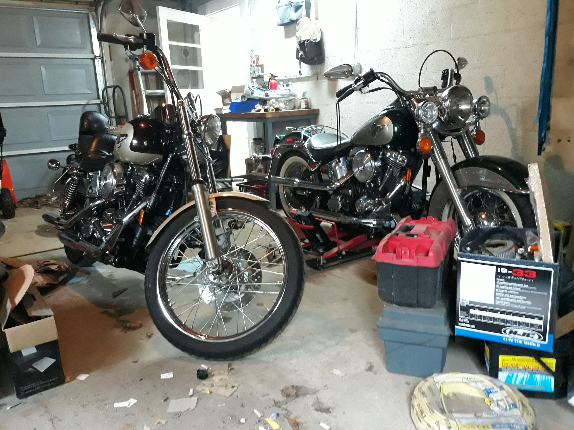

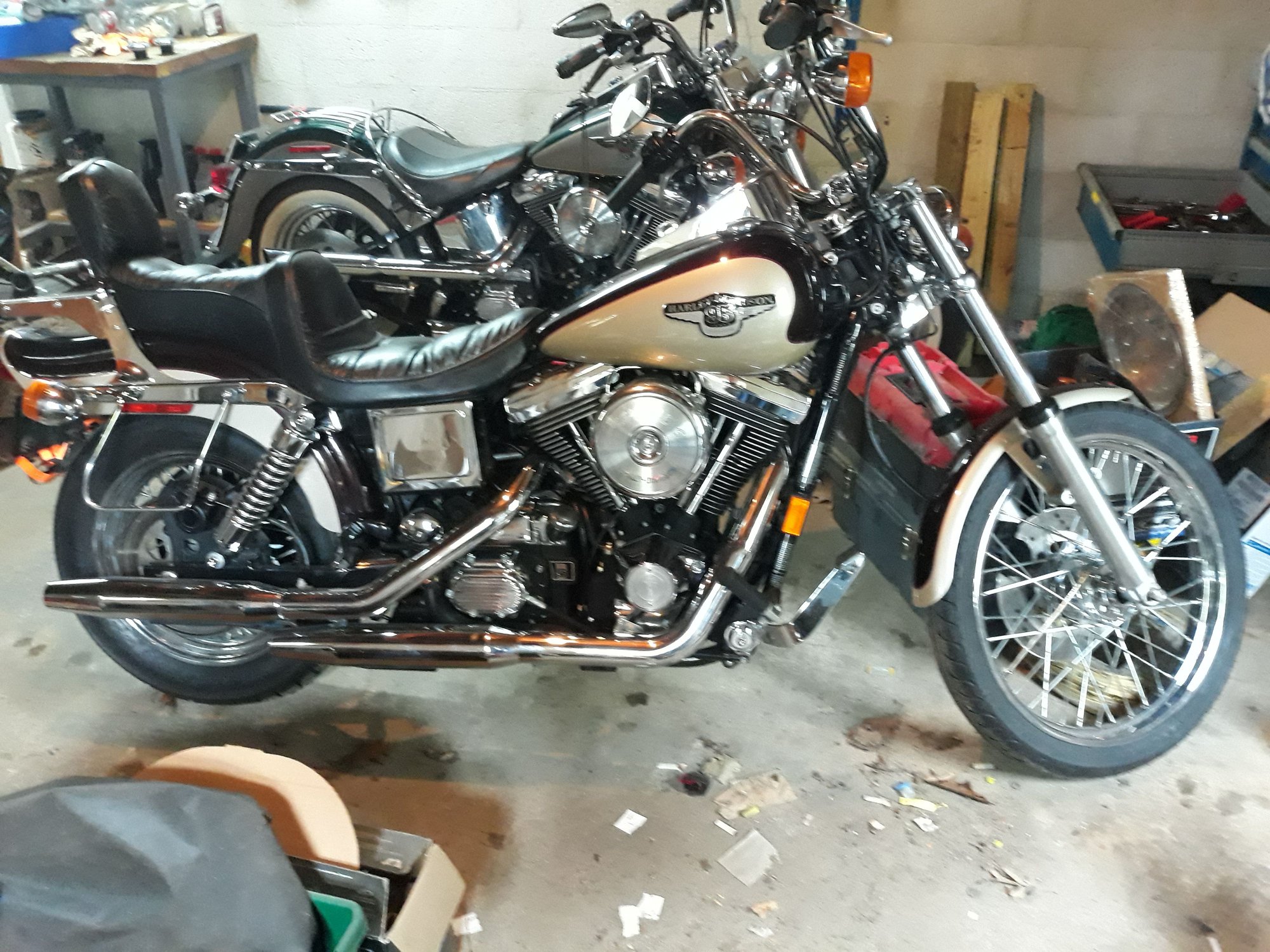

LSTORY's Avatar
LSTORY
Joined: Jun 2015
Posts: 45
Likes: 5
From: CADILLAC, MICH
Default Pics
Petcock is a vacuum.
