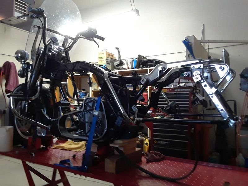

I pulled the rear tire and swing arm today. I pulled the rear fender too.
I've been cleaning as I go and wanted to get the battery tray out, I couldn't see any way of getting it out without pulling the fender.
I figured if I kept messing with it I'd scratch the fender and wish I'd have pulled it off.
I think it's as far apart as I need to go.
No word yet on the engine, probably another two to three weeks. I was originally told five weeks.
I've decided to upgrade the rear swing arm, wheel and brake since I'm in this far. I have a 2005 swing arm and brake, I'm waiting on the wheel, and I need to order the bearing kit to adapt it to the bike.

When I decided to upgrade the swingarm and rear wheel I didn't realize I needed a narrower drive belt as well. More parts ordered, and time waiting for them.
And money spent. I'm glad I'm not trying to stick to a budget on this.
I used the CCE adapter kit for the swing arm bearing and had to use a .015" shim on the left side next to the trans. to get things to move freely.
The left side bearing would not press into the swingarm any further and there was no free play in the bearing when the swingarm axle was torqued.
A wheel bearing shim is close enough on the ID to work.
