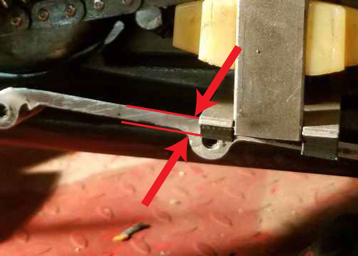

I've fallen in love with my 3D printer. Those things are seriously cool. One of those "you'll never know how useful it is until you've got one" kind of things.
Is your outer primary going to clear this?
They have to be some kind of alien technology... I'm scared to even think about it
Clearing the primary was one of my concerns as well as why it hangs out over the edge like that. But again, I'm not a Softail expert. I think I'd run it dry with the cover off for a minute before buttoning it up...
Thanks for not turning me into the photo police 0maha
Heh.
At first glance, it seemed like that tensioner was standing proud from the inner primary. On second thought, how can it be? Unless Hess shimmed it out at the inner primary, it has to be sitting exactly where it's supposed to sit.
Can we form a "Not a Softail Guy Club"?

Yeah, I'm not a "softail guy" either. This is, after all, a HardTail chopper.
I don't think clearance will be a problem. It came that way and I'm only raising up the H shims to level.
