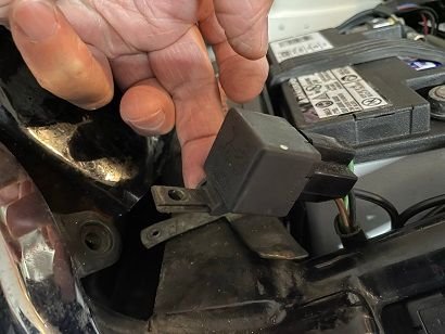

My 30 amp main breaker is still located in the original position, the original worked from the time the bike was new until I replaced it while doing an electrical clean up on the bike last winter (winter in South Carolina ).
The starter relay was relocated during a recall, which added a short wiring harness so that the relay could be moved up near the battery, underneath the seat. They also installed a cover over the relay.
This setup obviously worked, the relay was still working when I changed it out after more than 30 years.
Here`s a link to an old recall kit on ebay:
Link
Some pics of the relay on my `89 FLSTC:
Bracket
Relay Cover
Relay
Relay and cover installed on the sheet metal bracket.

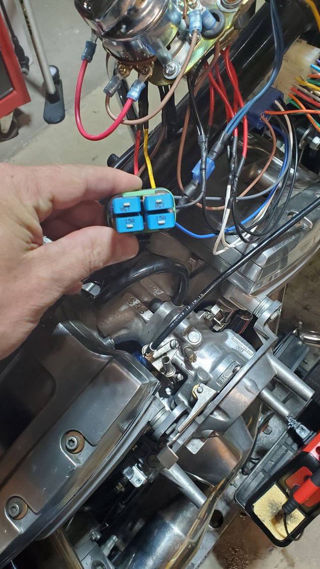

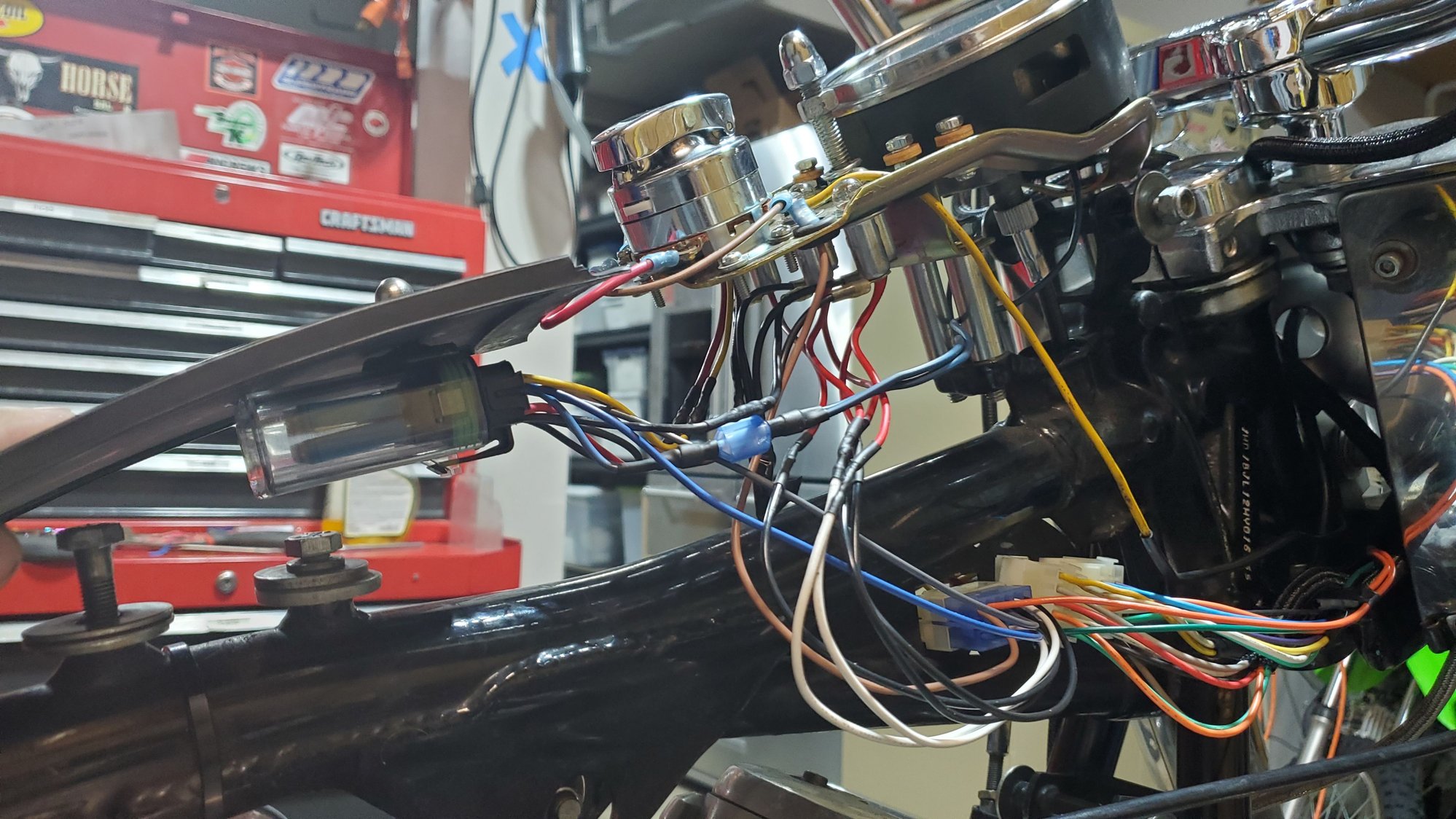

I got all the wiring roughed in last weekend. I dropped the battery in and was happy nothing appeared to be melting. Turned the ignition on and had neutral and oil dash lights for about 3 seconds then nothing. No dash light, headlight, ignition. My heart sank. I had failed. I pouted for a little while then realized everything I had been doing gave me the knowledge to trace power and figure out why it wasn't working. I had my breakers plugged in wrong and one wire on the starter relay relocation harness wrong. Everything works! I still need to mount the relay in the new location and tidy everything up but I'm very happy about being where I'm at.
I wasn't too sure about my choice for dash breakers. A little different from the factory set up. It's more hard wire vs removing wires from the breaker post. I added a plug connection so I can remove the speedo without cutting wires. 4 breaker block so I'm carrying a spare. I guess time will tell.

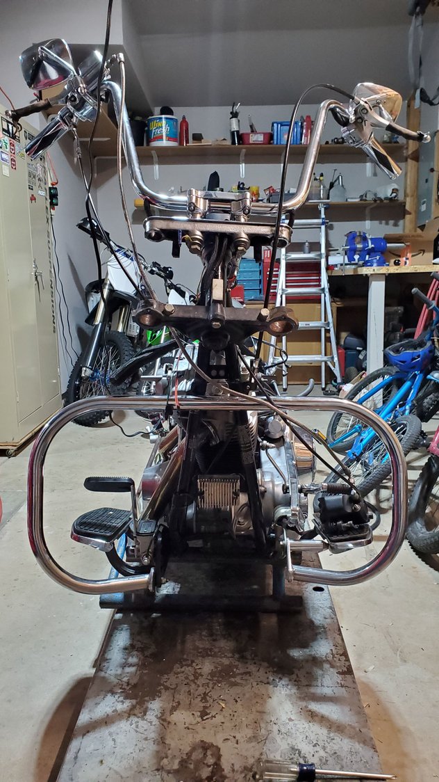

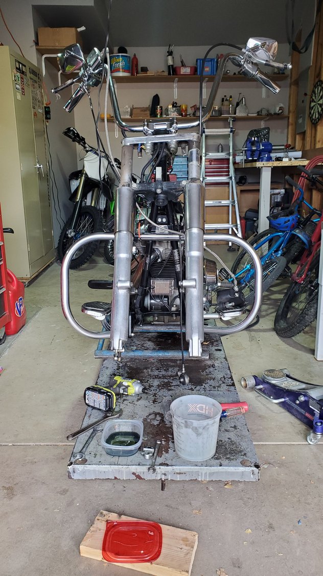

Pulled the forks yesterday. Found a wire grounding two bolts and the clean looking spot on the left fork tube was wrapped in duct tape. The wires come as no surprise but for the life of me I can't figure out why the fork tube was taped. Tires are 12 years old..
