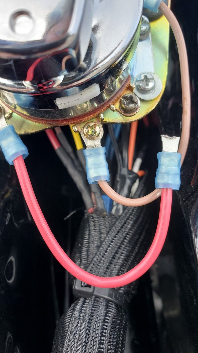

Saturday was almost a very bad day. I had it on the lift with the front tire locked in. Got the rear end back together and needed to turn it around to remove the front wheel again. I had no front brake but the rear was working. I asked my son come out to release the front then help me push it around. No idea what I was thinking but instead of sitting on the bike and operating the rear brake I stood on the side and proceeded to roll it off without him behind me to control the speed. I lost control and dumped it into the shelving in the top picture. The handle bars caught the shelving which prevented damage to the fresh paint. It pushed the shelves over about a foot and knocked some stuff off which may or may not have hit my Jeep on the other side. Haven't chcecked the Jeep yet.
Things to look into.
1. No ignition when I turn the switch to lights. I never tried to start or run it with the lights on until the test run. I removed one of the jumper wires on the switch so the lights would remain off in the ignition position but I guess that killed power beyond that.
2. No speedo. When I took the bike apart the cable was disconnected from the speedo. Connected and turned the cable and it appeared to be working. I replaced the drive unit at the wheel because the tab wasn't catching. I'm not sure what the issue is.
3. I think I might need to replace the front fork studs or nuts. I sungged them up with a ratchet but when I went to torque them they wouldn't hit the #. Felt like it was spinning and I was hesitant to strip it.
This was aslo my first ride with a helmet. I did not like it. I went with a full face Shoei. It will take some getting used to...

Fixed:
- Ignition with lights. Connected the jumper wire I had disconnected. Simple but I would still like the option to run ignition w/o lights.
- Did not keep an eye on the drive unit when I installed the wheel. Tab was not in the slot on the rotor. Had to remove front wheel, straighten tab, and reinstall. Working properly. Trip meter is wonky. All numbers bounce all over the place while riding. I have not reset dial. Ordered a new spedo.
- Received front fork studs today. Will replace.
New issue:
- Lost dash lights (neutral and oil) at the gas station. Got back to my office and discoverd I also lost brake and tail light. Headlight and driving lights still operate. Light relay/braker was tripped. Reset no change. Pulled dash cover and I've got a broken wire. At first I assumed vibration broke a cheap connector but it looks like the post/connection got hot. Dash lights work with ignition in the accessory position. Lights also work when I touch the broken connector to it's location. I'm going to replace the wire connector and see what happens. Anything else I should be looking for?
