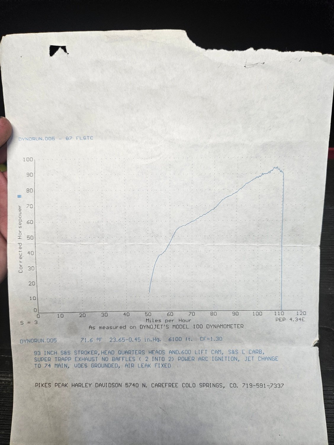

I'm sorry I have no idea how I missed your post. This is the only dyno info I have. No idea when it was taken but it looks like he already had the supertrapps on at the time.

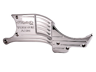

Torque will do that, that's why after market companies made the Torque Plate for the righthand side to connect the engine and trans,. that's why also its absolutely critical to have no preload on either your trans end of the inner primary or the engine end when fitted. Either the motor or the trans needs to be loose until you to torque the inner primary against the engine and trans and then lock the trans (usually) down to the trans plate. there is a whole range of things you can do to help prevent the motor or trans from shifting (even ever so slightly) under load. For example, ensure engine to frame mounts are flat and as flush as possible to give the best binding surface available, same goes for the trannie. use fine tread bolts where the Factory has course threads on mounting points. this will allow you to safely torque them done that little bit extra (without going silly of course). I'm about to put a 120hp (here's hoping) S&S 113 in my 86 wide glide and i searched for about a year for a spare quality inner primary and was lucky enough to find a Genuine NOS item.

Sorry they are called Torque Arms not plates. you can find them here https://viciouscycleworks.us/index.p...408489n79v1ysz

The OP has a solid mount engine and trans, torque arm really ain't going to do much for him He needs to find out why the motor is moving so much and he should go to as suggested fine thread grade 8 bolts to mount the engine to the frame. I've had issues where the lip seal on the case broke because of a lot of power in the motor It's more common than you think but I've never seen an inner primary break like that something must have been really loose.. Also take a good look at your frame mounts..
