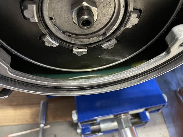

Last question, for now anyway. The owner's manual states the primary for FLT models takes 38-44 oz of fluid. The service manual has a diagram of where the fluid sits with the bike startight up.
Where mine sits...

Reason for the inquiry is that I have already added 44 oz of fluid. It is just at the bottom of the spring plate. If I add anymore I am over the recommended amount.
Don't want to overfill but I just need to know if what I have in there is sufficient and meets the criteria.

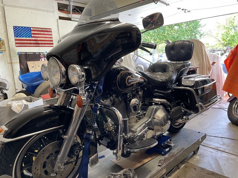

I see it's on the jack, is the back tire on the ground?, I think your good with 44.

Yes back tire is on the ground. The jack keeps bike level so I can add correct amount of fluid.
But if rear wheel is on the ground and front wheel is not, then the bike is not in the same position as with both wheels on the ground..
Important if going by the instructions is to have the bike level from side to side, and both wheels on the ground.
However if suspension has been changed like a lower rear or higher front, then the picture in the work shop book is not the best way.
I would go with the amount of oil stated in the book.

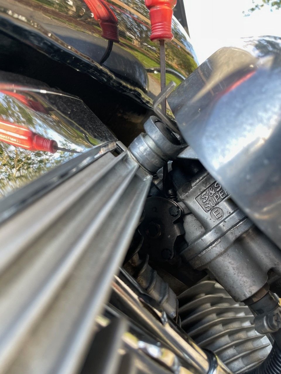

So...went out to see exactly how I access the idle speed adjutment screw. Idle mixture screw, not a problem; accelerator adjustrment screw, not a problem; idle speed adjustment screw....now that's a problem. How do I access the secrew. The breather hose for the carb backing plate cuts right across the top. Additionally, the stock gas tank prevents me from using a normal long thin bladed screwdriver.
I assume I will need some type of automotive screwdriver with an adjustable shaft.
Recommendations please.

That make an extension screw, if that won’t work, after a ride with bike/engine warm, Remove or move the breather hose, start engine, wait a minute or two, adjust to correct speed, shut down and reinstall.
Once set, idle speed never really changes all that much.
