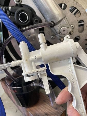

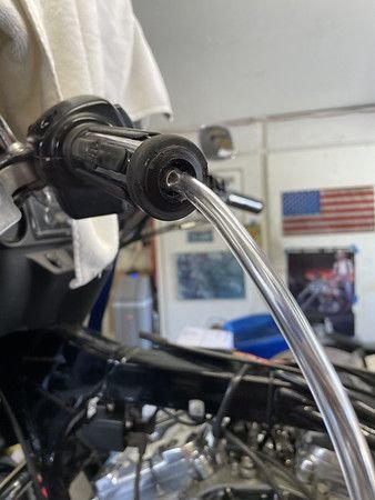

K, I'm stuck. Got air out of the forks, removed Schrader valve, removed bottom plugs and drained oil out of both.
Attached a tube over the Schrader valve, tube in the bottom drain hole, plugged the other side, attached a Mighty Vac to the top, but I cannot get enough pressure to suck up the fork oil (have correct amount measured out in a glass jar.
Seems as tho I need a small motorized vacum unit to suck up the fork oil?

Yeah, that's the dirty little secret no one mentions There may be some guys who can suck it in with a hand pump, but I've never been able to pull that off.
I use a 10cfm Robinair pump from my hvac days now, takes <10 seconds. But before that, I simply used a length of cheap hose connected to a vacuum source off my pickup (idling) connected to the schrader. Also, never tried to make a fitting or had any luck with a hose that would fit into the hole. Always use a larger ID hose and hold it snug/flush against the fork, which is impossible without a 3rd hand while trying to use a hand pump.
They sell el cheapo pumps on ebay for $25 but I'd think a length of hose as mentioned earlier would be quicker to acquire and definitely work, depending on what kind of space you're working in and with.

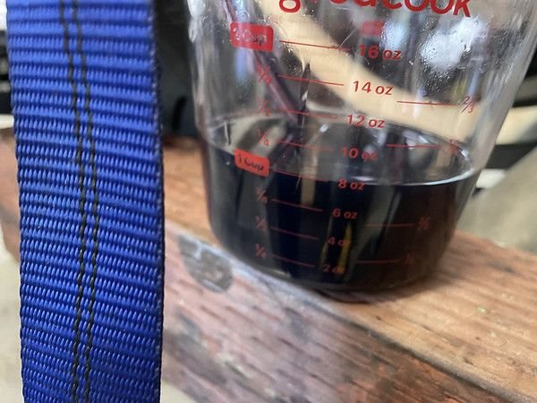

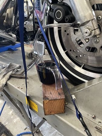

So, I actually figured it out and now have 7-3/4 oz of fork oil in each tube. The service manual says to put one end of your tube in the fork oil you intend to put in the tube and the other end into the drain hole. I did that and had good seal on top (where Shrader valve goes). As I mentioned earlier I could not get the Mighty Vac to push air into the tube.And that is because i did not hava good seal on the bottom, so basically there was a vacum leak. Ended up using one the rubber fillers from the Mighty Vac, plugged the filler into the 3/8" in hose and then plugged that into the drain hole. Ended up sealing the hole and after a couple of minutes I had oil in the right tube. Lost a couple of drops, pulling the plug out and inserting the screw but nothing significant.
Bought a 2-cup plastic measuring cup to help make sure I got the amount right. The filler tube is 3/8" clear plastic, 16" long and holds 1/4 oz of fluid. I filled the container with 16 oz and pumped until the level in the measuring cup reached 8 oz. That plus the 1/4 oz in the tubing means I got 7-3/4 oz in my forks.
Once I got the Shrader valve back in I put in 5 psi of air.
