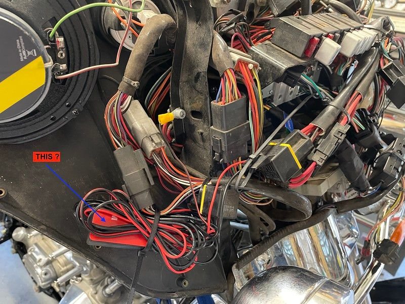

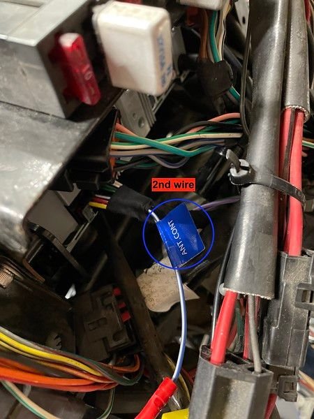

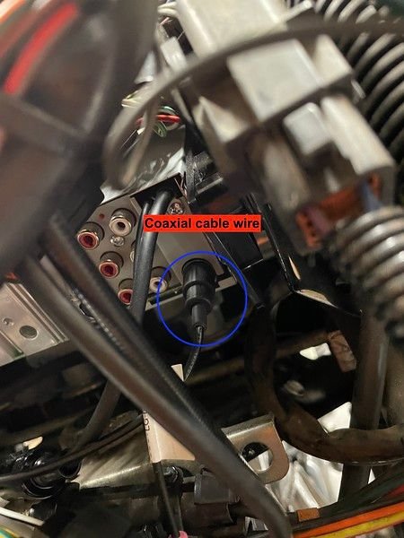

At this point I am totally undecided about keeping/not keeping the radio. Never had one and I do like to listen to the sound of the motor and my surroundings rather than having tunes. That said it was added at some point (would have only had the glove box since it too is the FLHT model). If I can get it working I will probably keep it. Bought a good relay and tried it with each existing one. No luck.
I did locate the owners manual for the radio tho. Shows a 10 amp fuse as part of the workings. I'll check that. Also from reading the shop manual there is a 1 amp fuse that I pulled and definitely is toast. The other two 10 amp fuses are good.
There is this attachment that I am trying to identify. Think it might be some type of antenna?
Consists of two wires and a cable

Likes: 32
From: Savannah
Rockford Fosgate PMX-ANT
Amplified AM/FM/WB 12-volt antenna
https://www.crutchfield.com/S-147Ywy...xoCan4QAvD_BwE
