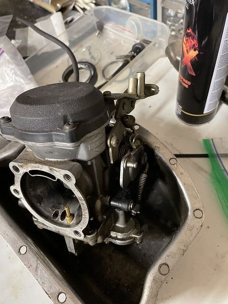

The location of the throttle cable bracket is on the opposite side (looking at the bike from the right side) of the CV carb.
And when I placed the carb body against the intake manifold, there is seemingly no way for the cables to not interfere with the mount.
No way to run across the top of the mount either. Even if possible I'd be worried about running out of throttle cable when it comes to turning movements.. With the assembly on the left instead of the right, there's an easy 4-6 inches added.
I bought the kit through one of the Forum's sponsers. Won't involve them until I go to return the carb kit (if need be).
S&S has a number for technical support. Figure that is my first step.
Am I missing something here? Sure does not seem like the carb & kit is made for my bike model.

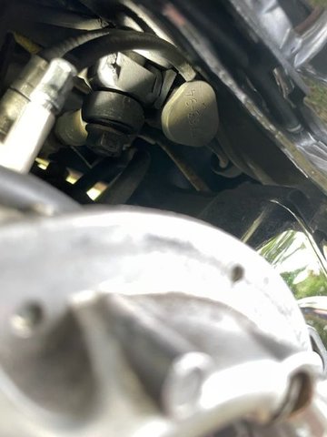

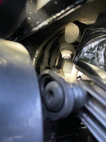

Not sure if it helps but here's a quick pic from under my tank. S&S carb and stock length cables - same bike/year.

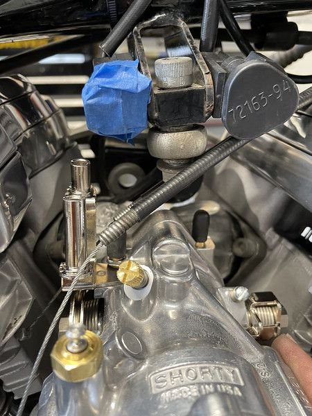

E-Carb mounted with cable throttle wires routed as suggested.
There are two capped holes. One is on the carb body, the other is on the intake manifold. S&S direction/assembly sheet only references the one on the carb body for use with VOES (which I am using). What is the purpose/reason for the other?
Still aways off from starting but a question re: jetting. Out of the box it is set up with a 70/295 (main/intermediate). I am runnning the stock exhaust system (I prefer to save what little I have left of my hearing). Nothing fancy in the motor other than the EV 27 cam with the S&S hydrauics and Andrews fully adjustable pushrods. Any feedback on how well that jetting works for those with a similar set up out of the box?
