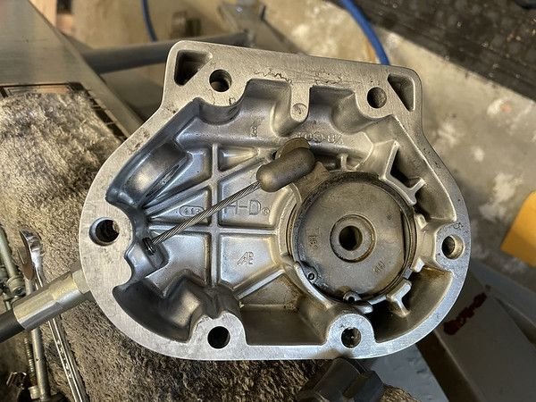

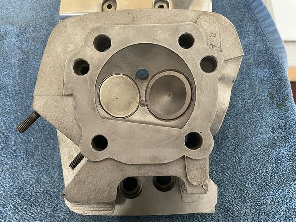

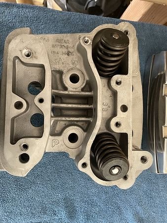

So I took the shifter cover apart to inspect it, disassembled everything, inspected and cleaned all the moving parts and then reassembled..all looked good. New gasket and clutch adjustemnt (guess we'll find out if I did it correctly when I start it, take it out and see how it shifts).

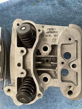

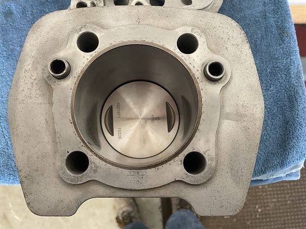

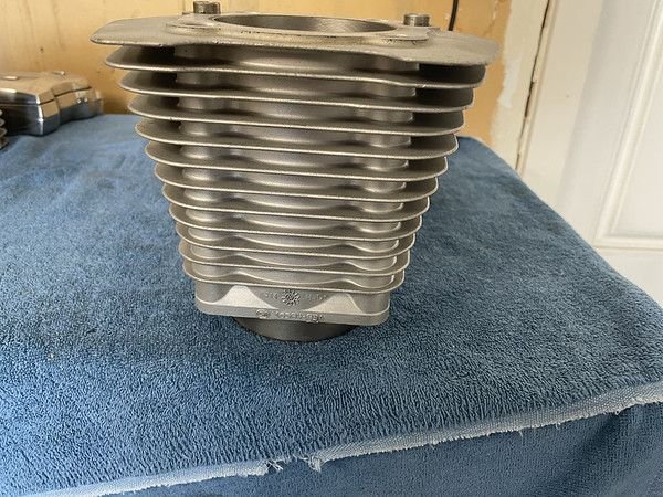

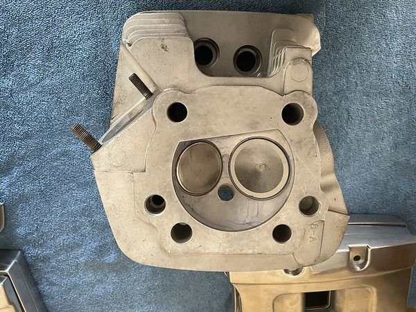

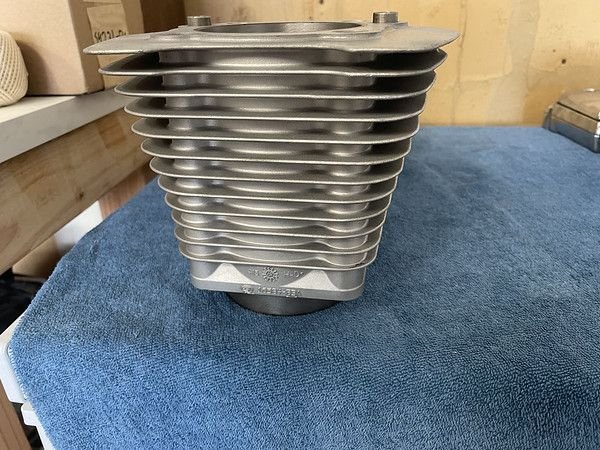

Got cylinders and heads back with 10 over Weisco forged pitons, freshened valves and new seals.
I really questioned whether I should have the parts blasted or not but there were just to scruffy for me. I imagine there will definitely be some marked differences between the current "oiriginal" finish and the "newly done media blasting, but hey it it is waht is is at this point, more of a reclamation project rather than anything else... and a good EVO low miles runner.

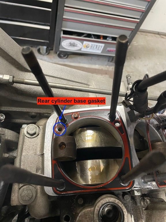

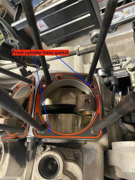

That said tomorrow I will install the front and rear cylinders and pistons. Just need to affrim that I am correct with the base gaskets.

Yes. they are one for front or rear..
Just so you know if you still have the trap door cover off, they make a 21* ramp that will give more separation to the clutch pack for better shifting and makes it easier to find neutral.

98hotrodfatboy...Thanks for the confirmation.
Too late on the trap door. Back on and buttoned down, but I am saving the info in case I need to go back in at a later time

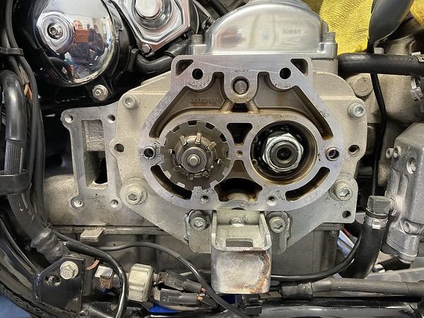

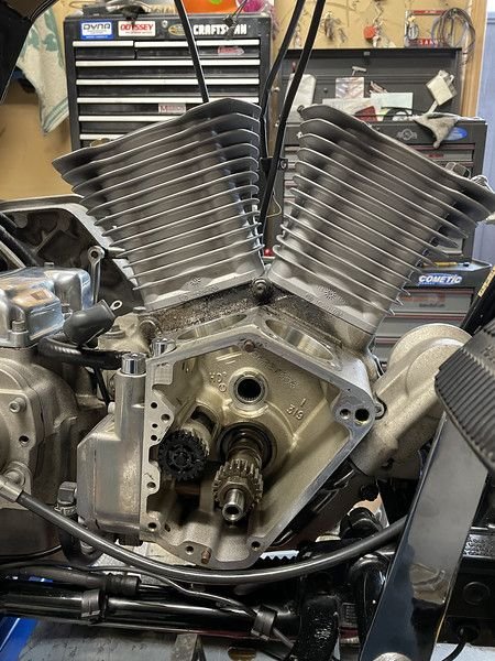

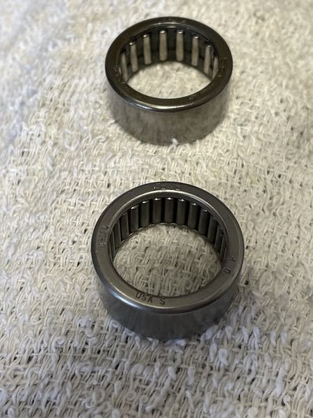

Pulled lifter blocks, removed cam cover and got cylinders back on as well as cam bearing changed out. I wonder how much money MoCo figured they saved by going cheap on the cam bearing?

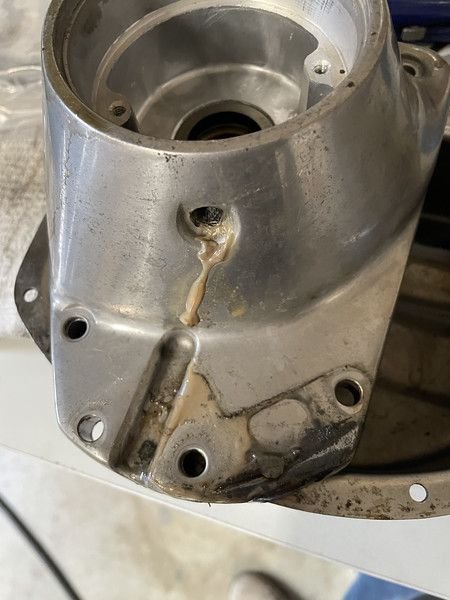

Still have to clean up the mess from the sensor melt down and install the new component
And on that note, anyone have a better solution than using Goof Off to remove the melted residue. It is also on the bottom side of the right case.
At a standstill now re: motor reassembly due to awaiting parts (top end kit, seal that goes into the cam cover for the cam), but nice to know that everyting rear of the engine is completely redone

Heat put it there, so heat should get it off.
Just be civilized with a heat gun and a wood scraper so it won't scratch the aluminum. Take your time using the heat to soften the potting compound and the wood scraper (paint stirrer) should be the ticket. . Looks like an aluminum nose cone. So if no clear coat, then go for it.
Looks like that nose cone will polish up nicely. As far as the freshly blasted cylinder heads, try taking a STAINLESS STEEL bristle brush to the fins. It will shine them right up.
