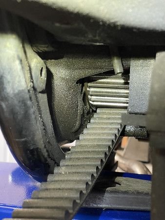

So I came out to the bike late afternoon and saw this...
There is no oil in the transmission since I just replaced the oil pan gasket and have not added any fluid.

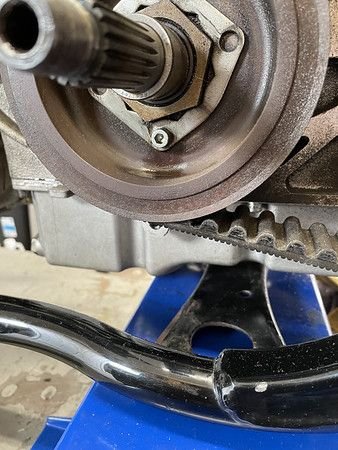

When I first put the bike on my lift I noticed a large accumulation of oil behind the inner primary and some resting on the sprocket. My inital thought was that the seal on the back of the inner primary was leaking.
And when I puuled the inner primary you can see a large amount of crud on the back.

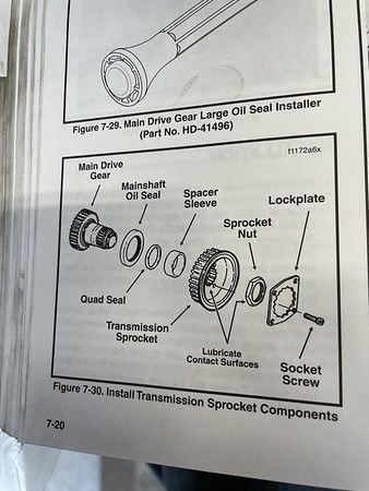

Then I got to thinking that maybe the casue is a mainnshaft oil seal problem. Looking at the manual there are two seals, a mainshat oil seal and a quad seal.
Anyone's asesement that it is mainshaft seal problem rather than the seal on the back of the inner primary?
Can you get to those seals by pulling the sprocket and bearing inner race. Can one/both be replaced with the tranny assembled or does it mean taking the box apart to replace them. (means buying a tool to pull the mainshaft inner bearing race)
I just do not want to get it all back together, get on down the road, only to find the *** end all covered in oil...again.

I always find these posts when I am about to leave for work...sorry if I am brief but yes, time to give it all the "once over", and it looks like your leaking from the 5th gear main shaft seal, but the problem is, the leaking can be from any one of 5 different seals, or more than one, so...
Your at a point where the "might as wells" make sense. It's mostly all apart so you should take advantage of that and replace all seals in there. Quad seal and spacer, spacer seal (the big one), and 5th gear main shaft seal (wedding band seal). In addition, I would seriously consider a new inner primary bearing, IPB seal, and race. New pulley nut. New shift shaft seal. Use OEM parts....your going to need some specialty tools, (an investment) but worth the expense and you can save some coin if you shop around on the tools. (race puller, deep 1-7/8 pulley nut socket). Some will also purchase a specialty seal installer but not totally needed.
Inspect parts to see if you have the upgraded pulley and spacer or the older style pulley and spacer. If old style, consider changing to newer style. Added expense will be a new front pulley.
Others will chime in with more details. Not a bad project but a little spooky if never done before, but still do-able if you take your time, read up on the project and ask questions. Gotta head to work.

YD has you covered.. Do them all at this point.. post up a pic on the ipb sleeve on the input shaft.. I wouldn't think at your mileage it would necessitate replacement....

Agree with the previous 2 posts - replace everything while in there. But I most always replace the pulley spacer and inner bearing race just for insurance of a good seal surface. The 1-7/8 deep socket, bought as the special tool, has a pilot that threads onto the input shaft and makes the pulley nut much easier to deal with. If you change the trans input shaft seal (wedding band) you'll need the special driver for that. Getting them out takes a bit of imagination, but not too difficult usually. Other than a torque wrench that does LH torque, that's about it for special tools.

Thanks for the input...and I "might as well". Well there is one bright side, I do not have to pull the case in order to diasassemble the transmission.
How do I know/how can I tell if I have the upgraded spacer and pully?
