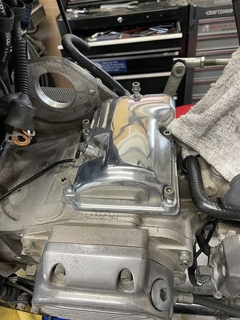

98hotrodfatboy, it will be probably 2-3 weeks for my indie to get the top end back to me (been using the same guy since the early 90s). He's the best in the Bay Area, but is up to his neck in work. He's even added a couple of extra helpers and is still backed up. This will give me the chance to clean & polish a lot of parts (the back side of the inner primary is really bad from the seal leaking). Once the seal comes in, I can get the primary back together. I get that done I'll dive into the carb when the rebuild kit arrives.
Also ordered the S&S tappets. They defintiely are not cheap, but I am keeping the bike, so I'll get out of it what I put into it. I have an EV 27 cam that has only about 50 miles on it so that will save me some bucks. Also looking at the fully adjustable pusrods (ones I do not have to pull rocker box covers). S&S adjustables have you cut down to tubes for sizing , so I want to avoid that. Andrews seems like a good choice as well. Just need to find them. Just started looking.

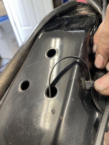

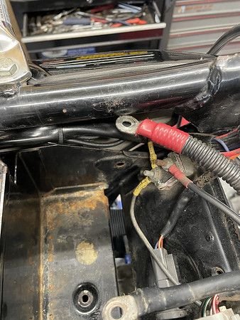

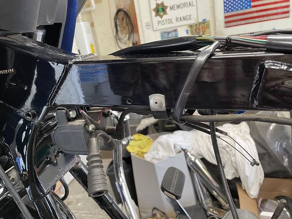

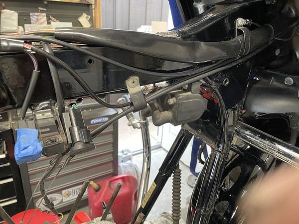

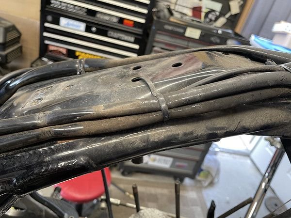

Next up on the list is changing out the 50 amp fuse. Can't say that my 65 FLH or 84 FLH would have started with these type of end connections on the starter motor and circuit breaker.
And I need help finding some zip ties. They are not the normal type. They have a nub on them end that pushes into a hole in the frame. Think there are at least four.

Might want to replace that 30a main breaker... If looks could kill!!!!!!

Those zip ties can be found at the dealership, they are not cheap but I never found them anywhere else.

Man, you know a guy is thorough when he uses the nubby zip ties instead of just zip tying it with a normal one. Good on you man!
I found some similar ones somewhere, PM your address and I'll put some in the mail for ya. I think I bought 50 to get "the deal"....lol.
