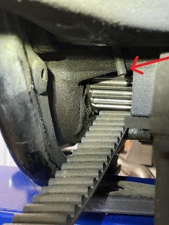

Whatever line this is shouldn't be right there
Excellent observation. It is the lower hose for the vapor line running off the gas tank. Book says it is vented to the atmosphere. I will definitely relocate it to a differerent position.
Are you sure that is not the optional "Belt Lubricator"?
Gas may lubricate a little, but it's probably a belt cleaner, belt and pulley look's clean to me.
