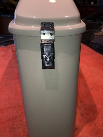

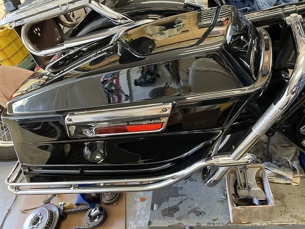

So today was spent cleaning and polishing saddlebags and the fuel tank. Slow, repetitive, tedious work going thru three different polishes. Separated the lids from the bags to make the work easier and more complete.
At the end of the day the finished parts are probably a 7-7.5 on a scale of 10. Some pitting and scratches that will never come out. I do have to say that I do not think I will need to use bungee cords to secure the lids to the bags. They are definitely a step up from the locking mechanism on my 65 FLH.
Not sure how you get these kind of scratches on the side of a fuel tank. I guess/I suppose some type of metal contact, maybe from some type of a zipper?

"Not sure how you get these kind of scratches on the side of a fuel tank. I guess/I suppose some type of metal contact, maybe from some type of a zipper?"
My scratches in that area are from my watch when raising the enrichener on the carb with my left hand. It took me a long time to figure it out.

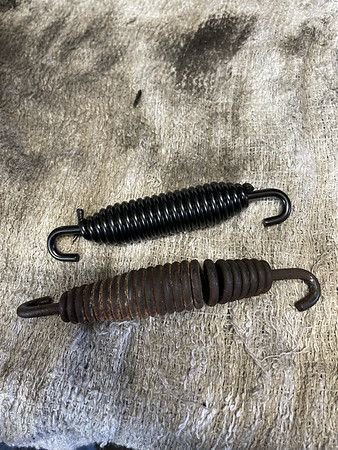

Got the jiffey stand back on after some serious cleaning. Needed a new spring. Have to say that looking at the old one I seriously wonder how the old one got so 'fd up.

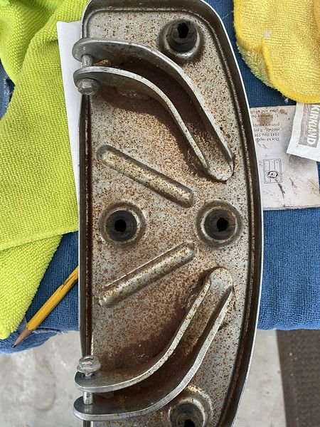

Hard to think one could spend just about entire day making rocker box covers presentable. Started with wet sanding 400 grit, then 600, then 800, then 1500, then a buffing wheel to a final hand polish using Mothers Aluminum Polish.
Not sure what everyone uses to remove rust on parts, but I have been using this stuff for years. Not cheap but definitely does the job. Non toxic and boidegradeable as well

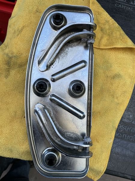

Before and after (about 8 hours) on left footboard.

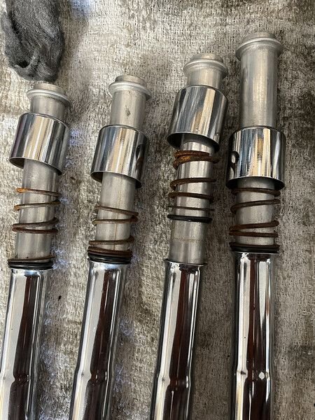

Definitely going to need new spacers and springs on pushrod tubes, in addition to new rubber. Just do not want to take the chance that the rust on the springs could weaken them, causing them to fail and I end up with leaky pushrods at the base. (Pic actually makes them look better than they are.)

Those floorboards really came out nice...
