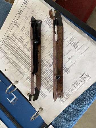

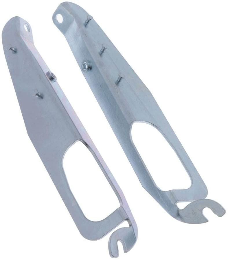

It's usually no problem to use the brackets with 6.5 speakers and adaptors, edit, and didn't know there was also after market ones available,,

Looks like the speaker cut out's are larger on the new brackets, probably why the old brackets didn't fit with the 6.5's

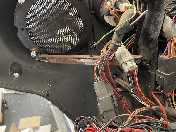

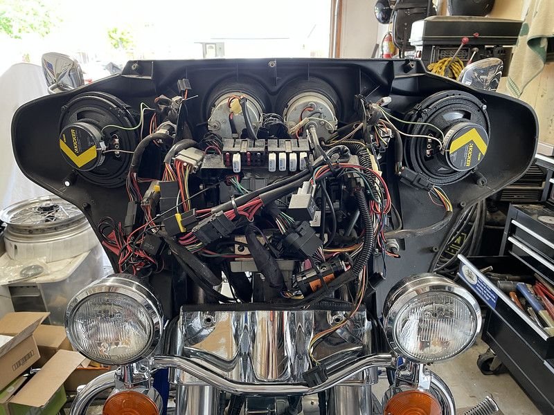

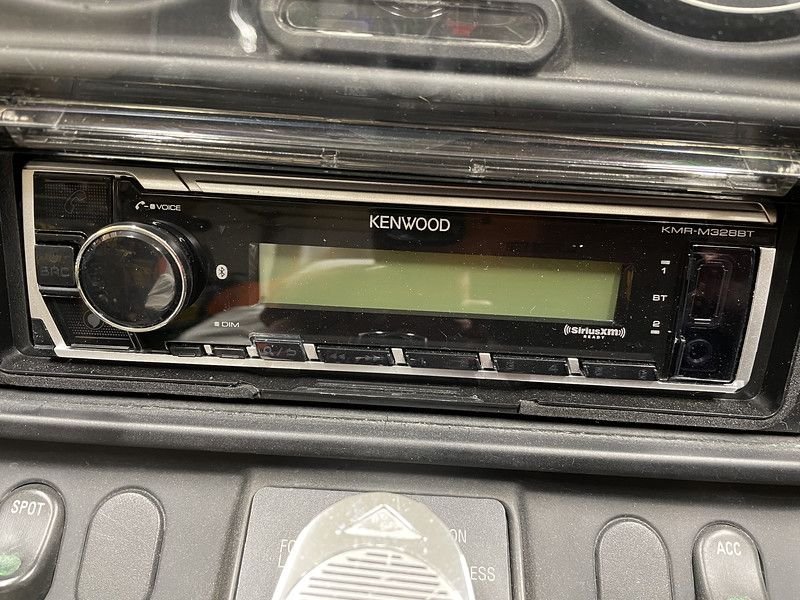

Horizontal support brackets were included when the last owner sold me the bike (thank you Jim). Just did not know what they were. Once I pulled the oversize speakers, I figured out how they mount. Have some 4-1/4 speakers coming. And once they are in position I can get the connectors properly attached as well
And....I replaced the 1 amp fuse and now have power. Downoladed the owner's manual for the radio. Hopefully I can figure it out.
If those fairing support brackets are anything like the ones on my 04 Electra Glide you better stock up and get used to pulling that fairing off. I swear I must've gone through about 6 of them in 8 years.

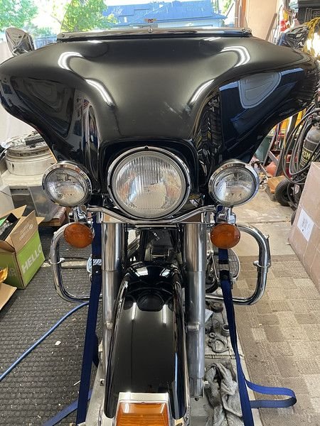

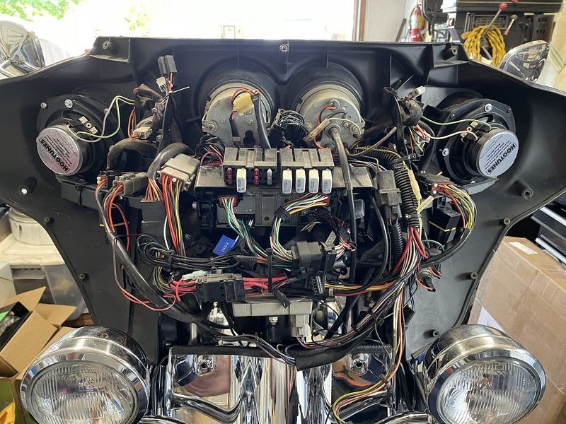

"Clean up on aisle 5" (before and after). The horizontal brackets make a huge difference as far support as well as how the wiring is laid out.
Got the fairing cleaned up, along with the headlight assembly, passing lamps, front forks and chrome lower fork cover. Finally reassembled and it actually looks like a motorcycle again.
