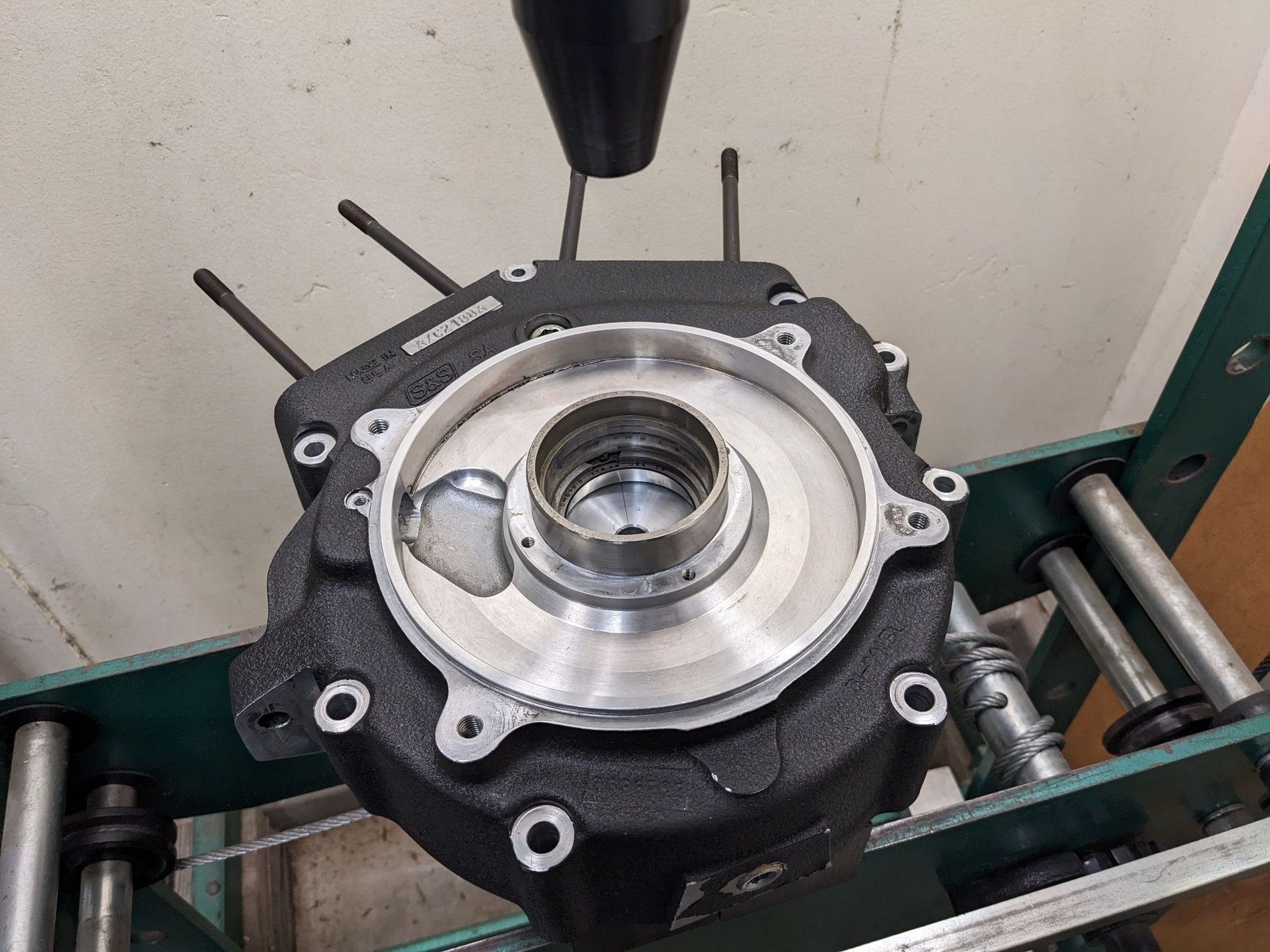

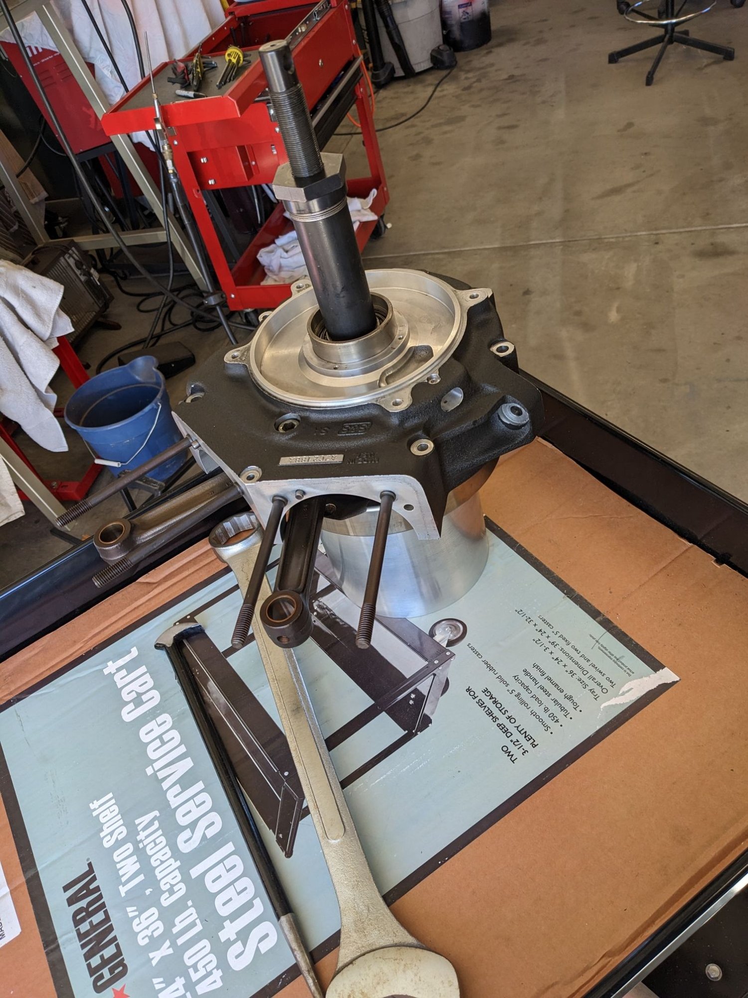

Made a new race installer also.. Bearing fit was a little loose, only about 3/4 though interference so I used Loctite 620. I wanted to remove the outer bearing spacer to clean things and apply a little of the 620 to it so it won't turn if the bearings do.. I use the slightest bit on the races then left the case in the press overnight with 1 ton pressure on the race.. The hydraulics did leak down to 1/2 ton overnight..

Ok that's trick, I usually tap the spacer ring around till I can push a punch down the oil port to dislodge it. Been a wrestling match a time or two

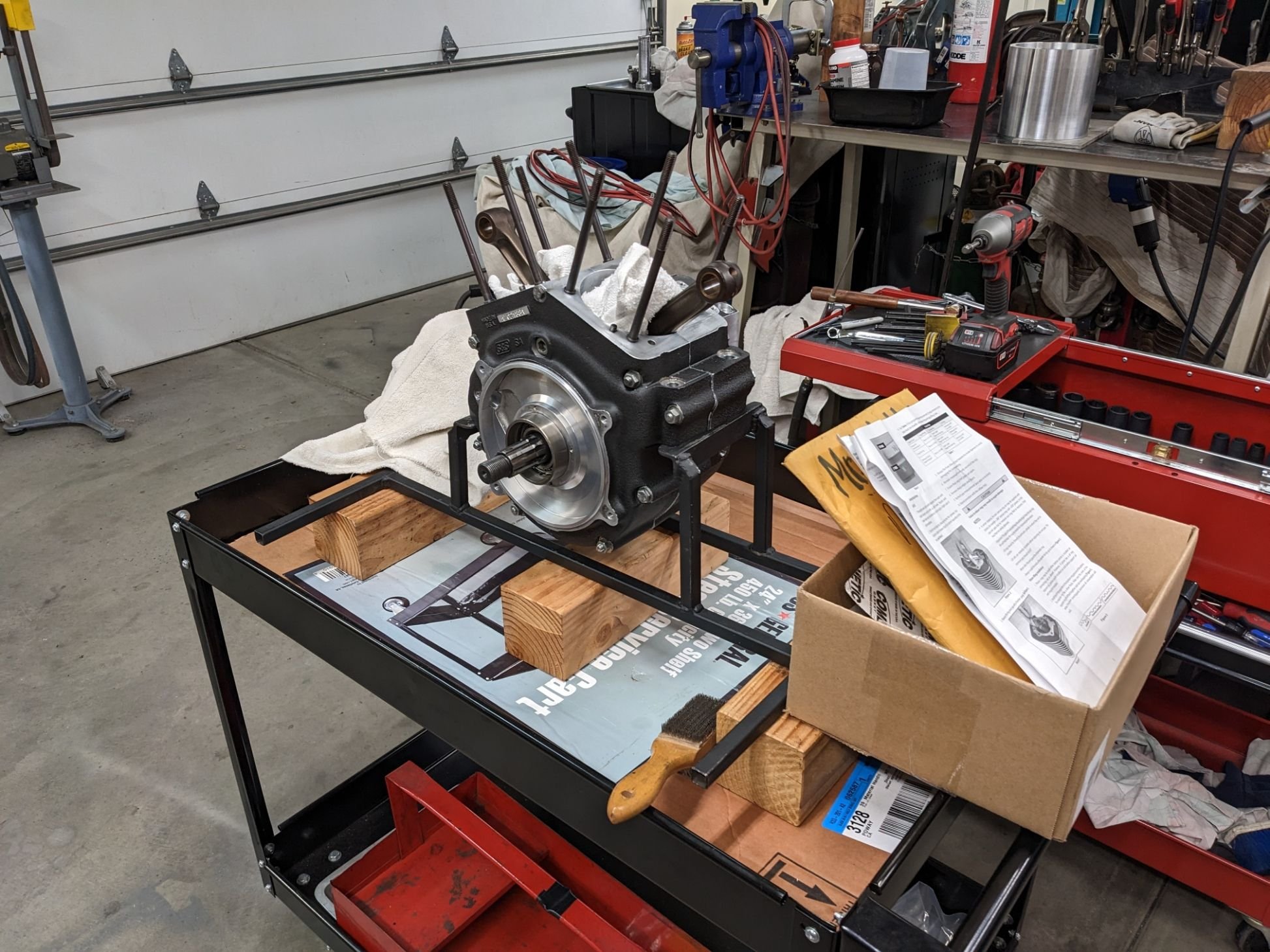

I caught a cold that has been kicking my *** for the last couple weeks.. Finally coming out of it. Here are some pics I did a while ago..

Oh no I got the seal in backwards.. Actually I didn't... No gaskets pistons above cylinders by 0.030.. 0.045 head gasket and 0.020 base gets me close to 0.030 when they compress..

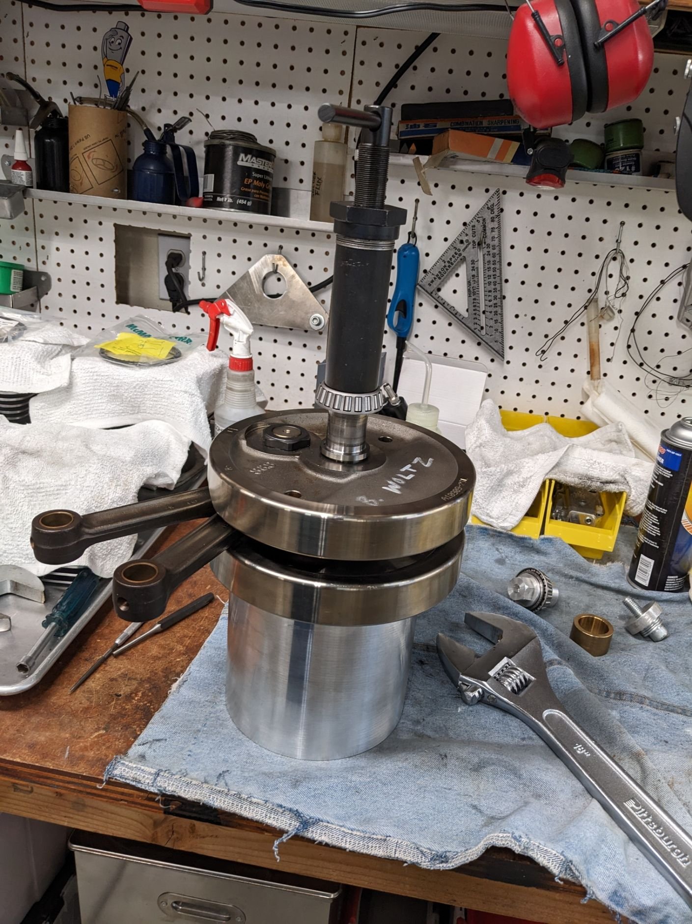

Little tip for the crank bearings next time, I use a hotplate to heat them up, they just drop on after that.

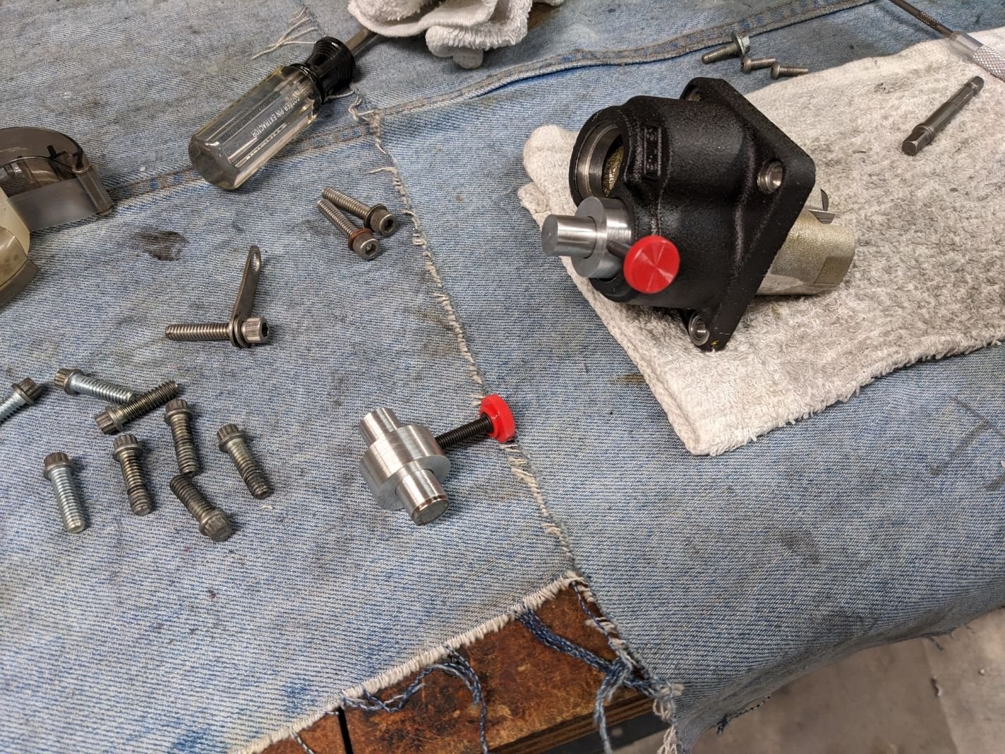

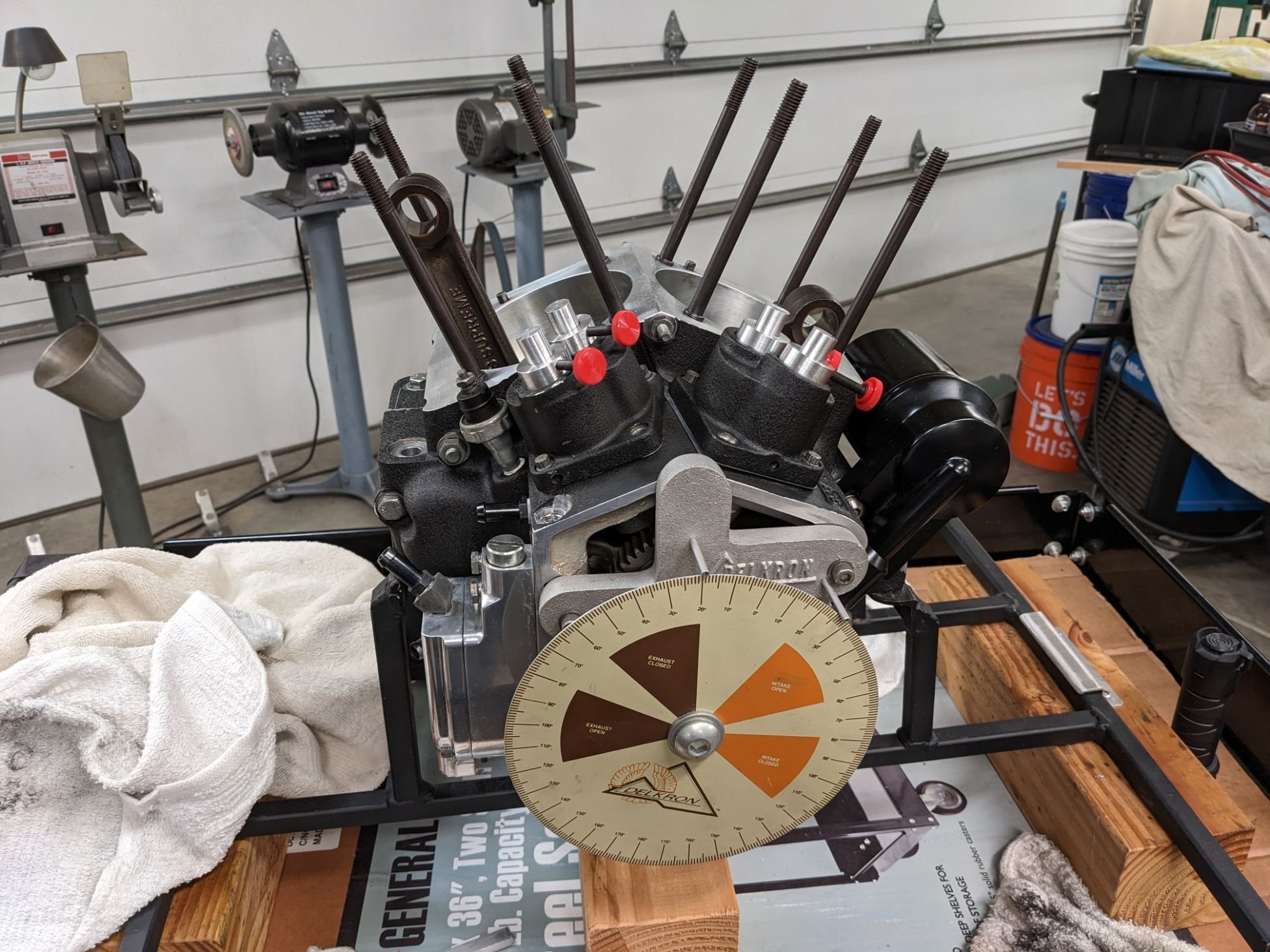

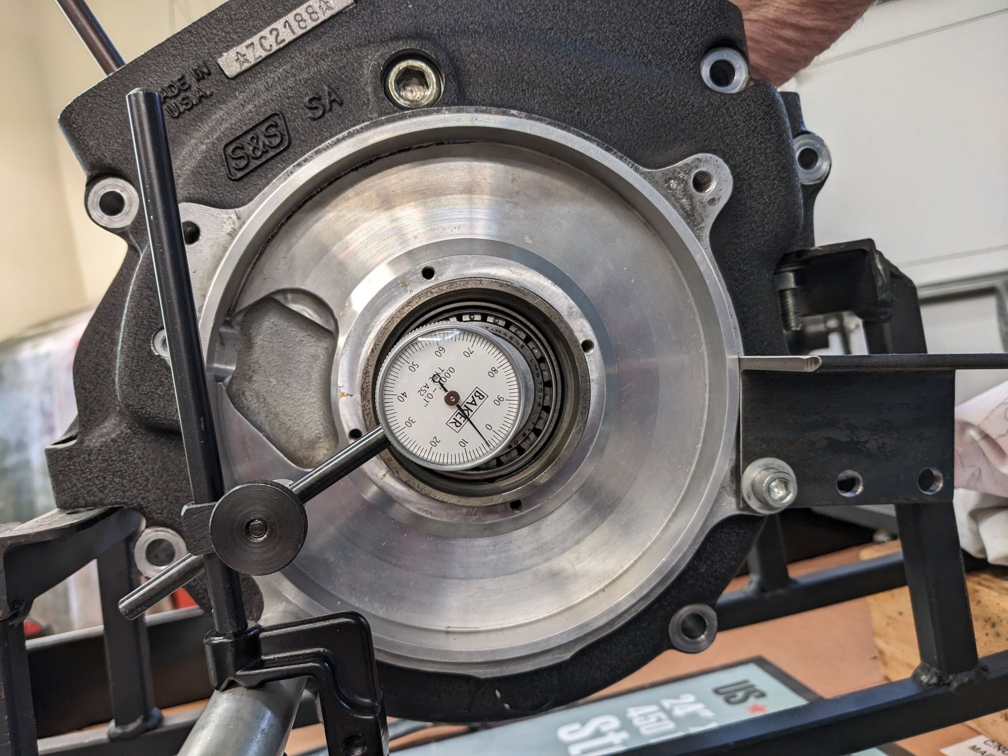

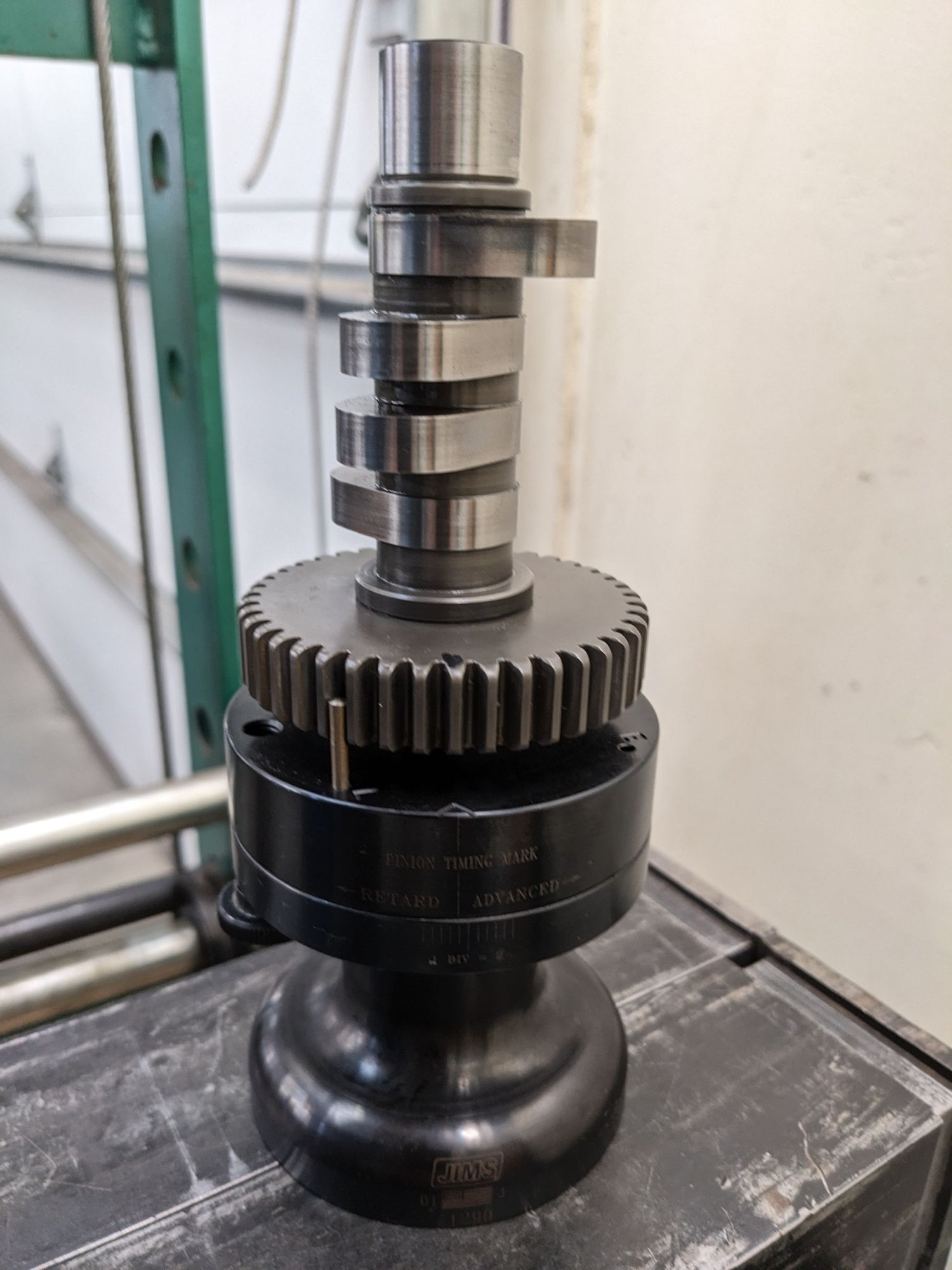

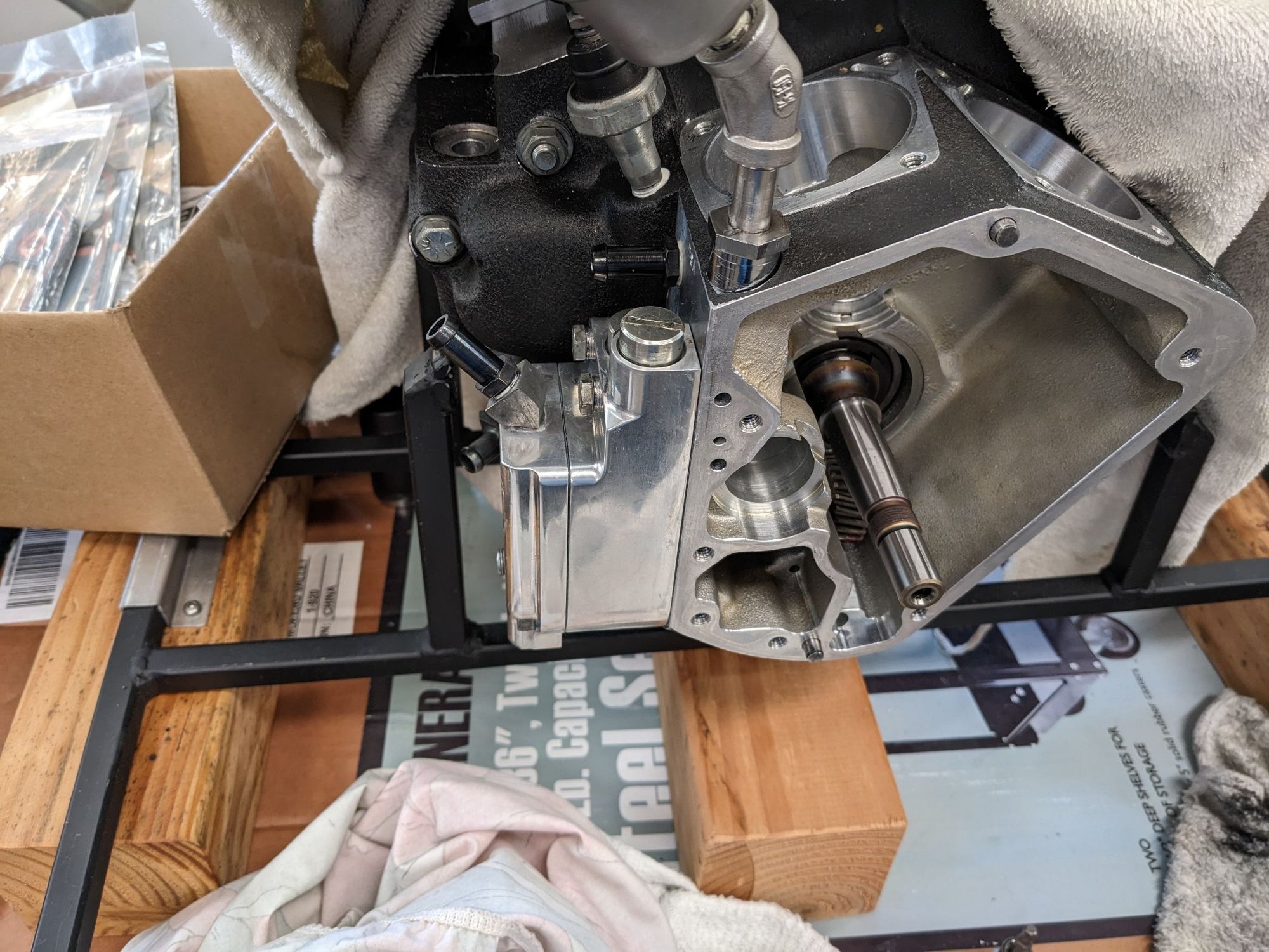

More work.. Cam chest.. Assembled oil pump.. Checked cam timing. I had actually screwed up the cam advance when I swapped out the 631 for the 640. I wanted it advanced 3 degrees but advanced it 5.. At the time I didn't recheck.. I backed it off and it's now advanced 2.5 degrees. I also made lifter holders..

Timing the cam..
