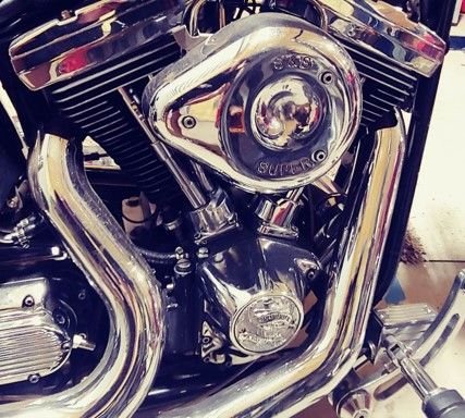

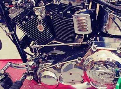

Thanks for the reply pgreer. So I've taken snippets of photographs showing the Cam cover side of S&S, Revtech and Ultima which are clearly different from Harley. These pics may not all be of evo replacements but it does show their style cam cover. Interesting that the Custom cam cover most closely resembles the Harley cover of all of them. Now, I have heard that the patents Harley has on the evo were not very strong or complete which supposedly made copying engine features/parts quite easy. I'm no expert so don't quote me on that, but that is what I saw in my research.
Just comparing the cam covers of all 5 engines here the most similar to harley is the engine in the custom bike.
S&S .................................................. .................................................. ........................... RevTech........................................... ...
Ultima .................................................. .................................................. ......................... Harley...................................
Custom Bike engine
The pic on the left is interesting. It appears to have a heat shield... between the case and jugs ? ? ?
Does anyone know of any other manufacturers of aftermarket "crate" non-harly replacement motor besides these.

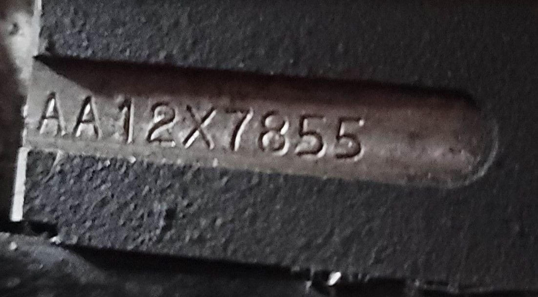

Bottom pic is special build tag on the frame..... and above engine number on front (forward side) engine cases. Stamped twice - one on each case half.
I'm lost. I can't figure out who made this friggen engine! big bummer. The number comes up no where on the web. crazy If anyone wants a Sherlock challenge, I challenge you to find out who made this engine.

The assigned VIN tag means not a Harley frame, or some other likewise issue. The number stamped on both sides of the front of the case means not Harley cases. So, not a Harley-Davidson crate Evo motor. Not necessarily bad, but know what you're buying.

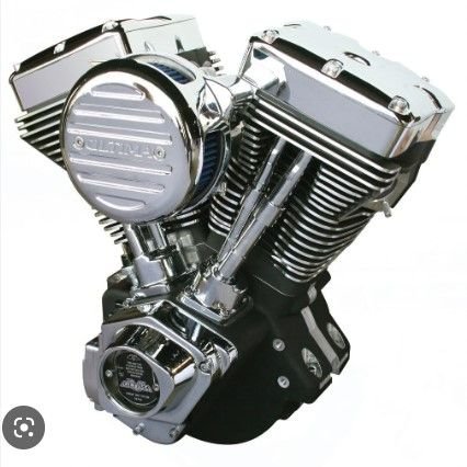

S&S gave me the answer immediately. They said the motor is an Ultima. Anyone know what kind of quality Ultima built motors have? ?
