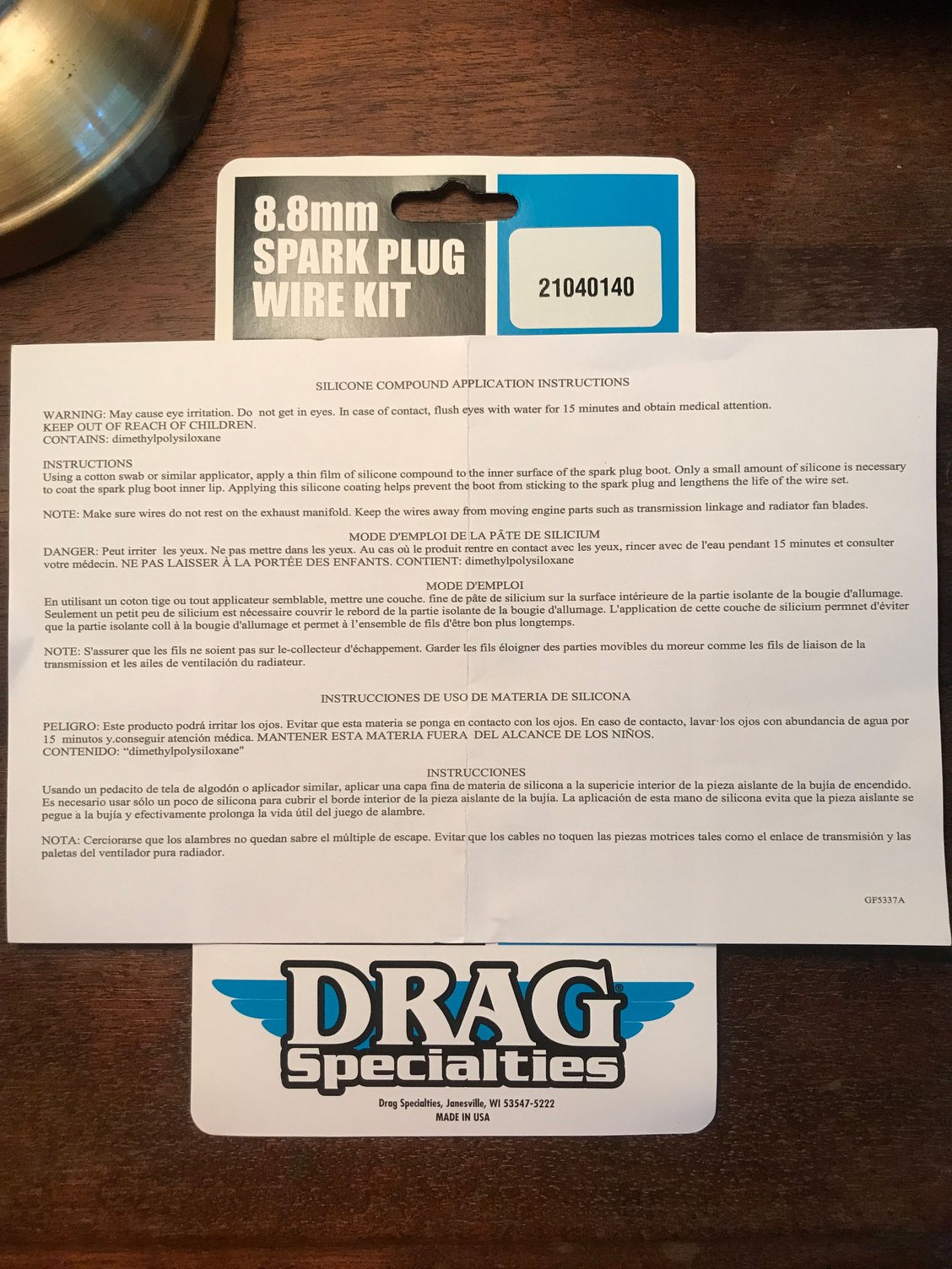

Alright, well, I replaced the spark plugs and wires and the bike has never run better! Man, it's so nice to have the old evo purring like a kitten. The spark plugs were good, but I replaced them anyway and put them away for future use, if necessary. I went cheap with like some 30 yr old (new) Champion RN12YC's from eBay, and they are excellent.
The old, smaller spark plug wire's resistance was 5.8k ohms, while the new one from Drag Specialties is 1.8k. That's a big difference. The older long wire was 7.1k ohms, and the new one is 4.3k. No wonder the spark seemed weak. The Drag Specialties wires are a good 1/3 thicker in diameter than the factory wires were, so I'm definitely happy with the purchase.
One thing I found is that someone absolutely gobbed dielectric grease into the wires that sat in the ignition coil. The metal ends were literally filled with it. Seeing this, I had thought dielectric grease is a conductor of electricity, but as most of you already know, it is not. It's supposed to be used sparingly on the inside and lip of the wire boots. Anyway, thanks for the help.

The amount of dielectric grease is not going to make any difference in anything.. Somebody just wanted to be careful that's all... Doesn't hurt a thing.. But not knowing the difference in to much resistance will..
