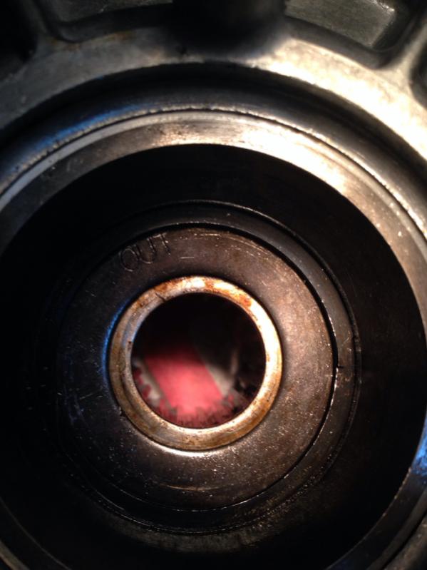

Question since I'm not apart yet. I was looking at outer hubs and found one listed on eBay as matching my part number for a 98. This one has a retaining ring inside hat I don't show on the parts lookup. If there's a retaining ring it wouldn't be able to move like mine appears to have. Is this an update on later years?
Edit. **** think I messed it up. I pulled this internal ring off the other day, I don't know if the one I bought is even it. I can't find it listed anywhere. I was pulling it apart didn't realize this wasn't the one to remove. Damn it.

They all have that snap ring. If there wasn't a retainer of some type there the bearing and inner hubs would walk out of the outer hub. In term over a short amount of time it would press it's self apart.
. I messed up. Edited my last post. I can't find a listing for that ring. The one I ordered looks just like it or I thought

Oh boy, you can have fun getting that sucker back in! Unless you do it like I do....get a bolt and washers, put the bolt through all the springy parts and clamp it all up tight to flatten the spring discs.....insert, fit clip, remove bolt.
There isn't a part number because you are not supposed to remove it...

So my inner hub is shot? I can't get the ring to go back into the groove all the way. It's flat down there but won't go in.
