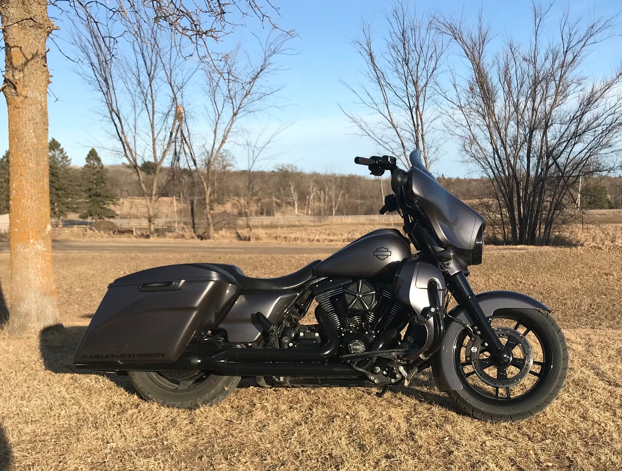

I used stock lowers with a RWD fender on mine. Picked up fender and cans off eBay. 2014 flhxs.
WOW.
Very good looking bike.
I just pick this up 2 months back and blacked it out.
Old Apr 10, 2021 | 08:40 AM
InthewindMN's Avatar
InthewindMN
Joined: Jan 2014
Posts: 2,482
Likes: 239
From: Minnesota
Originally Posted by nach73
WOW.
thanks. I got rid of all my chrome.

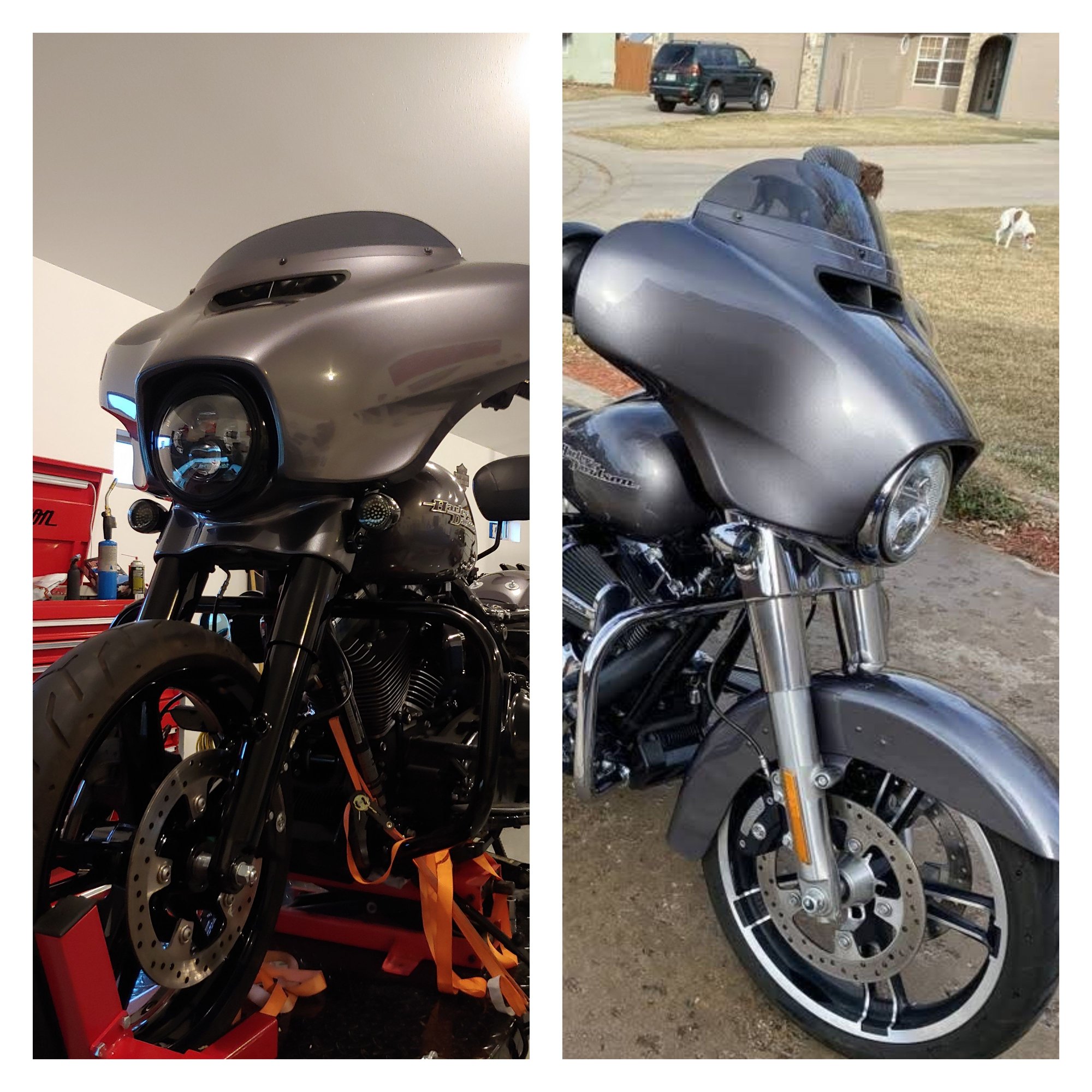

Yep just did the native ez kit on my 18 RG. Did legend cartridges and drop fairing kit too.
