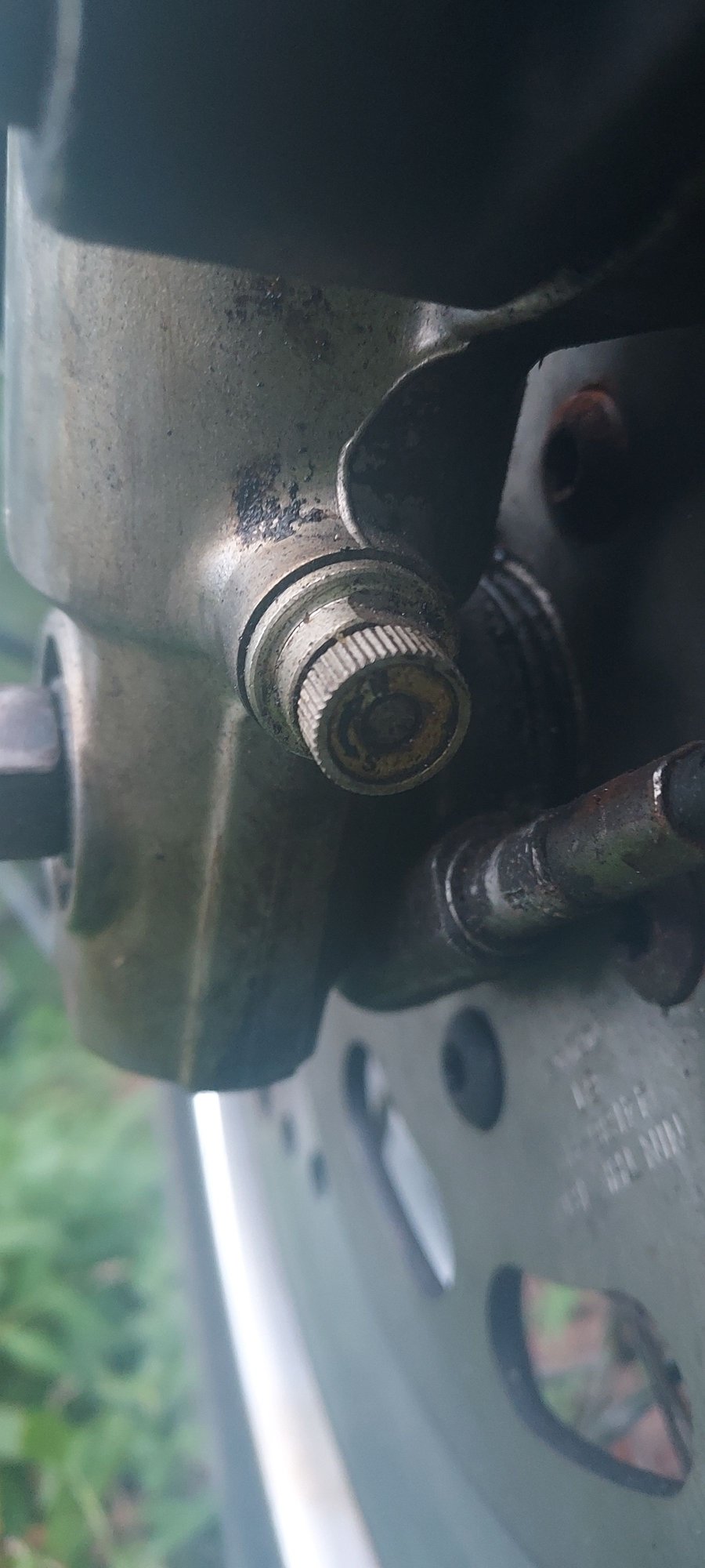

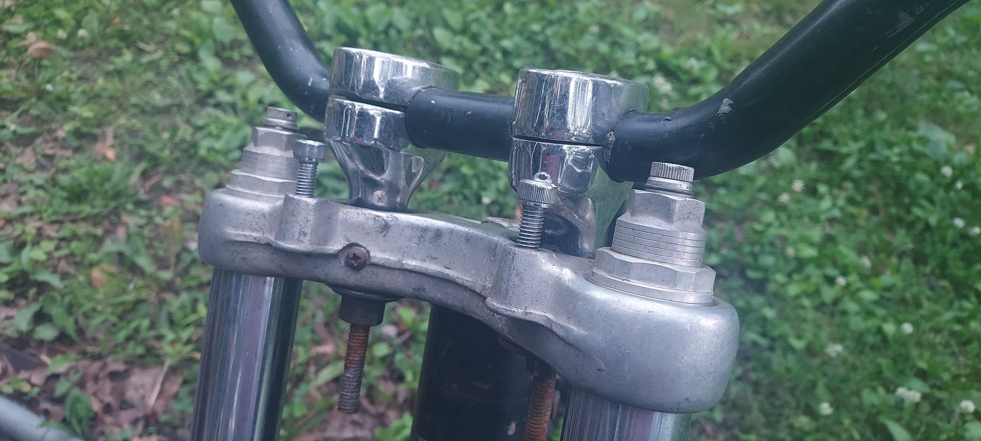

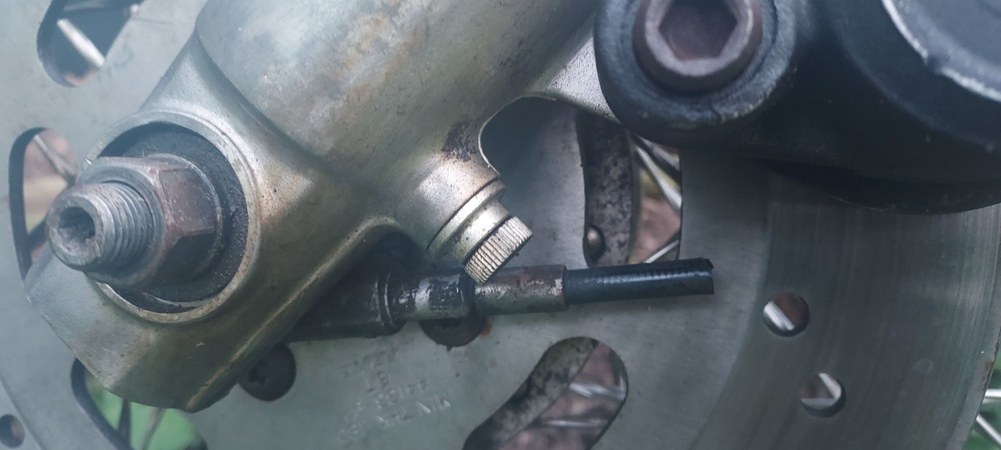

Default Can anyone ID these forks please?
Best I can tell (I found a pair on Ebay that match) these are FXR forks, but I really don't have a clue.
They came on a basket case '91 883 sportster that I bought for a chopper project.
I bought the bike mostly sight unseen for $200 & i was expecting regular, non adjustable, 39mm forks.
I want to lower the front end by 3 or 4", but I'm loathe to start ripping into these if they're something a bit more special/better/valuable/collectable.
Other than some yellowing to the lacquer & a couple of god awful, gaudy emblems glued to them, they're in great condition.
If they are FXR forks, could anyone tell me if they're built like regular forks (separate spring & damper rod) or are they a 'cartridge' style?

Those are cartridge type forks. They were offered on the 1200 S Sportster and FXDX Dyna models. They are nothing but you want to cut up or chop.

^ What he said. Showa cartridge forks with adjustable preload, rebound and compression damping. Those are probably worth some money to anyone looking for an upgrade to their standard non-adjustable forks. I had a 2000 FXDX and those forks worked great

As mentioned, Harley/Showa compression/rebound adjustable forks. Never on a FXR and that particular set came from a 1200S sportster
Yes, they would be considered "Special" ... you got a good deal on your $200 basket case
