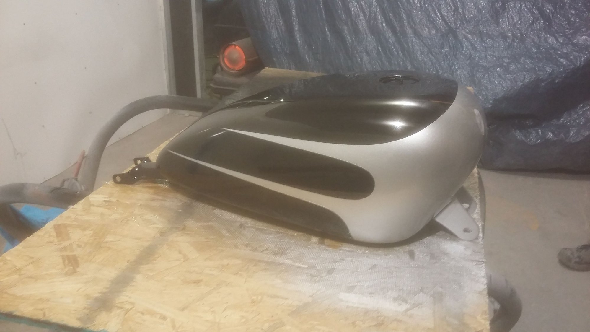

So I just left the shop and I'll be picking up my tank tomorrow. I'll have better pics in next few days.
Pics dont do justice. I did not line it...just pressure checked.

Looks good.
